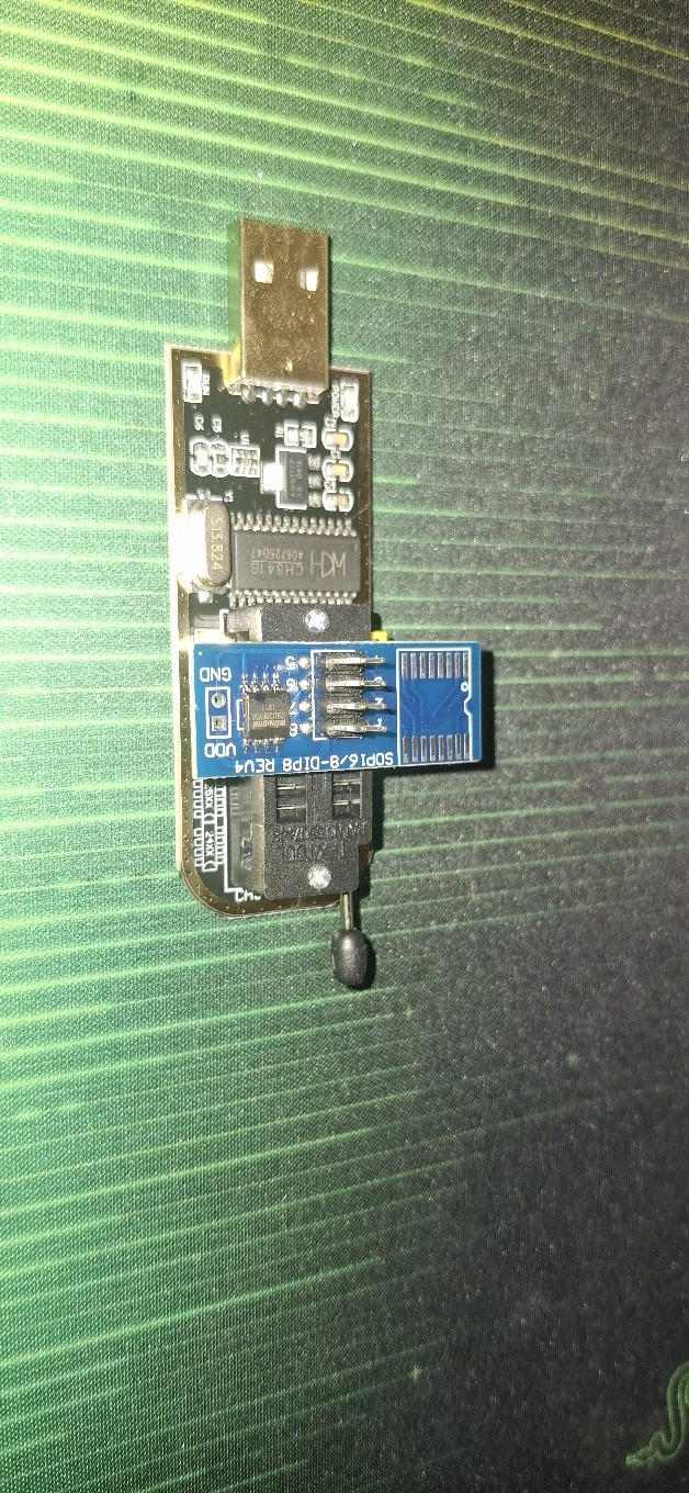

                  #168
                  Good afternoon, I managed to read the bios, help me find out the password.
                  • peste
                    • Dec 2016
                    • 12652
                    • ROMANIA
                    #169
                    The bios you posted is 1MB, the bios should be 16MB, find another bios chip and post the content..
                    • Skif_panda
                      • Feb 2025
                      • 10
                      • Argentina
                      #170
                      I'm sorry, he was far away and I didn't notice him.

                        • peste
                          • Dec 2016
                          • 12652
                          • ROMANIA
                          #172
                          The bios chip must be unsoldered from the board before writing or reading..
                          do not use the clip, you may have errors..if you do not have anything to unsolder it with,
                          solder wires between the programmer and the bios chip..
                          here is a video for example..https://www.youtube.com/watch?v=DWWi...l=ThisIsHow​
                          • Skif_panda
                            • Feb 2025
                            • 10
                            • Argentina
                            #173
                            Originally posted by hoaca388
                            Fle is corrupted , read chip again.
                            I read the flash drive again, but when checking it, it gives an error (when comparing the chip, it does not match the buffer)
                            • Skif_panda
                              • Feb 2025
                              • 10
                              • Argentina
                              #174
                              I soldered it and read it.

                                • Skif_panda
                                  • Feb 2025
                                  • 10
                                  • Argentina
                                  #176
                                  here is a video for example..https://www.youtube.com/watch?v=DWWi...nnel=ThisIsHow
                                  Is there any file corruption now?​
                                  I re-read the bios by soldering it to the programmer

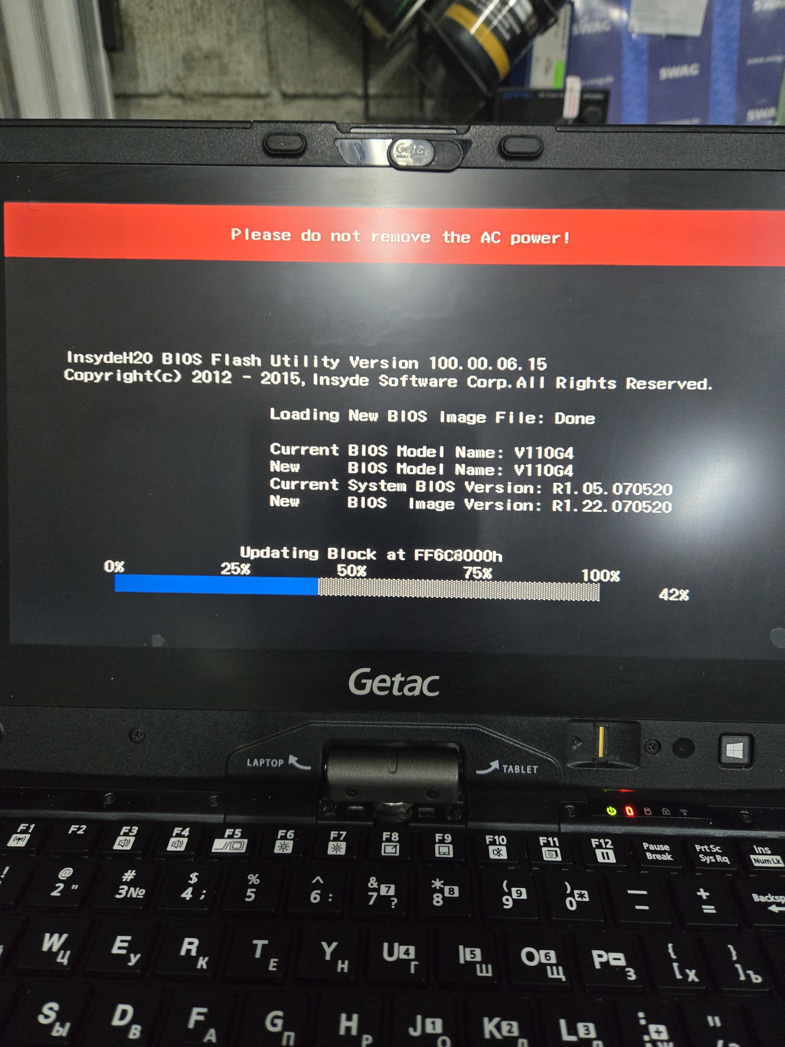

                                      #178
                                      Hello everyone, I need help, Getac v110 g4 at the beginning there was Bios r1.05 accidentally updated to R1.22 the backlight on the laptop disappeared, I can't return it back. I bought a donor with R1.05 changed the chip but the laptop does not turn on, thanks in advance for your help
