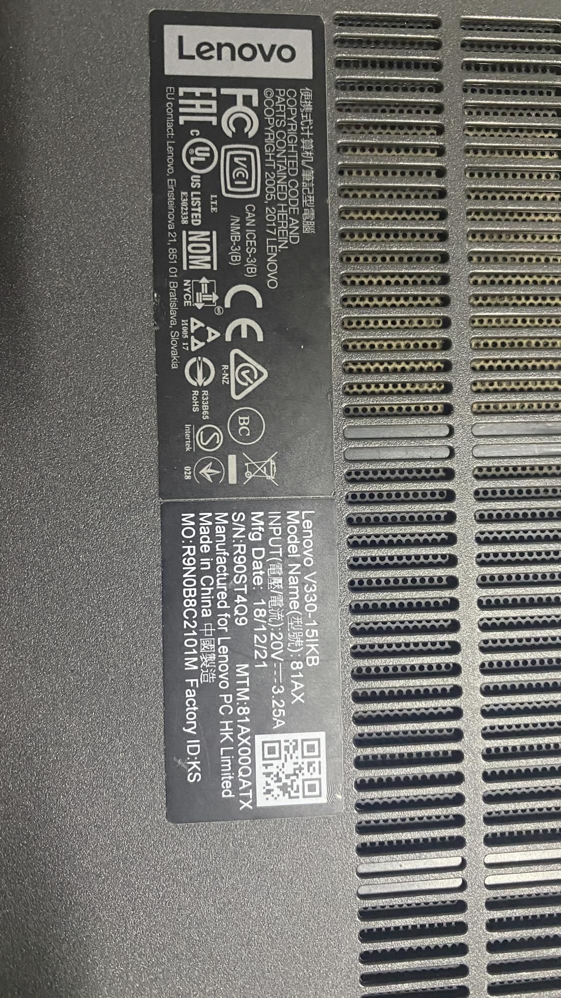

    Lenovo bios V330-15IKB
    my english is very bad so sorry how can i fix my bios error
    thank you in advance does not see the graphics card at all maybe it will fix after editing

    Re: Lenovo v330-15ikb bios ix help me
    : sevinmek:: sevinmek:
    try..
      Originally posted by peste
      try..
      Thank you, I will inform you after trying: sevinmek:
      • fransuzadam
        • Oct 2018
        • 12
        • Turkey
        no change, unfortunately, same
                        try..
                        this file actually works, thanks!
