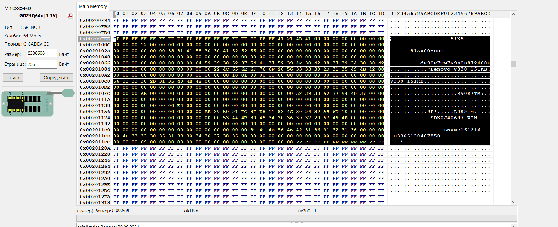

    Originally posted by peste
    DMI 201000 - 2011FF
    Please excuse my ignorance. You can go into a little more detail. I took it from the old firmware (screenshot) this is the part that I inserted into the firmware from post#31.​ but the serial and MTM did not appear.
    • Sergey Buldakov
      • Dec 2024
      • 5
      • saint-petersburg
      #102
      DMI 201000 - 2011FF
      Thank you. Everything worked out.
