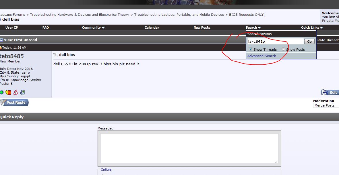

          dell E5570 la-c841p bios
          dell E5570 la-c841p rev:3 bios bin plz need it
            • 22436
            Re: dell bios
            Use the forum search ,there`s a few working bios already posted .
