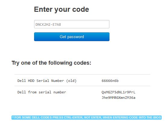

                                    #37
                                    Re: Dell Latitude E5470 LA-C841P
                                    Originally posted by SMDFlea
                                    Use the forum search ,there`s a few working bios already posted .
                                    need help pls
                                    i have my dell bios locked with password and need to unlock it
                                    service tag: DNCK2H2-E7A8
                                      • 21932
                                      #38
                                      Originally posted by jougounou
                                      need help pls
                                      See the link at the post above yours, go there ,enter the service tag and suffix.Use a US qwerty keyboard to enter the code.
                                      https://www.badcaps.net/forum/showpo...42&postcount=4
                                      • jougounou
                                        • Jul 2014
                                        • 185
                                        • niger
                                        #39
                                        Originally posted by smdflea
                                        see the link at the post above yours, go there ,enter the service tag and suffix.use a us qwerty keyboard to enter the code.
                                        there is no suffix for this laptop on that site
                                          • 21932
