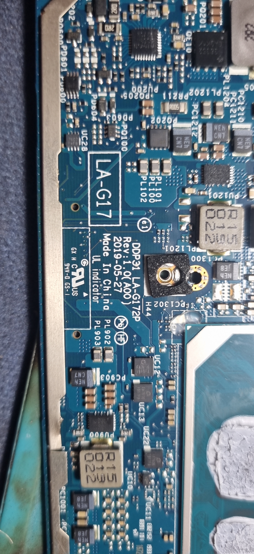

                              • francisew
                                • Aug 2025
                                • 10
                                #115
                                Model: Dell XPS 13 7390 2-in-1
                                Dell XPS 13 7390 2-in-1 13" Intel Core i7 - motherboard : DDP31 LA-G172P rev1.0 (A00) 2019-05-27, vendor: GCE, made in China
                                Service Tag: DPR71Z2
                                Express Service Code: 29855503550
                                Motherboard serial number: DP/N OV2CCD CN-OV2CCD-CMK00-99J-0118-A00
                                BIOS download attached: winbond_25q256jveq-xps13_2-in-1_7390.zip
                                Problem/symptoms:
                                Laptop now shows Dell logo briefly when plugged into usb C power supply, or when power key is pressed with battery connected. New battery was installed. After a few seconds (<5), the laptop shuts down. It does not respond to any keys (like control-escape, F2, F12, etc). It does not show any message text about pressing keys to enter bios settings.
                                Using a multimeter, I followed the power on sequence, and saw all relevant rails *very* briefly have voltage before it shuts off. Using IR camera, no parts get particuarly warm (<~25 degC) when it is powered up.
                                I believe the bios may be corrupt. I downloaded 2 copies of the bios and they match (using HxD). I can see english error message text near the end, so it looks like a good download.
                                Please note that this Dell laptop has been a disaster for years. They swapped it a couple of times, including first the mainboard, and later the whole system. They also swapped the bottom panel. I haven't had a service tag sticker since the computer swap, but I pulled the service tag information from the Dell web site. I hope it matches the BIOS. I called Dell for help, and they said send the laptop in and they will repair it. I pointed out that I need the data. They said make sure to back the data up before sending the laptop in, because they won't promise to send my original hardware back if they can't get it working. I pointed out that I can't back up the data if the system won't boot. They suggested taking it to a local computer repair shop. I tried some local places, but they all said that they don't know how to help. I REALLY appreciate this forum, and the awesome people who provide this useful information & help!!!
                                At this point my main goal is to recover data from my old laptop, which seems impossible unless I can somehow get this system to power on. I have considered hiring an electronics repair service to transplant the eMMC BG4 chip from my Dell mainboard to the NVMe variant of the same chip. Has anyone tried this? I don't know if soldering temperatures might cause the data to be lost anyways. Unfortunately, I cannot find datasheets for the Toshiba SSD/eMMC.
                                Other notes (for other people who might be looking into this model!):
                                At first I didn't understand how to remove the black heat-shield that has the fans attached. After the screws (mostly on the underside of the board) are removed, it can be gently pried away from the mainboard. There is a metal rail soldered to the PCB, and the heat-shield is pressed onto it (no adhesive, solder, etc).
                                Model details:
                                https://www.badcaps.net/forum/specif...rade-or-repair
                                Board files:
                                https://www.badcaps.net/forum/troubl...quest?t=106805
                                Actual bios chip: Winbond 25Q256JVEQ labeled as component UH8. AsProgrammer recognizes it as W25Q256FV.
                                Bios chip location: looking at the motherboard from the bottom of the system, with the fans along the top and the battery at bottom, the bios chip is located between the black shield and right side fan. It is close to the ribbon cable for the middleboard.
                                xps13 2-in-1 7390 mainboard bios chip location UH8 (w25q256jveq)
                                I was able to download the bios using a black CH341A programmer (with the modification to 3.3V), using a 6*8mm WSON8 pogo pin Probe tool I bought from amazon: https://www.amazon.com/dp/B0CJQ8KQK2. Note that the CH341A driver requires the parallel port version of the CH341 driver (https://www.wch-ic.com/downloads/CH341PAR_ZIP.html).
                                Actual SSD chip:
                                Toshiba KBG40ZPZ512G (BG4 series eMMC, 512GB) / now Kioxia. This 512GB SSD is a BGA part directly attached to the motherboard, not an NVMe drive. I think the same chip is likely used in the NVMe variant (KBG40ZNS512G): https://www.amazon.com/Kioxia-KBG40Z.../dp/B0B9NTRGGF
                                This specification for the DELL XPS 7390 2-in-1 Hybrid (2-in-1) can be useful for upgrading or repairing a laptop that is not working. As a community we are working through our specifications to add valuable data like the 7390 2-in-1 boardview and 7390 2-in-1 schematic. Our users have donated over 1 million documents which are
                                Last edited by francisew; 09-04-2025, 08:27 PM. Reason: corrected the linked bios dump file name (I added both download copies).

                                  • Markus1741
                                    • Sep 2020
                                    • 889
                                    • N/A
                                    #117
                                    Hello you can try this new file from version 1.35.0 but I wouldn't make too much hopes that the Dell XPS usually doesn't want to start with newly created BIOS files.
                                    I don't know why this is.
                                    Still, good luck maybe someone else knows how to repair it.
                                    • francisew
                                      • Aug 2025
                                      • 10
                                      #118
                                      Thanks Markus, I can confirm, I tried with the latest bios image you shared. Unfortunately, as you predicted I'm still seeing the same behavior (powering back down after ~5 seconds, never showing any options to enter the bios). Now I'm really not sure what to try next...
