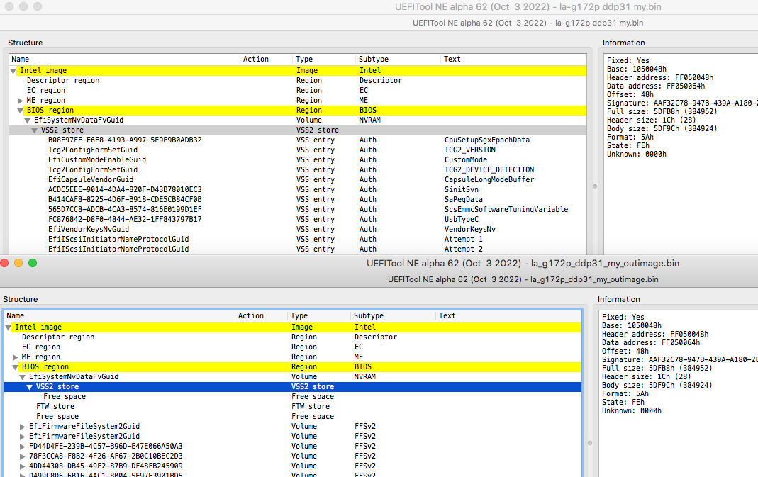

    YOU put it in manufacturing mode when you replaced Bios_Region, so VSS2 store is EMPTY and POST doesn't detect ServiceTag. DMI and win key are there, you have to know where to look, i'll give you a hint ...
    YOU created the questions, so you better answer if you wanna help.

      right, but same thing. replacing Bios_Region will empty VSS2 Store and DMI is lost-DMI is encrypted in Padding of EfiSystemNvDataFvGuid on this model. I didn't pay attention when I took screenshot.

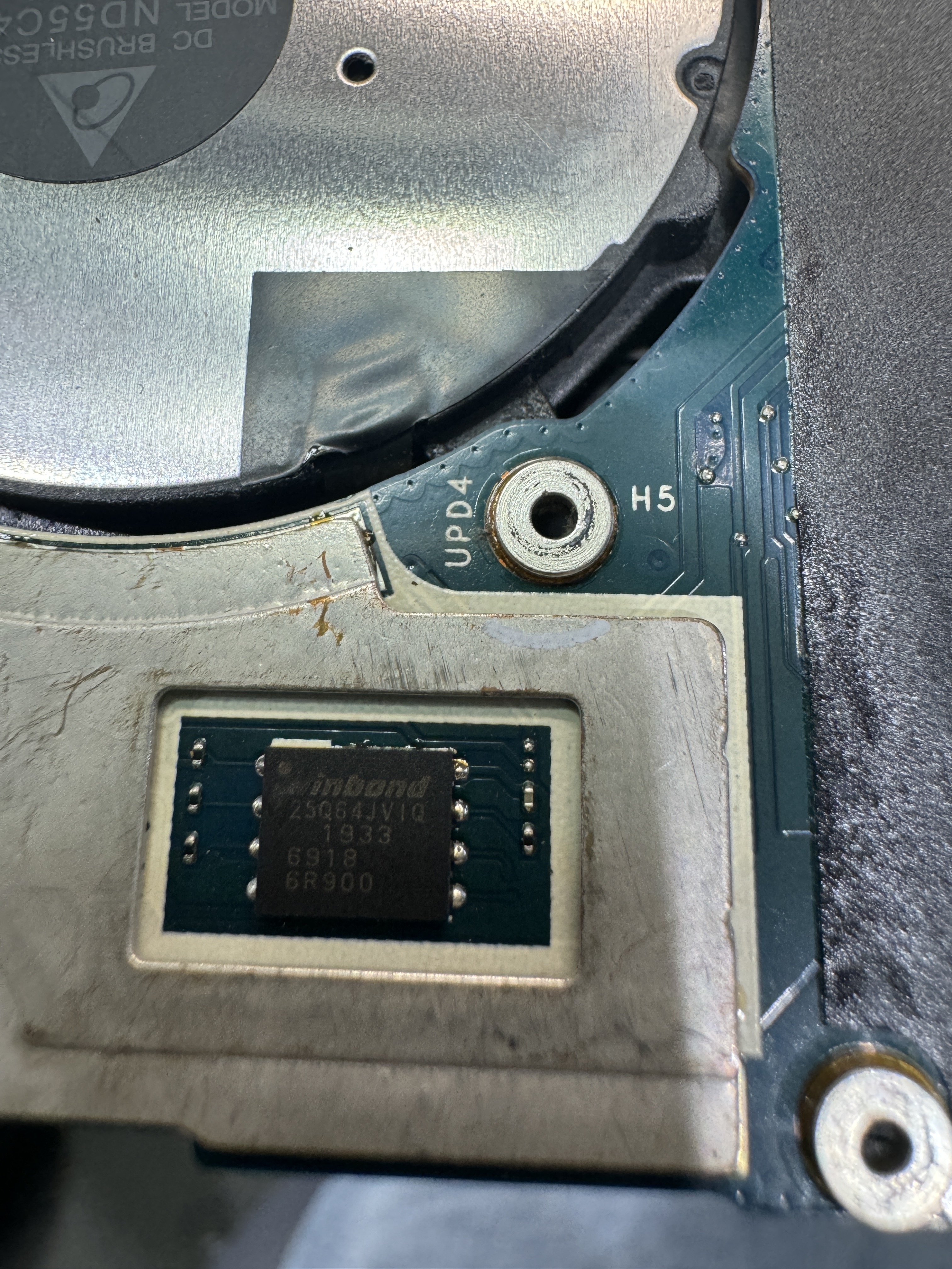

                  do you have a chip labeled UPD4 can you take a picture
                  • iaf86
                    • Mar 2017
                    • 31
                    #90
                    Please check this
                    • kalilinux25
                      • Mar 2018
                      • 2084
                      • ZAMBOANGA SIBUGAY
                      #91
                      Originally posted by iaf86
                      Please check this
                      we need to program it also
                      • kalilinux25
                        • Mar 2018
                        • 2084
                        • ZAMBOANGA SIBUGAY

                          Having attempted both dumps, my laptop is now on but displays Different Service Tag 4B132Z2, and there is no USB or front camera activity. SSD Not detecting properly
                          Is it possible to turn the manufacturer mode on the original dump that I submitted in the first post? because on that dump everything works fine. just need to add original service tag. thank you
