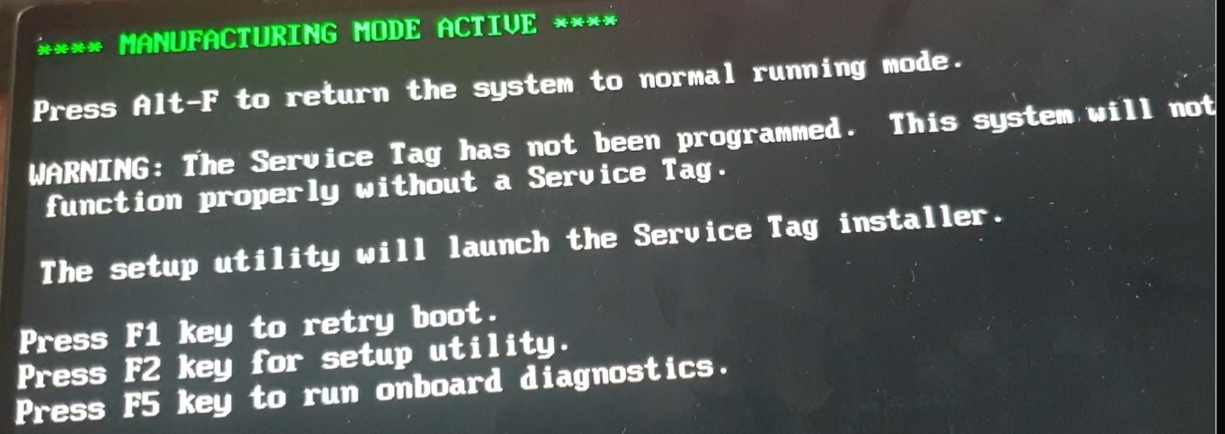

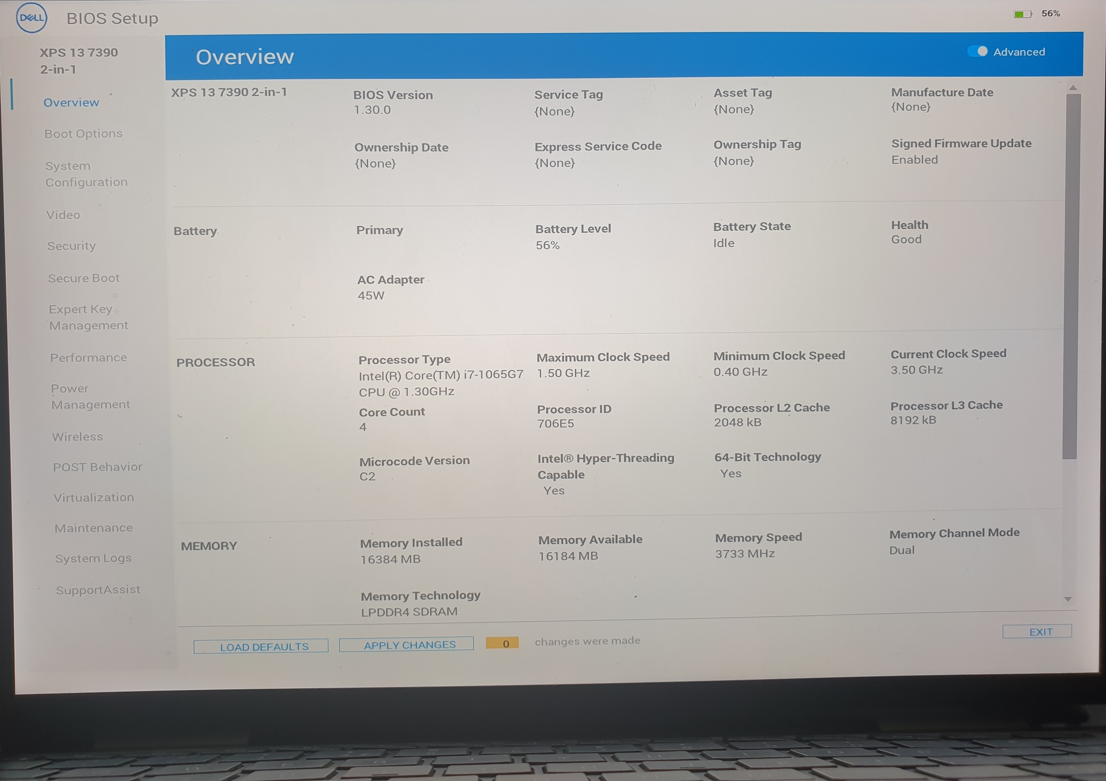

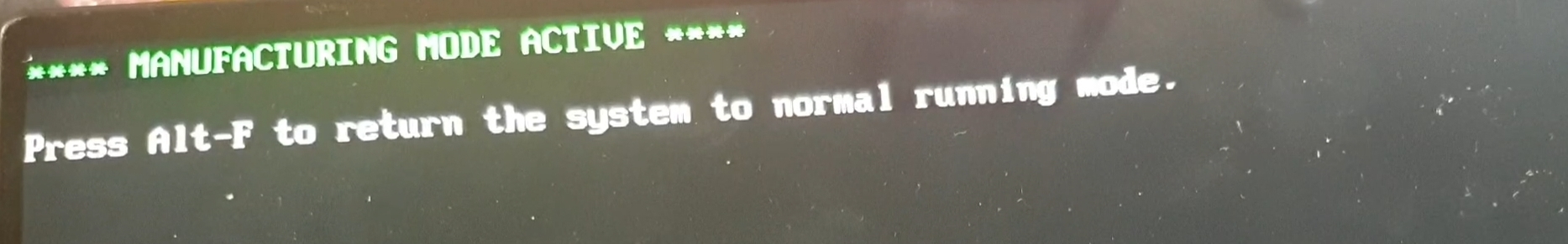

                              #74
                              Originally posted by Markus1741
                              Try ....
                              Thank you wery much
                              Laptop partially works , but the fans run at full speed and the system takes a very long time to load.
                              At startup I get the message "Manufacture mode..." Can this fan problem be fixed and "manufacture mode ..."?

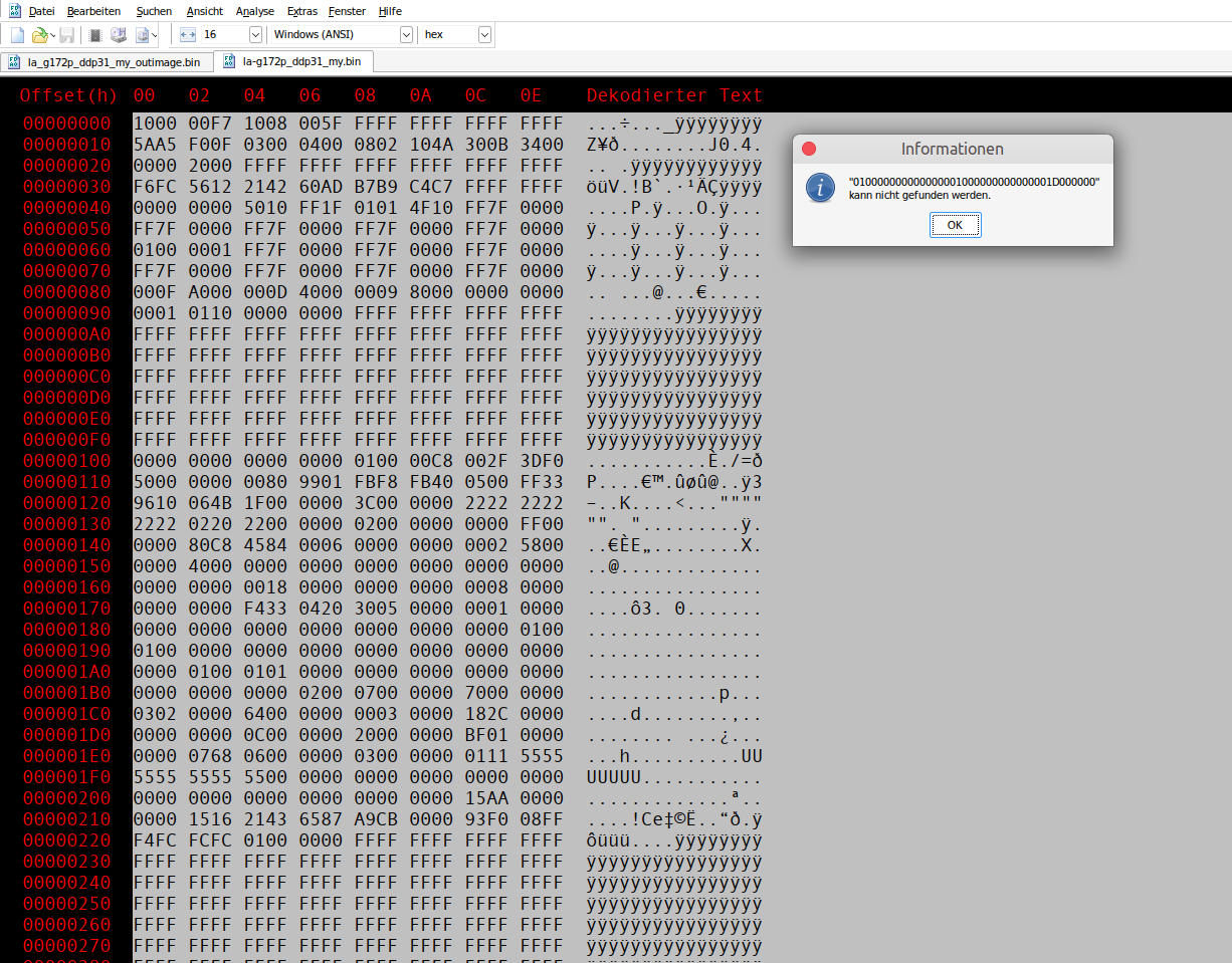

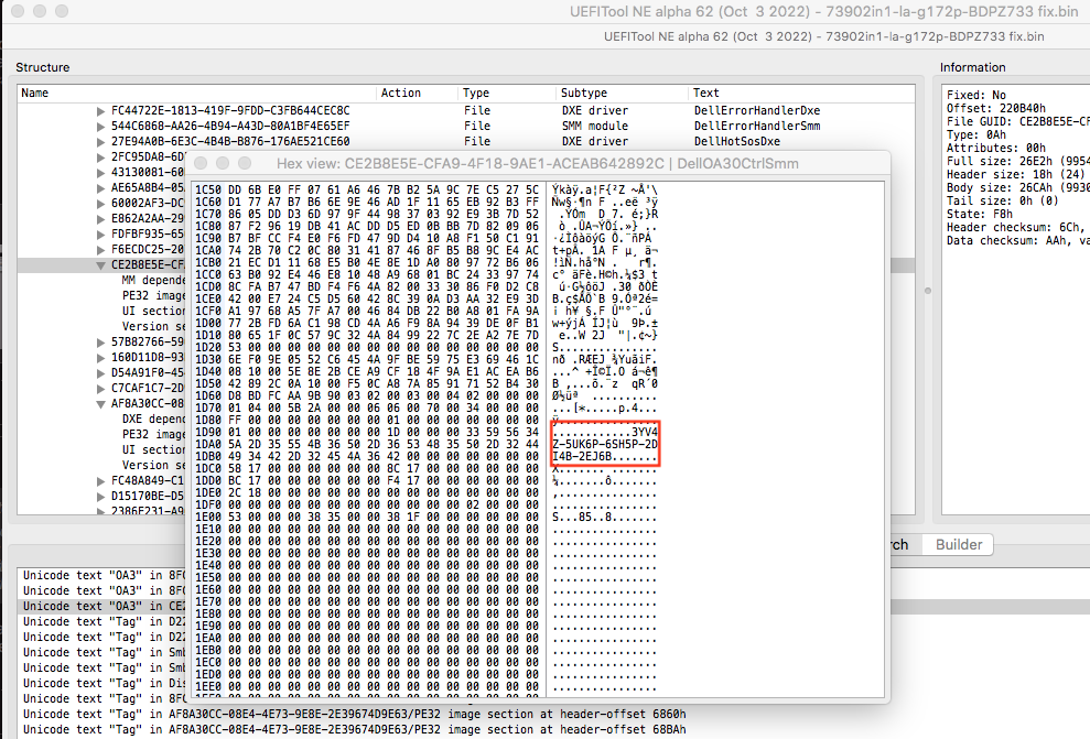

                                #75
                                Try ....
                                Hi
                                DMI is clear.
                                Where can I find the DMI information in the old bios file to copy to the new bios.

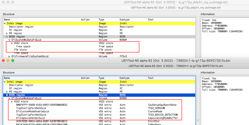

                                • Markus1741
                                  • Sep 2020
                                  • 843
                                  • N/A
                                  #76
                                  Now I can't find any DMI or Windows key in your original BIOS file.
                                  And why does your original BIOS start in manufacturing mode? Who made this happen?
                                  And why didn't you enter the ServiceTag.
                                  All questions that I can't and don't want to answer.​
                                  • darko1234
                                    • Jan 2016
                                    • 29
                                    • Poland
