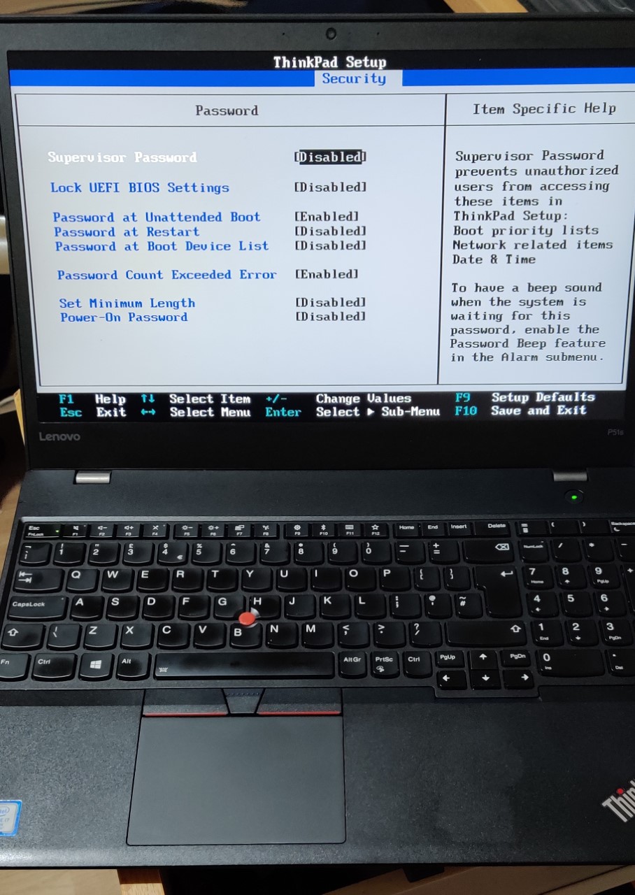

              • Bill_Carson
                • Mar 2021
                • 8
                #467
                Re: LENOVO BIOS AUTO-PATCHER for Supervisor Password Removal
                Please can someone tell me what my SVR password is so I can go in and remove it?
                I have used the CH341a to save the bios 3 times to make sure the file is the same each time and no corruption.
                Please see the attached 1.zip file. your help is greatly appreciated.
                Lenovo P51s 20JY
                zip contains:
                Size: 16777216 bytes (16 MiB)
                SHA256: A1E7278A3855F13B2567C4775F3D6A0CC8F0FAFBD3E9FF30B8AA8EB77831D438

                  Hi try this!
                  • Bill_Carson
                    • Mar 2021
                    • 8
                    #469
                    Originally posted by Markus1741
                    Hi try this!
                    Hi Markus1741 thank you.
                    do I just need to flash the bios chip with the attached file?

                          #472
                          Hi try this!
                          WORKS A TREAT!!!
                          followed the steps on page 1 of this thread, works great!
                          thank you, God bless you!
