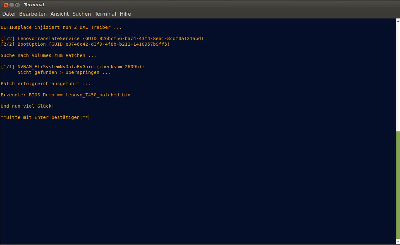

                  Hi i have the same problem on T450 vPro 2x5 beeping after flashing the patched file. The CH341A detects the chip as W25Q128BV. Attaching some screenshots and the original dump. Can you help please? Thanks

                      #330
                      Re: LENOVO BIOS AUTO-PATCHER for Supervisor Password Removal
                      Hi Try This!

                        #331
                        Originally posted by Markus1741
                        Hi Try This!
                        My picture for Autopatcher!
