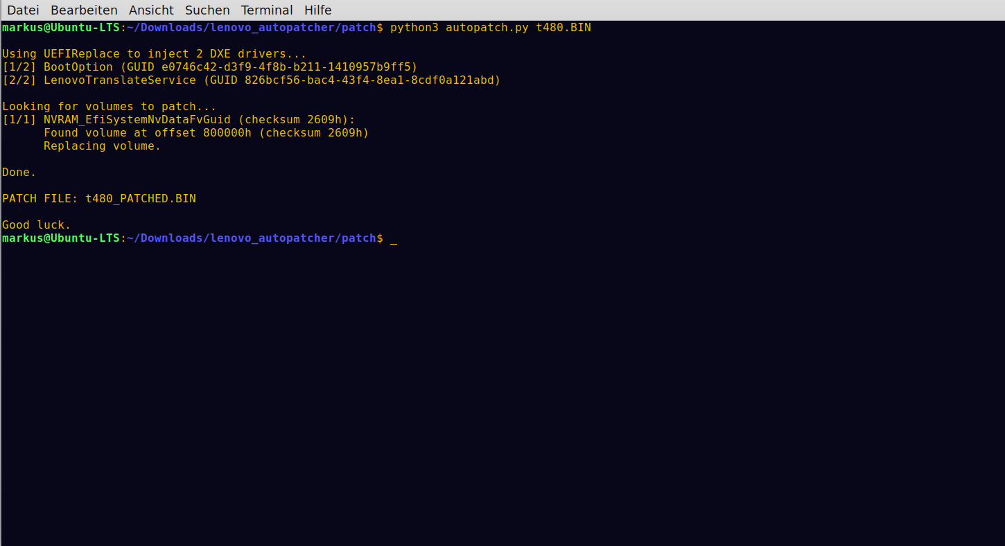

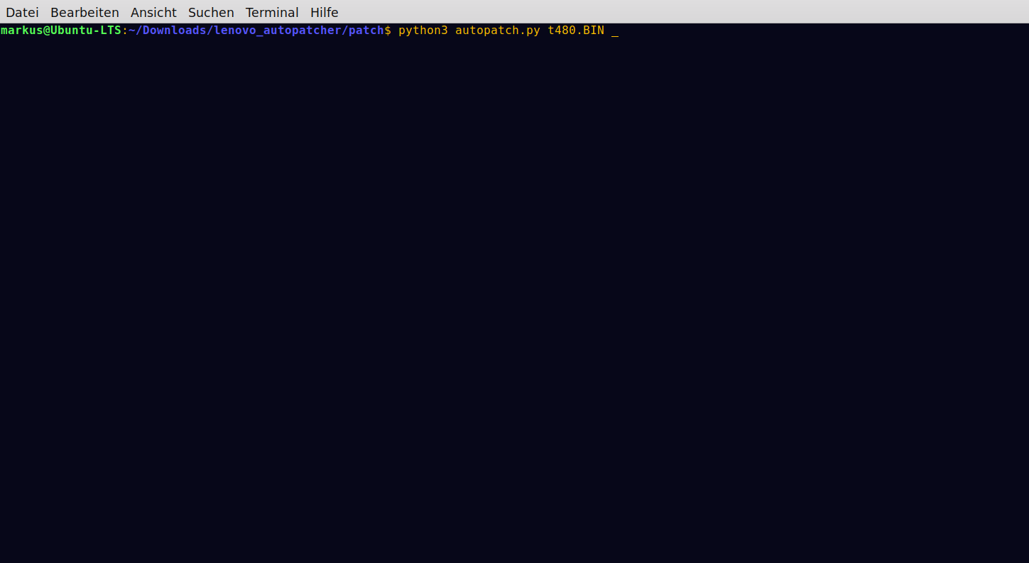

    Originally posted by Markus1741
    Hello, I can already see the problem.
    It is important to either use the absolute path like this.
    python3 $HOME/Desktop/lenovo_autopatcher/patch/autopatch.py $HOME/Desktop/lenovo_autopatcher/patch/Left1st.BIN
    Or you are rich in the same folder than like this
    python3 autopatch.py Left1st.BIN
    Even what does not work in UNIX systems is insufficient information, the system cannot add it itself.
    sudo python3 autopatch Left1st is not correct.
    python3 autopatch.py Left1st.BIN is correct.
    Good luck!!
    I've tried everything and Still having the same error even with trying a dump that i was able to successfully patch 10 minutes before hand on windows 10, on ubuntu it still throws up the same error message.
    fyi: i know enough on ubuntu cli to to understand what I'm doing but I'm no expert with it

          Re: LENOVO BIOS AUTO-PATCHER for Supervisor Password Removal
          I just used the autopatcher for leva2407 in Ubuntu and had no problems with it.
          Maybe with a little patience it will eventually work.

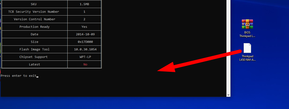

            #665
            hello guys i need to patche this dump .. lenovo thinkpad L450 please some one

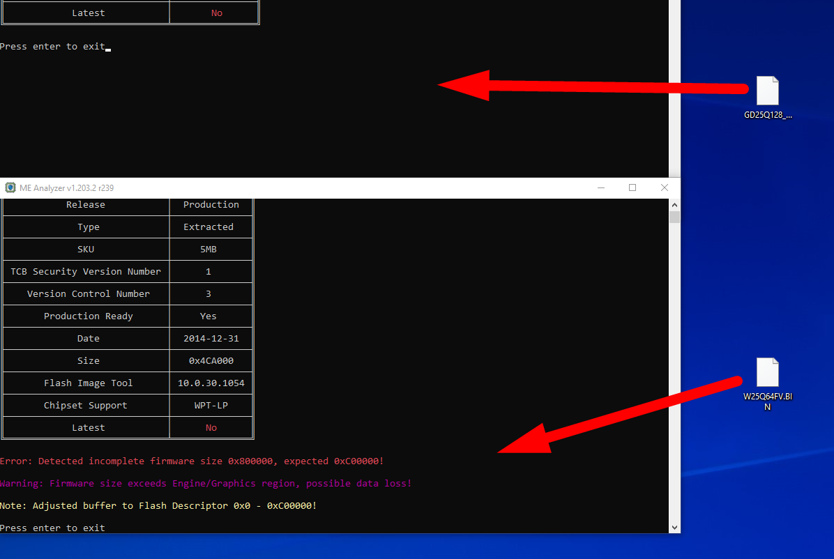

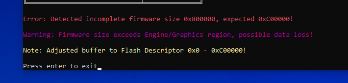

              #666
              dump is corrupt, repeat the extraction, if using ch341 use the Colibri program or version 1.34
              • lktech
                • Jan 2021
                • 39
                • algeria
                #667

                  #668
                  i am using the tl866II Xgpro
                  • 69d0b913
                    • Mar 2018
                    • 146
                    • BR
                    #669
                    Try with this thank you
                    corrupt!
                    see
                    dump corrupt vs dump good

                      #670
                      corrupt!
                      see
                      And what is the solution in your opinion? I also downloaded from the internet and had the same problem with all the firmwares of l450 😑 ?!!

                        #671
                        send version mother board model
                        • 69d0b913
                          • Mar 2018
                          • 146
                          • BR
                          #672
                          you are looking in the wrong place, and your DUMP is corrupt.
                          • 69d0b913
                            • Mar 2018
                            • 146
                            • BR
                            #673
                            And what is the solution in your opinion? I also downloaded from the internet and had the same problem with all the firmwares of l450 �� ?!!
                            your dump has to be healthy, because if it's bad it's going to be a problem and your machine won't work with another DUMP because of the ME region which is corrupt.

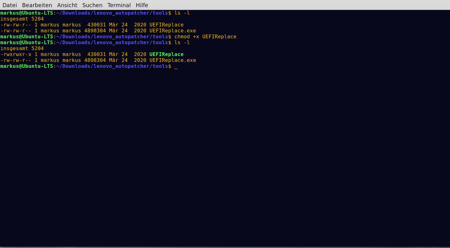

                                        Maybe that will help.
                                        I'm working on an installed system.
                                        I am not using a virtual machine, I cannot provide any information.
                                        I think there are unfulfilled dependencies in your virtual machine.
                                        https://askubuntu.com/questions/1034...ch-file-or-dir
                                        Good luck
