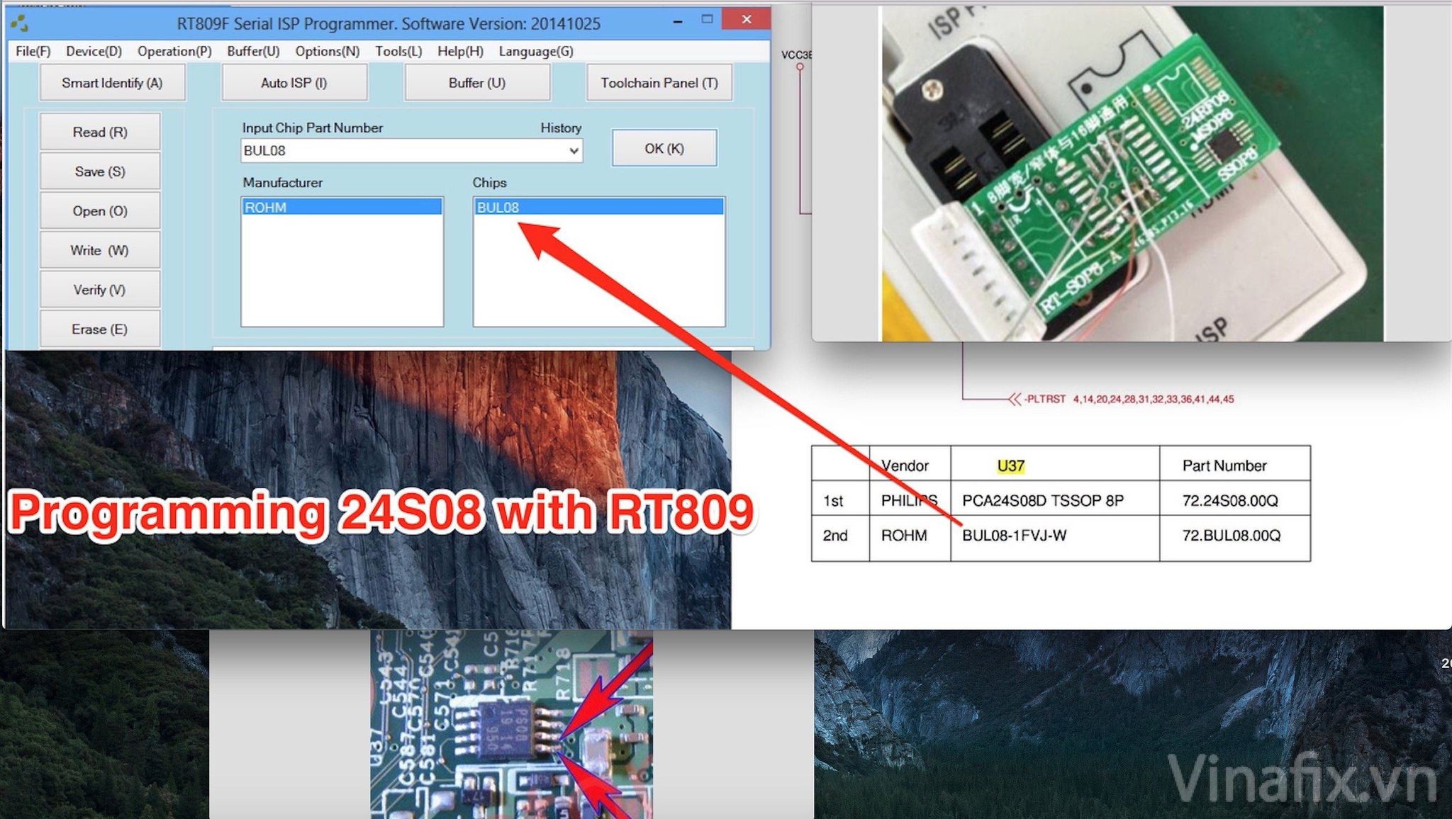

                            Re: LENOVO BIOS AUTO-PATCHER for Supervisor Password Removal
                            can you help me with removing spv psw for lenovo twist s230u?
                            is there a problem with me with the error in the picture?
                            thx
                                thx
                                search second eprom 8mo W25Q64FV U5 AND PS2408

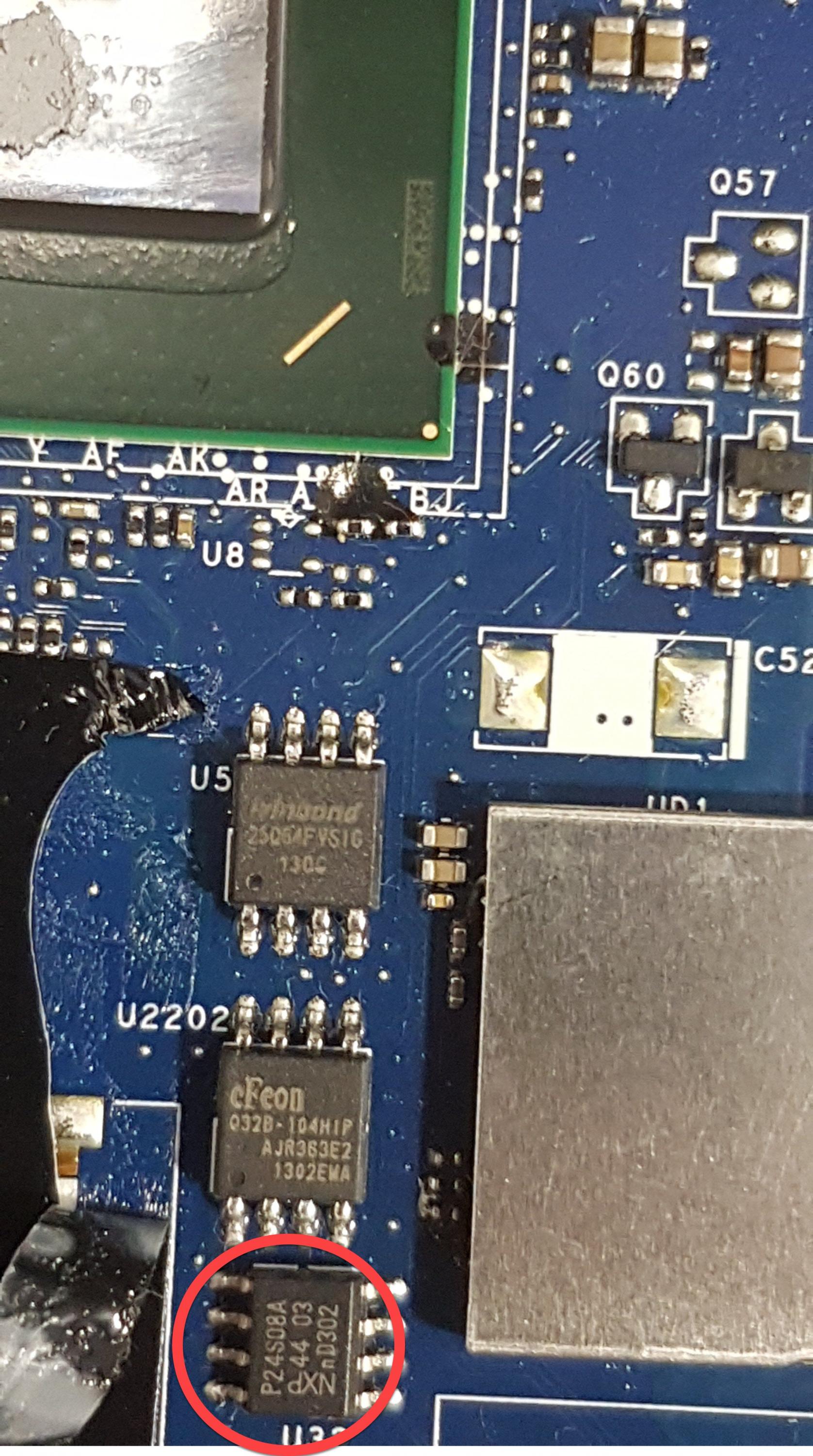

                                  #276
                                  ok
                                  I found the U5 bios chip, only it's a CFEON, but I didn't find the PS2408.
                                  also with error when applying the path
                                    ok
                                    i found the u5 bios chip, only it's a cfeon, but i didn't find the ps2408.
                                    Also with error when applying the path
                                    p24s08 location

                                        you read this eprom
                                        if u have programmer RT809F OR H the method of read this eprom in picture
                                        • danito
                                          • Jun 2016
                                          • 1203
                                          • Romania
                                          #280
                                          [QUOTE=Ghamidi;1004480]
                                          you read this eprom
                                          and that goes into the autopather?
