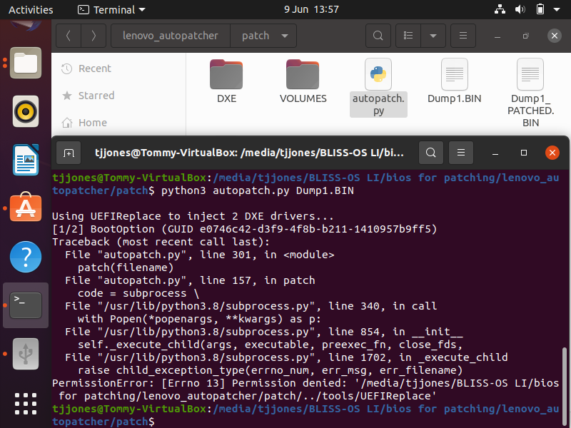

                                    I have set up a machine with ubuntu on it and im now getting this error, just wondering if i'm typing it correctly or if I'm missing something.
                                    It will give an output of the bios I'm patching but the patched bios contents matches up to the original dump.
                                    using lenovo autopatcher on ubuntu 20.04.2 LTS

                                      #658
                                      Re: LENOVO BIOS AUTO-PATCHER for Supervisor Password Removal

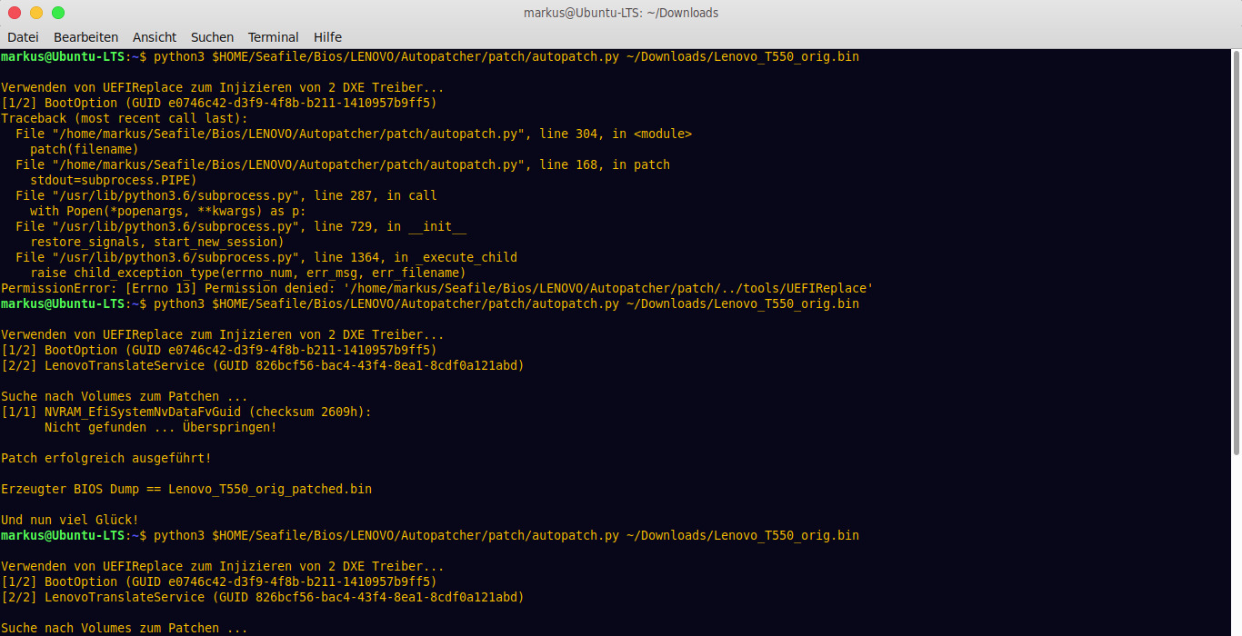

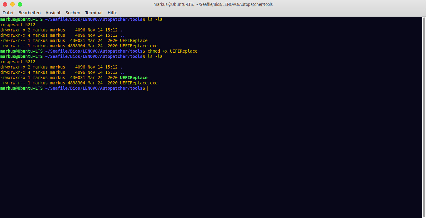

                                      This also happened to me in the beginning.
                                      The reason is simple, the UEFIReplace file cannot be executed.
                                      You need to run chmod +x /Path/TO/tools/UEFIReplace.
                                      Or so
                                      SHOW=$(sudo find $HOME -iname UEFIReplace); echo $SHOW
                                      SHOW=$(sudo find $HOME -iname UEFIReplace); chmod +x $SHOW
                                      SHOW=$(sudo find /media/ -iname UEFIReplace); chmod +x $SHOW

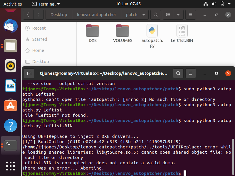

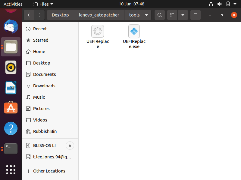

                                        Ive done this now and now getting a different message, I've tried two different dumps of the same make and model as before (the original one you did for me and an original one of a second machine) and both come up with this message.
                                        Please see screenshots, I've included one of the terminal output and one of the folder location where its pointing.
                                        My theory is that its trying to open the UEFIReplace.exe but I've also tried it on windows 10 and this is still the same output.

                                          #660
                                          Hello, I can already see the problem.
                                          It is important to either use the absolute path like this.
                                          python3 $HOME/Desktop/lenovo_autopatcher/patch/autopatch.py $HOME/Desktop/lenovo_autopatcher/patch/Left1st.BIN
                                          Or you are rich in the same folder than like this
                                          python3 autopatch.py Left1st.BIN
                                          Even what does not work in UNIX systems is insufficient information, the system cannot add it itself.
                                          sudo python3 autopatch Left1st is not correct.
                                          python3 autopatch.py Left1st.BIN is correct.
                                          Good luck!!
