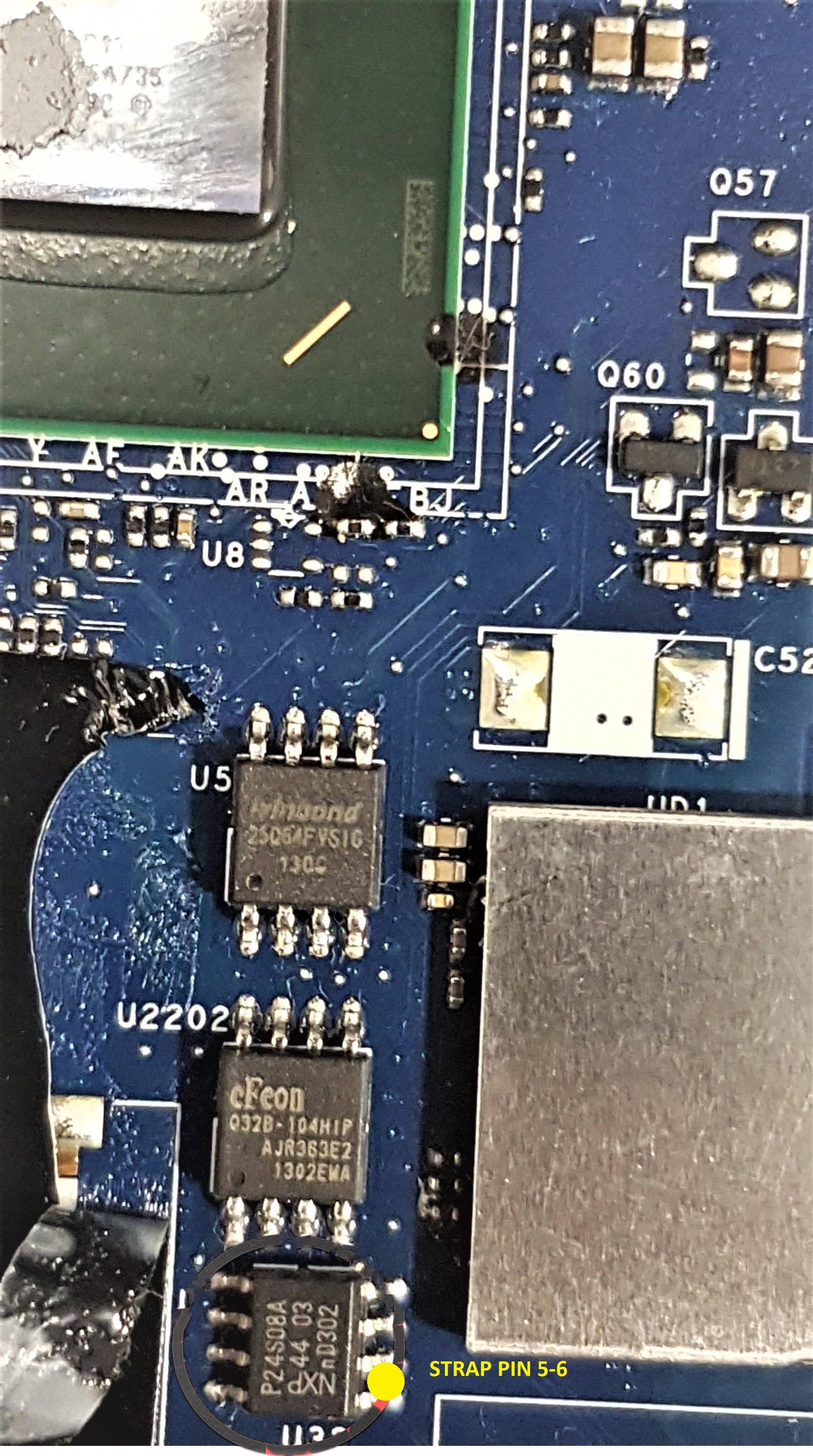

            Lenovo twist s203u
            Nothing should be read from U32 (p24s08).
            It must be shortened between pins 5 and 6 exactly when you turn it on.
            press f1 for the bios, enter the bios, take the tip of the screwdriver (in my case) you go to security change the password, F10 for saving that's about it.
