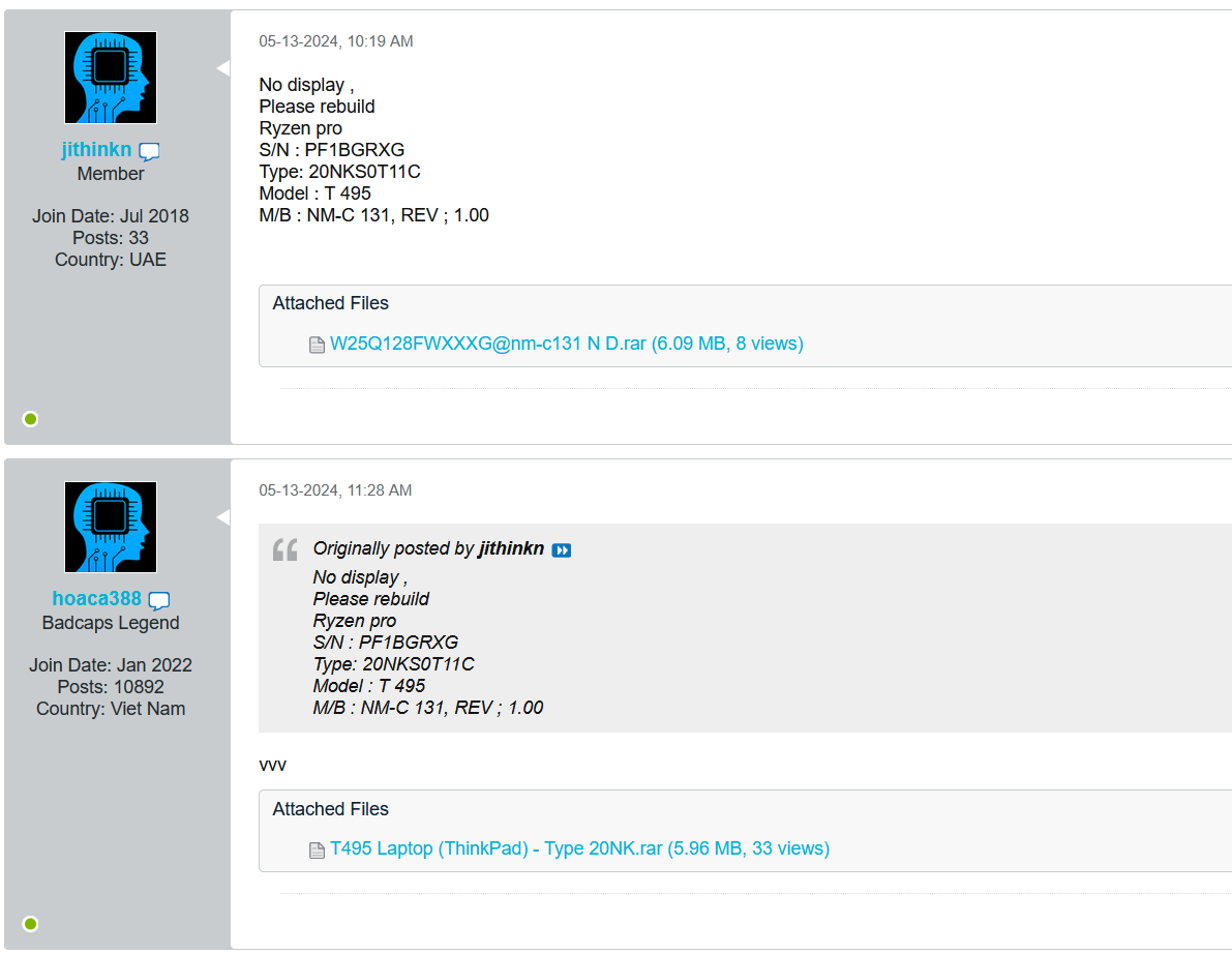

          #3824
          Corrupted bios or lost resistors near the chip.
          Try original bios or put another one.
          Too many problems with these cheap programmers.
          If white screen probably bios problem
          Don't use clamp
          Click image for larger version Name:	image.png Views:	0 Size:	109.2 KB ID:	3645634
          try
          T495 Laptop (ThinkPad) - Type 20NK.rar
          Provided serial number and model type
          THANK YOU SO MUCH MAN IT WORKED!!!
