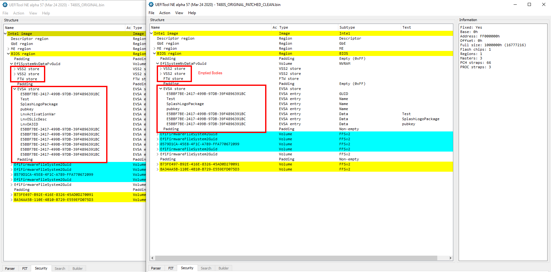

              if you compare an x240 with an L470, you notice that there is a blue part in uefi tools. you need to correct checksum for work.
              no need to patch each bios, the patched files are compatible in other machines. just need to create a library
              on the last gen, it is written twice (see pics)

                          Right. The autopatcher has 2 steps. On the first pass it injects the patched DXE drivers. If the bios is from an older gen it ends there and its work is done. If it's a newer generation on the second pass it replaces parts of the NVRAM with clean ones and then it's done. I've patched some of the ones you have listed in NOK and they all reported working.

                            Re: LENOVO BIOS AUTO-PATCHER for Supervisor Password Removal
                            ok my error is the NVRAM and not the checksum then
                                Yes ok I saw the 2 VSS2 and FTW. Why patched EVSA, it is identical to orignal?
                                    The EVSA was tricky...
                                    Without patching that the laptop plays a little musical tone after boot and the screen stays black...
