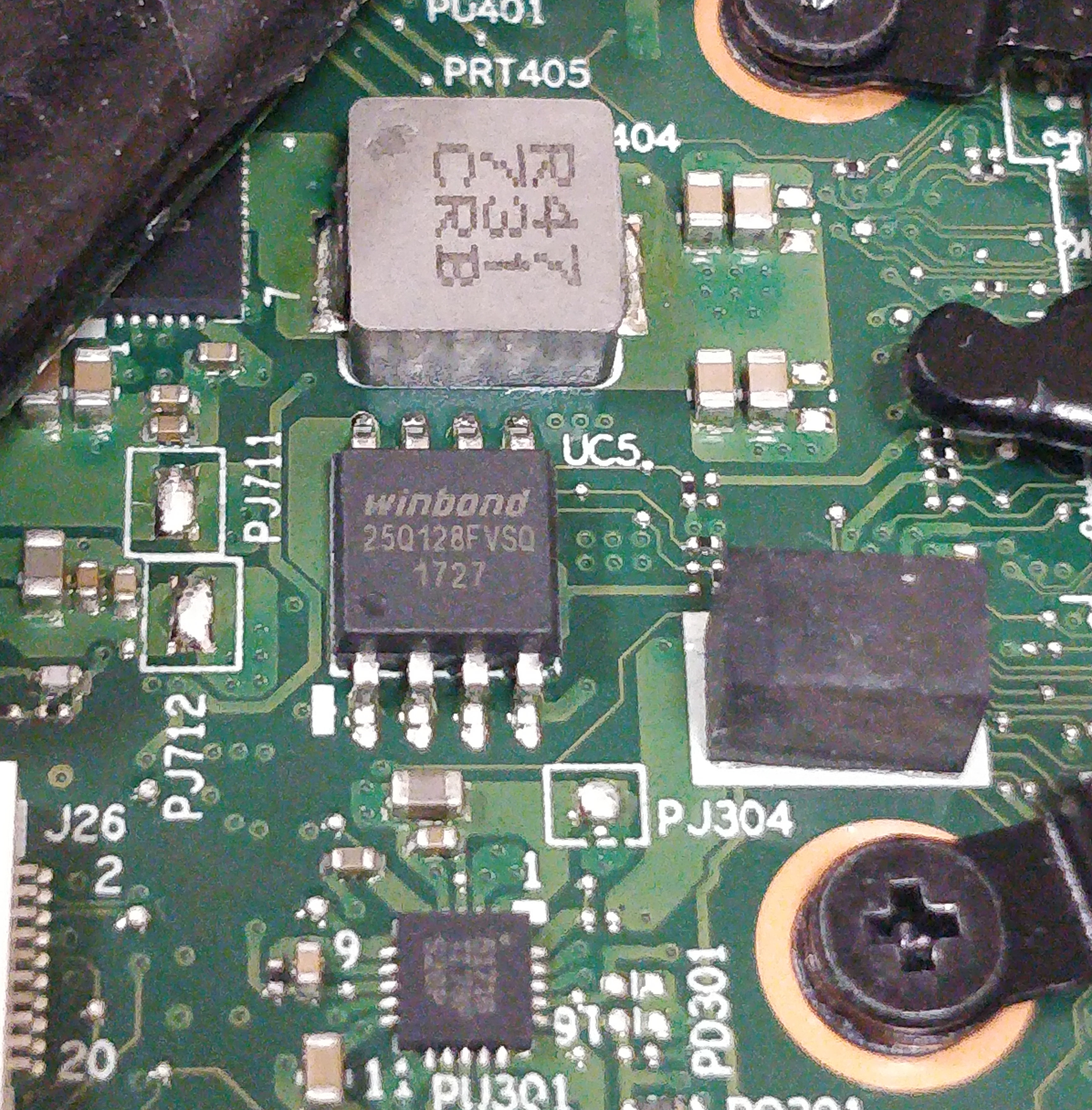

                              #2980
                              I have a Lenovo X270 with a supervisor password that I want to remove.
                              This is what it looks like before starting:
                              Before starting
                              I bought a CH341A programmer, and I have a soldering iron so I thought I'd give this a try.
                              The programmer came with a clip that can't be used because of adjacent components, but also a tiny board that you can use to solder the chip directly.
                              So I unsoldered the Winbond 25Q128FVSQ chip from the motherboard, and soldered it to the tiny board, it looks like this:
                              Programming
                              Made 2 backups using flashrom, like this:
                              flashrom --programmer ch341a_spi -r backup1.bin
                              This took 2-3 minutes.
                              Then I used the autopatcher.
                              Then I wrote the patched bios, like this:
                              flashrom --programmer ch341a_spi -w backup1_PATCHED.bin
                              This took 5 minutes.
                              Then I soldered the chip to the motherboard, but the computer wouldn't turn on anymore.
                              I pressed the button and waited a couple of second, but nothing.
                              Does it turn on normally with the patched bios?
                              I thought I may have soldered it wrong (a short circuit or something), so I proceeded to desolder it, clean the paste and try again.
                              And unfortunately one of the tracks in the PCB broke (pin 2), as can be seen in this photo:
                              Broken track (pin 2)
                              Pin 3 has a tiny bit of solder above, but it's ok, please ignore that.
                              Anyway, I should not have attempted this without a reflow station, soldering paste and heat protective tape.
                              If only I knew where this track goes, I could possibly rescue it with a cable.
                              This is a long shot, but does anyone have any idea on how would I fix this?
