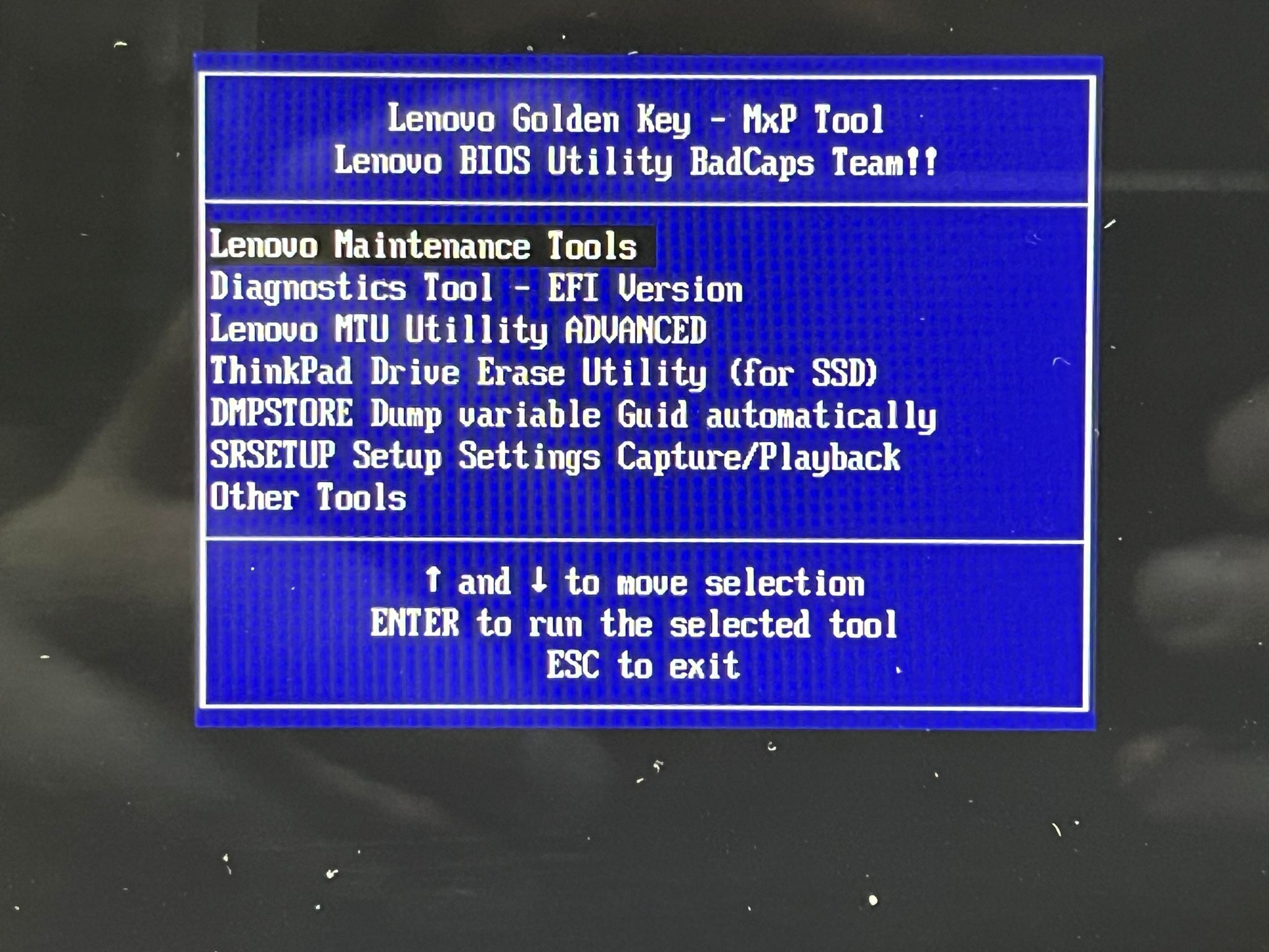

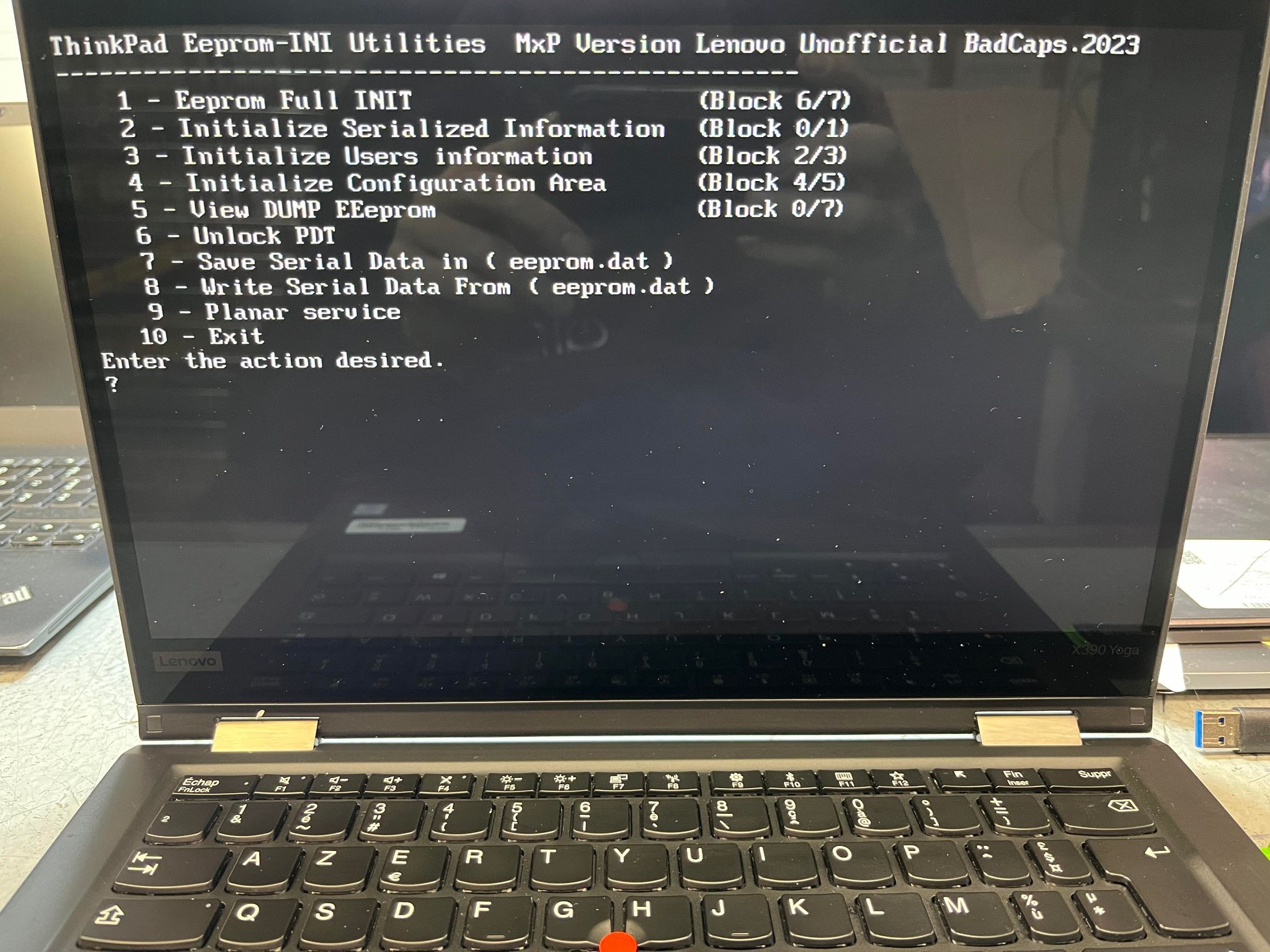

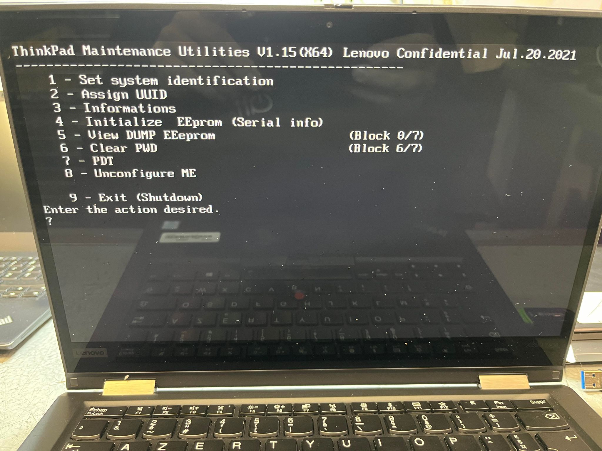

      Originally posted by RethoricalCheese
      Here's what I did. It's quite easy to modify. Not that it makes any difference to getting it to unlock
      -S (Initialize serialize information)
      -U (Initialize user information)
      -C (Initialize configuration information)
      RethoricalCheese your inbox is full
      -S -U -C none remove password, only Full init or modified utilities
