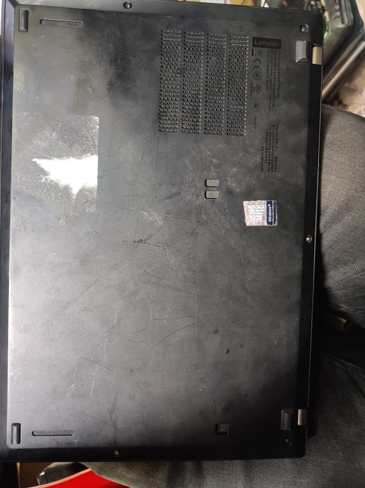

                    Lenovo X390 8th need unlock please i try with lenovo patcher it give black screen and give beeps
                      I think this will never work with Auto-Patcher this modell needs via jtag mec chip programming ....
                        Please read the updated rules,the serial number/service tag etc must be posted

                          Originally posted by corona100
                          lenovo x390 8th need unlock please i try with lenovo patcher it give black screen and give beeps
                          try

                            #2893
                            Re: LENOVO BIOS AUTO-PATCHER for Supervisor Password Removal
                            thanks ALi i figure out that this model unlocked only with jtag the DXE patch not work

                                  SMDFlea
                                  This laptop ( Lenovo X390 ) doesn't have any sticker behind there is no serial number or anyting
                                  every thing removed
                                    SMDFlea
                                    every thing removed
                                    Use the forum search, read the X390 threads . JTAG
