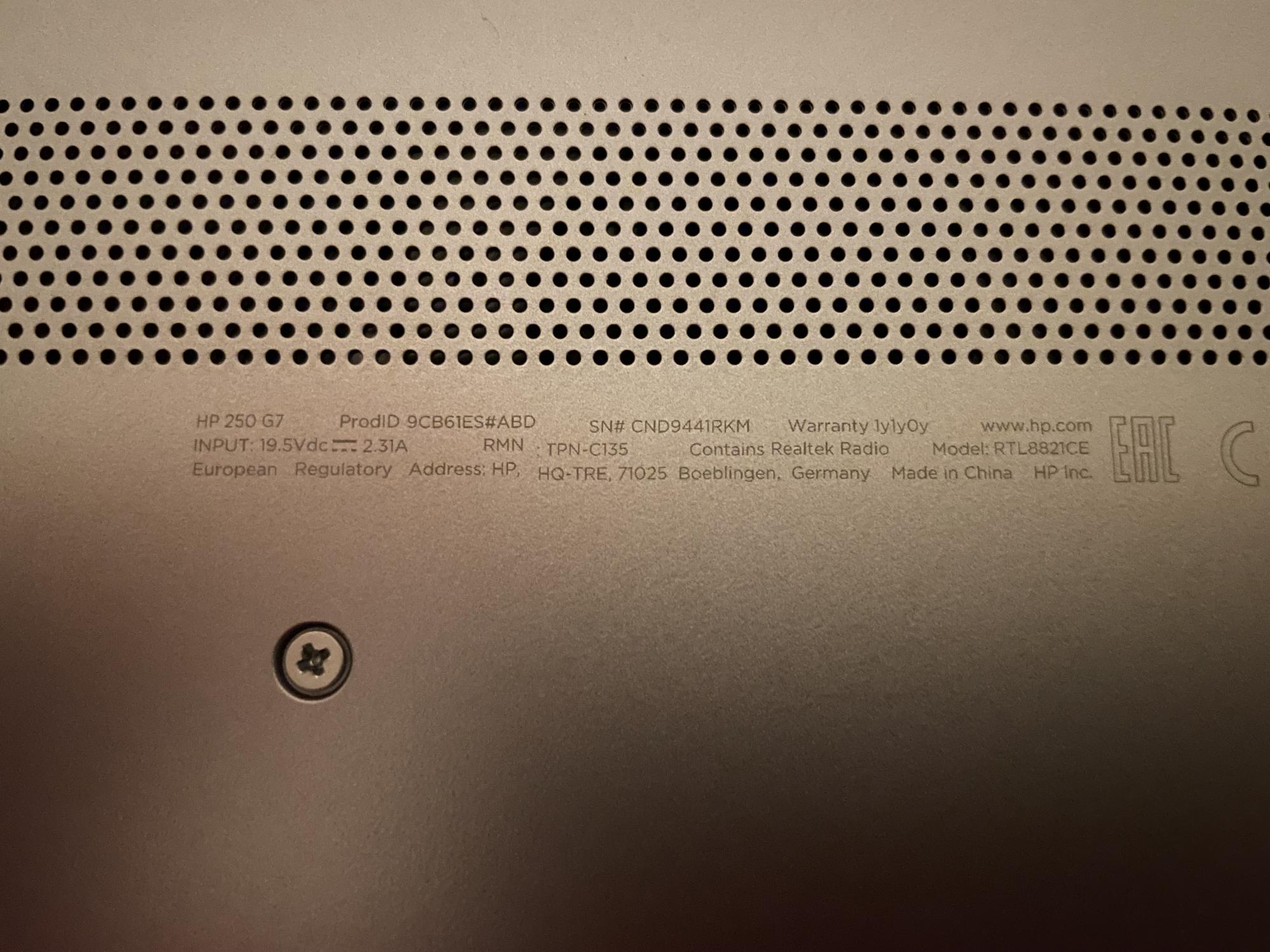

    Bios HP 250 G7 need help
    said NB recently tried a bios update (automatically?) said the owner. So I tried to flash the latest bios from HP using a repair stick.
    However, it only starts during the flash process until "initialize"... - after a few seconds it switches off and stays on with pwr_led.
    Bios backup file does not exist.
    Serial Nr: CND93963RY
    Screenshot of the label attached. Can someone help if possible with instructions or a link to it?
    Thanks in advance

      do you have an SPI programmer ?

        Unfortunately no longer available...pensioner.

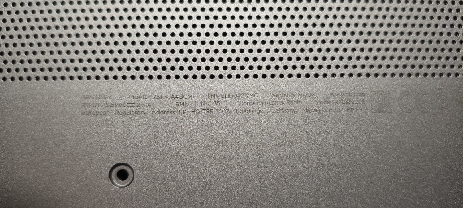

                            #53
                            Hi, can anybody repair my biosfile ?
                            Error : black screen , 5 long, 3 short blinks
                            HP 250 G7
                            Ser: CND04212MC
                            Mainboard : LA-J951P
                            thanks
                            • hoaca388
                              • Jan 2022
                              • 11139
                              • Viet Nam
                              #54
                              HP 250 G7
                              Ser: CND04212MC
                              thanks
                              The file you posted is for OMEN by HP - 17-w200nx and your serial number is also bogus.
                              Become a Badcaps supporter
                              Thanks to all supporters.

                                #55
                                The BIOS may be wrong, im not first who flashed it. That means i dont have original file. But SN is from bottom cover.
                                • hoaca388
                                  • Jan 2022
                                  • 11139
                                  • Viet Nam
                                  #56
                                  Try # 51

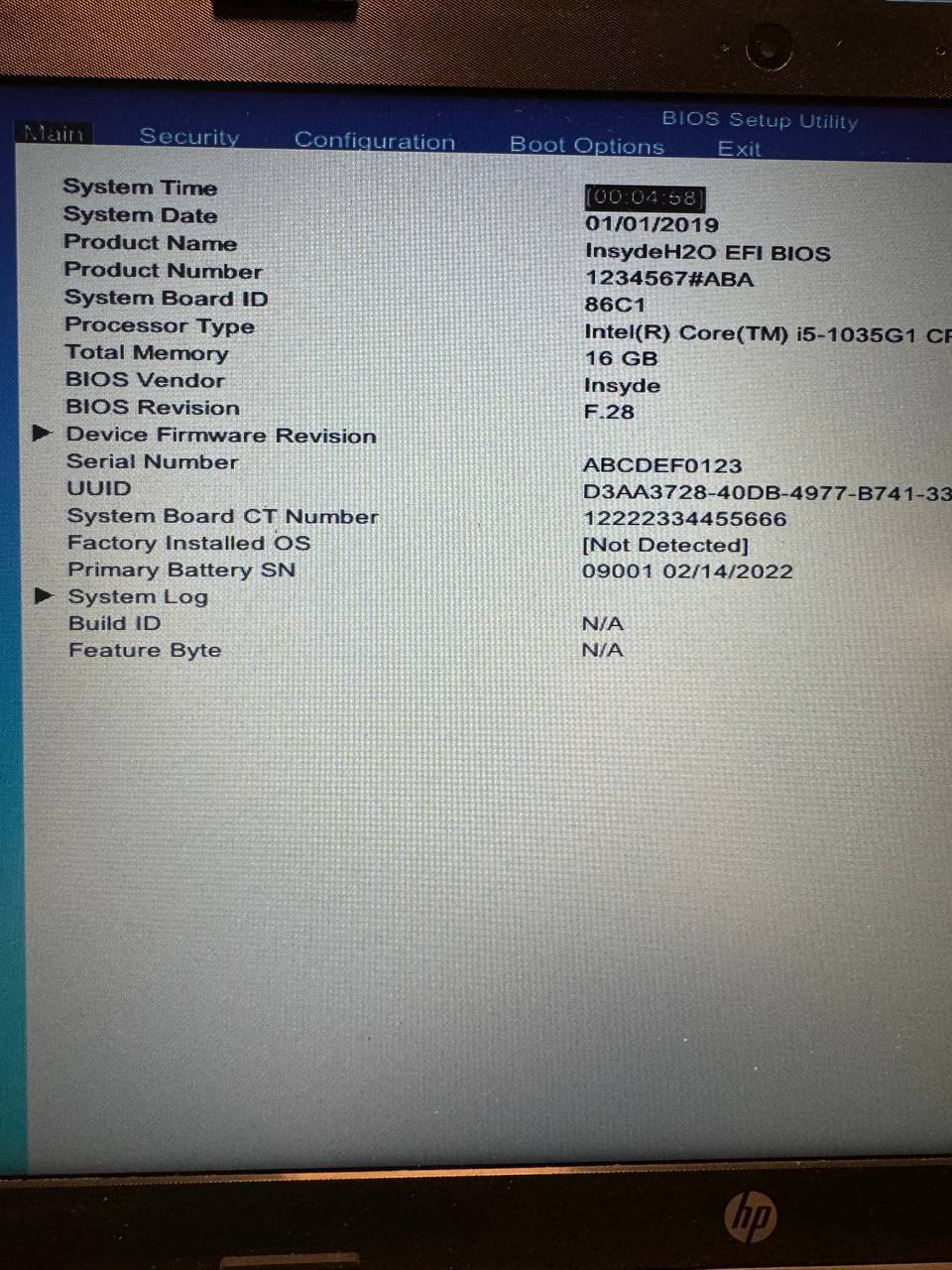

                                    #57
                                    Hi there, I got this laptop used and when it reboots it tries everytime to update the BIOS but it fails to write the bios and stucks at 1%.
                                    To power off the machine, i need to open it and remove the battery.
                                    I saw in the BIOS that the serial, model and windows serial info are missing. Maybe the previous owner messed with the BIOS for some reason, and now I don't have the DMI data.
                                    Maybe if I can manually insert back the values, I can proceed to update, but how can I add the values? I tried with the HP BIOS Tool but with no luck. I do have an SPI Programmer (using Raspberry PI)
                                      • 20286
                                      #58
