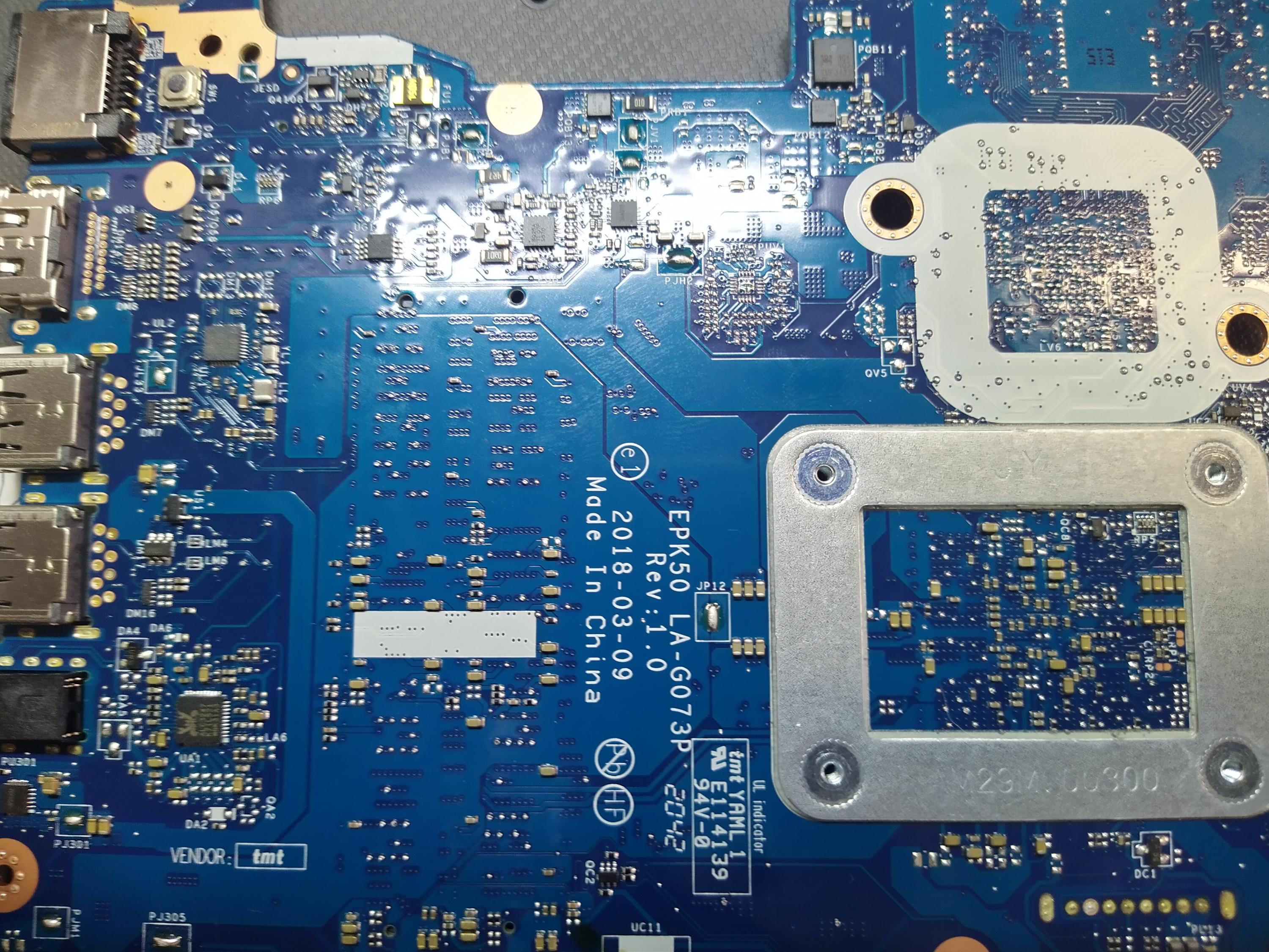

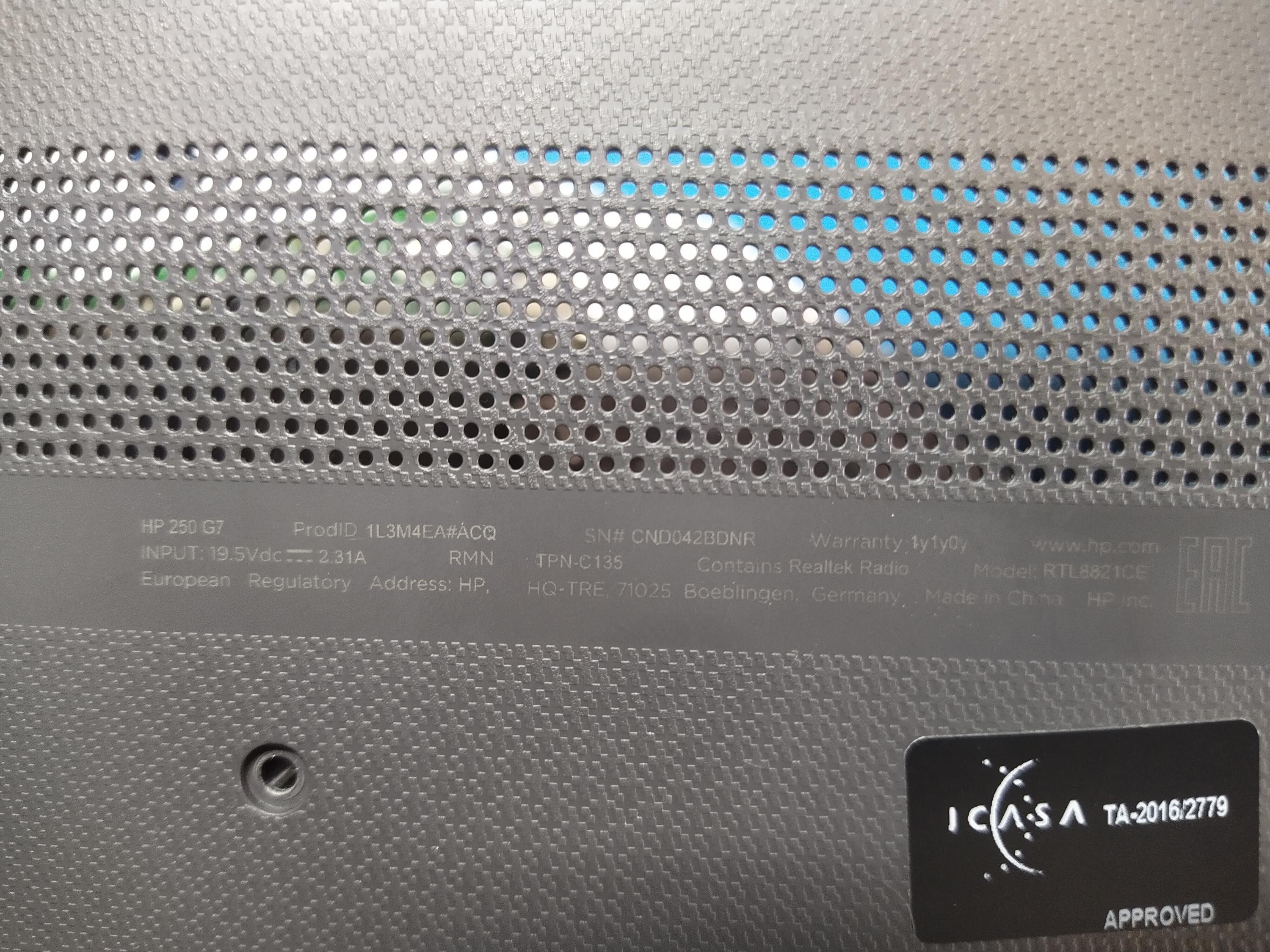

                    #29
                    HP 250 G7 BIOS No display
                    Good day, please help HP no display, Board number EPK50 LA-G073P
                    Attached is the Original BIOS BIN
                    Motherboard Picture
                    Model No
                    • hoaca388
                      Badcaps
                      • Jan 2022
                      • 12441
                      #30
                      Re: HP 250 G7 BIOS No display
                      HP 250 G7 Notebook PC

                        #31
                        Now it blinks 3 times and 2 short with this bin.
                        • hoaca388
                          Badcaps
                          • Jan 2022
                          • 12441
                          #32
                          There are 6 bios versions for this model. If the file you uploaded is exactly the original then it has code 084AA and it should work if the problem is just a corrupt bios. I've also attached the rest of the files for you to try, which don't have DMI info yet.
