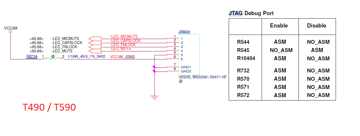

      In X390 i have same result. I try read / write was errored veryfi and different file. But when i extract EC from .exe and try again was upload succesfull and laptop working. Now i try same in T490 but still same errors with read chip (with error, i read X time and all file are simillar but different in HXD and when write chip i have same - error veryfii.
      I have resistor 10k in PIN 1, 2, 3, 4 , 6 ? Good ? in schematic yours i dont see resistor on pin 6?
      And the second question i take 3.3 V from this motherboard ? is good ? or i need supply 3.3 V from other source ??
      I put AC adapter to motherboard - is good ?? or i should use 3.3 from other sorce and should be enought?
      I have RT809H programmer also and is same result like in svode but in svod 1 times works on X390 lenovo.
      edit. i was find schematic for T490::
      So in this case i need only 1 resistor 10k for pin 6 ?? and put only there 3.3 V ?? i good understand ? ?

        Question1: I have resistor 10k in PIN 1, 2, 3, 4 , 6 ? Good ? in schematic yours i dont see resistor on pin 6?
        Answer: Pin6 has a 49.9 Ohm resistor to +VCC3M.
        Question2: And the second question i take 3.3 V from this motherboard ? is good ? or i need supply 3.3 V from other source ??
        Answer2: Pin6 is connected to Vcc through a resistor, you can get +3.3 from this other point where the 49.9 resistor is connected to.
        For X390 you can program using keyboard connector, thorugh FPC cable.

          So now i still don't understand.
          - Now i use direct connection - i don't have resistor etc... programmer detect ID. I can read / write but all read / write are corrupt. When i read and compare i don't write all information or have different in many place.
          When the motherboard is connect to AC - on pin 6 i have 3.3 so i think i don't need take from board and other source next 3.3 to this PIN. (in this case) like on schematic ??
          I try 3-4 different type of cable and i have same result in SVODE 3 and RT809H programmer.

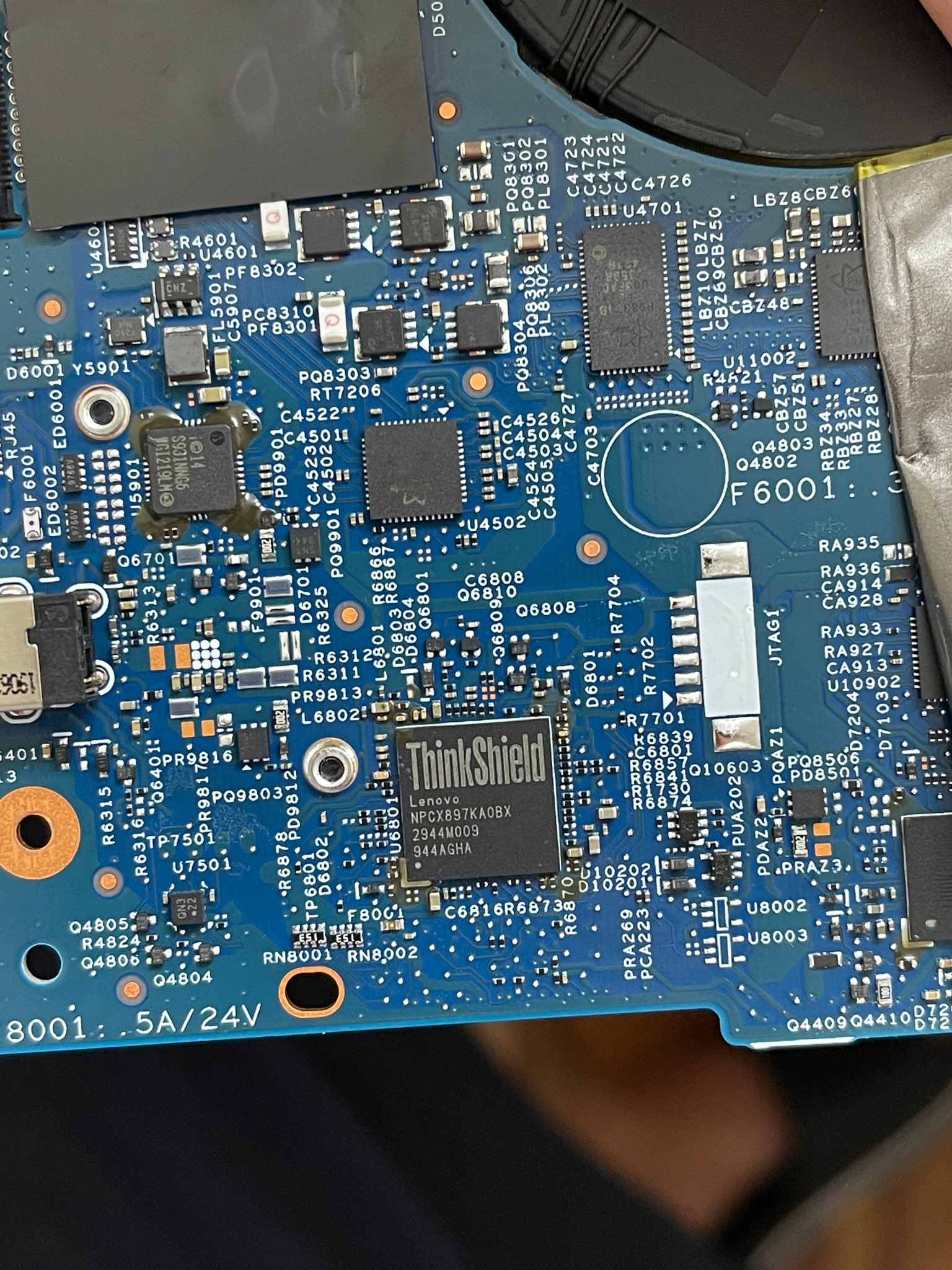

            How about this one? on thinkpad P1 9th
            how to device and read?

                        In my case with svod3 done read the t490 1663mec file and save it is 256kb ok then erase it and write an unlocked file after that i boot to bios and supervisor password gone all ok then i repeat the process and write back the original file that i save the first time and i can confirm t490 unlocked.
                        No PULL-UP resistors to JTAG signals needed or 3.3v power suply as pin 6 has 3.3v only connect direct to svod3 all 6 jtag pins.
                        PULL-UP Resitor must move to PULL-DOWN like attached photo and put back after every step.

                          I just moved reset signal resistor and used keyboard connector to do all the programming. Worked well.
