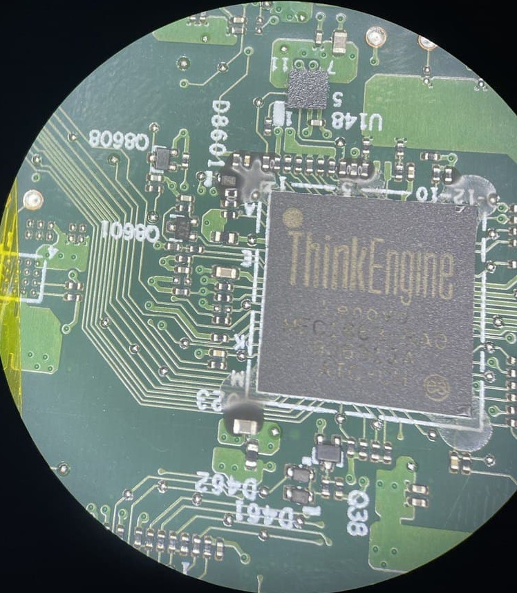

        For my T490s nm-b891 this method does not work. My actions:
        1) disconnected all source of energy
        2) read and saved main bios 32mb and 256kb MEC1663
        3) erase end check blank main bios and MEC
        4) programmed MEC1663, dump from bios update (clear EC dump)
        5) programmed main bios, dump from bios update (clear bios regin + clear me region)
        6) turn on, and.... SVP remains active.
        I think SVP in this platform duplicated in 3 places - Main Bios, Embeded controller(MEC1663) and TPM (ST33HTPH)...
        Do you have any ideas to check the flash / ROM TPM module?

            • LenBios
              • 122
              • Ker
              #46
              Re: mec 16xx dump with info block
              this is the pin to connect to the programmer

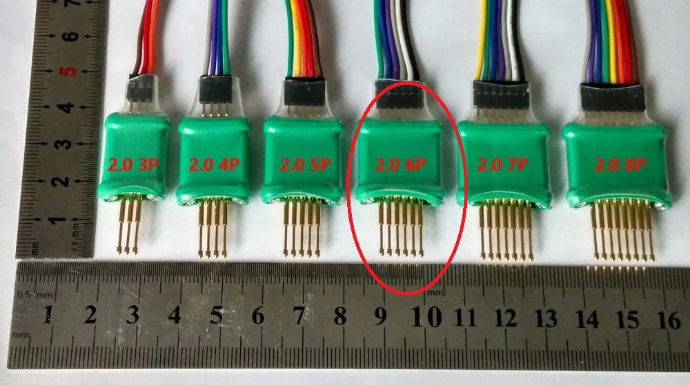

                                      • LenBios
                                        • 122
                                        • Ker
                                        #59
                                        Originally posted by RethoricalCheese
                                        Yup, last time I did this, RT809H worked fine. But that was a loaner. I was told SVOD3 is even better so that's what got bought instead
                                        And yes, you can use keyboard connector on T490. But disassembly is still required to move the JTAG reset resistor.
                                        use such pins its easy to use, no need to solder the wires on JTAG Points
                                        • LenBios
                                          • 122
                                          • Ker
                                          #60
                                          this pins
