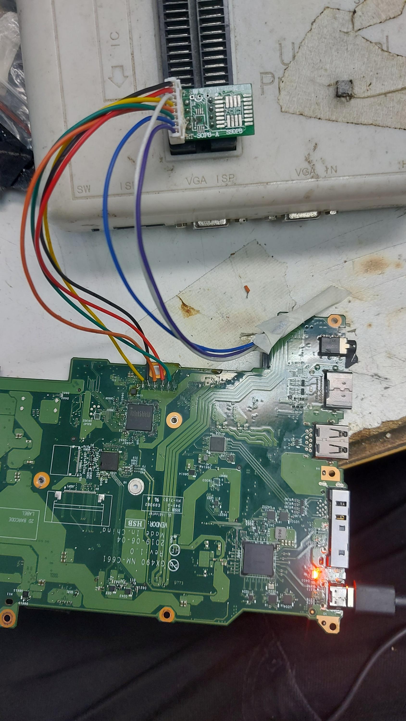

                            #353
                            Re: mec 16xx dump with info block
                            help please
                            lenovo t590
                            nm-b901
                            When connecting jtag and working read id this message appears

                              #354
                              Originally posted by elmasryomda
                              help please
                              lenovo t590
                              nm-b901
                              You also put on charger of notebook and then press Read ID?

                                #355
                                When programming ENE, for example, we press read id, then in another step, the programmer asks to connect the laptop charger and follow the programming process
                                Are the steps for programming a mec different from that?
                                Is it possible that a problem occurs when connecting the laptop charger before pressing read id?
                                Thank you all

                                  Hello!
                                  Anyone can help me?

                                    #357
                                    may i see your jumper wires into the motherboard?
