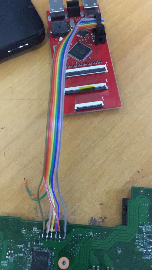

                      Hello, This board is for the Lenovo X1 Yoga gen 5, I need to read the MEC1663 chip but I am asking if the indicated red button is the JTAG pins outs ?
                      Also I knocked out one resistor and i believe it is 10K 0201 resistor.
                      thank you in advance.

                        #311
                        Re: mec 16xx dump with info block
                        Yes, somebody connected like the attachment photo.
                        • ajbernasko
                          • Mar 2022
                          • 229
                          • ghana
                          #312
                          Thank you for your reply, I have the same cable with RT809H, I will try it out and let the forum know.

                                #315
                                Please can you help me label which one it is TMS, RST, TDI, TDO and GND. Thank you

                                  #316
                                  like this :
