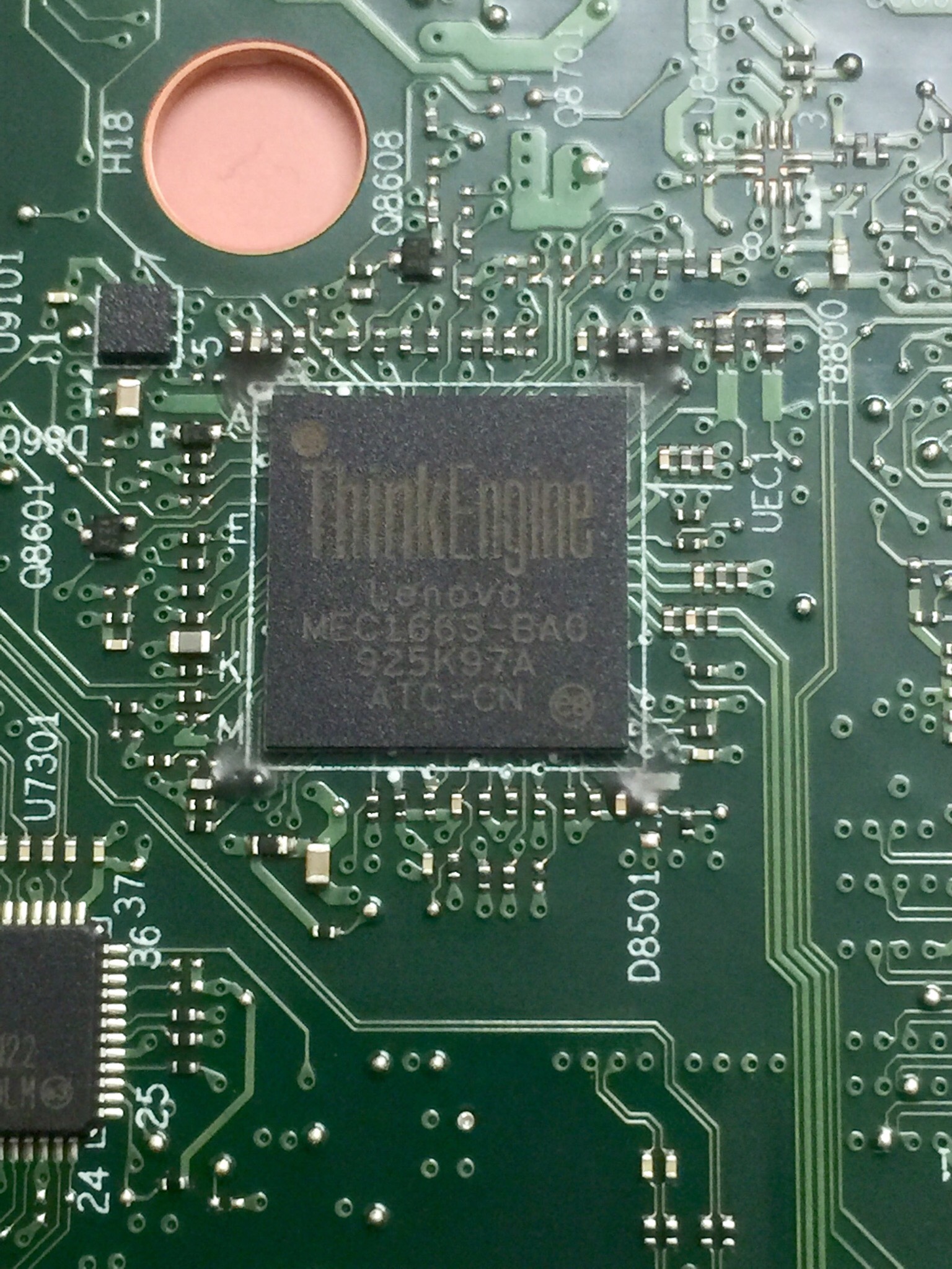

            Re: mec 16xx dump with info block
            Hy. I also have a T490s. Did you remove the chip or connected the programmer via wires to the motherboard? I can't find schematic or where the pins are. Also, did you succeed in removing SVP ?

                    Do you know which or where is the RST#? It's a T490 with the MEC1663
                    Any help is really appreciated.

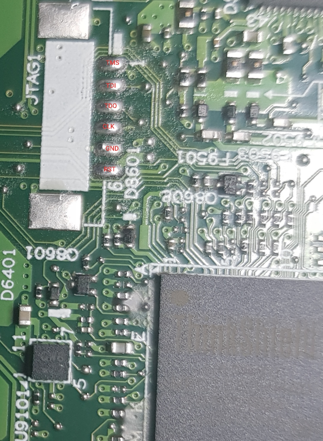

                    • black0hackers
                      • Jul 2020
                      • 365
                      Where is point to connect?
                      picture add of T490S
                      • AAAC
                        • Jan 2020
                        • 458
                        • Mexico

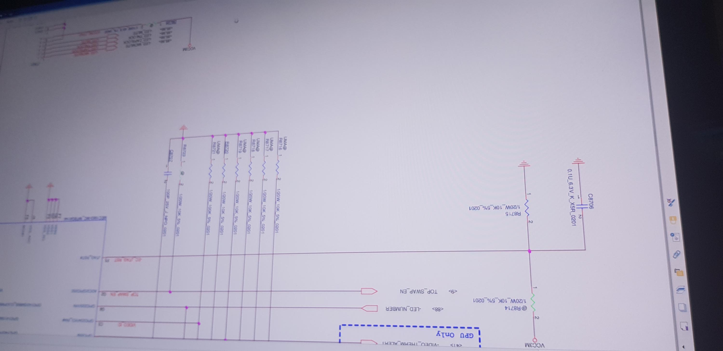

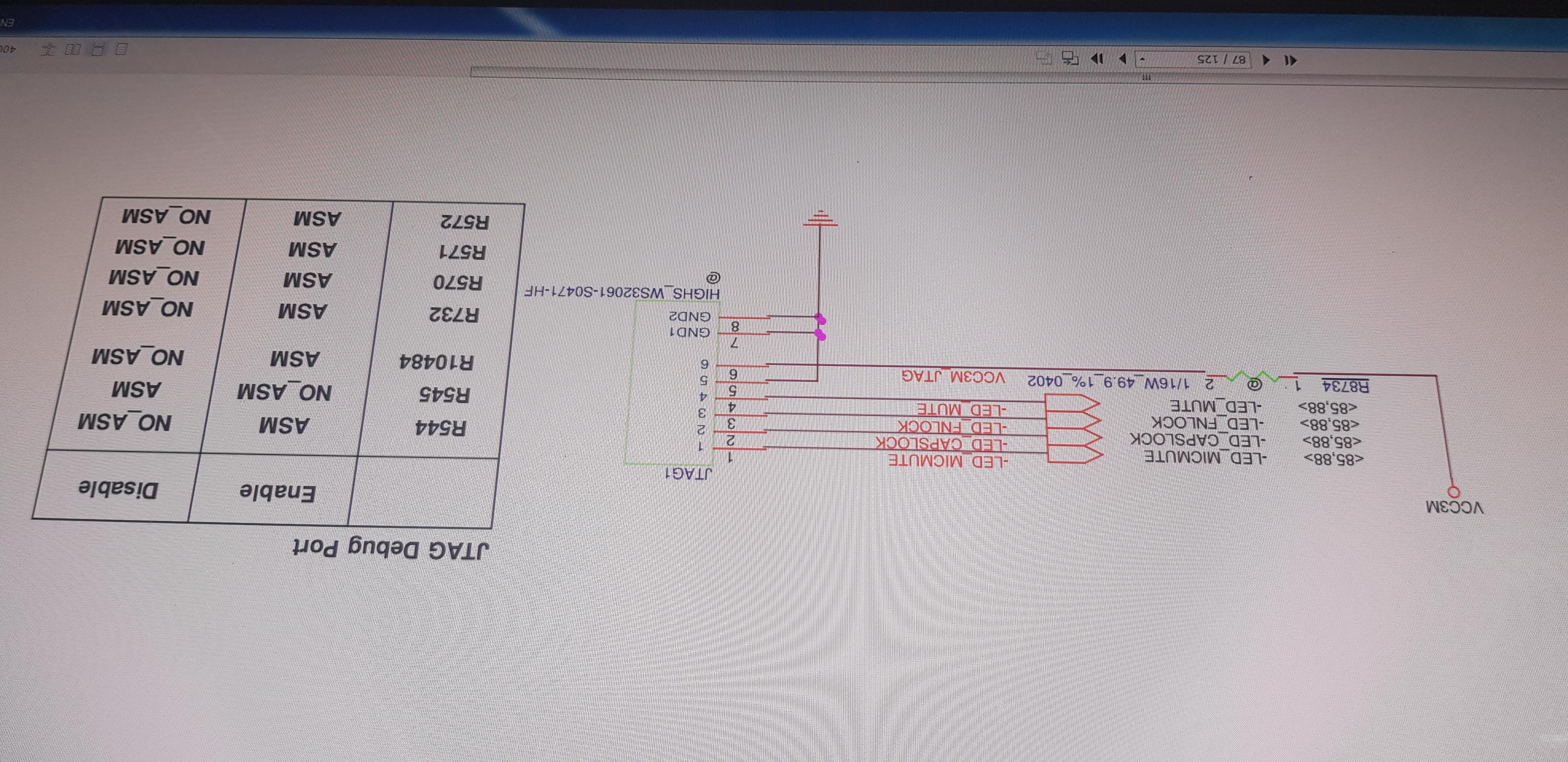

                        @black0hackers
                        Upload another picture of complete motherboard, as most of the JTAG signals may be already in a connector pads.
                        • So the JTAG signal wires will need to be soldered to this connector pads.
                        • You will need to move a very tiny PULL-UP resistor and make it a PULL-DOWN resistor to enable JTAG interface.
                        • Then you will need to locate RST# signal somewhere around MECxxxx chip by looking at schematic for this T490S, or by looking at another model schematic that uses the same MECxxxx chip part number (although I've read that this signal is not needed, someone with more JTAG experience may confirm/deny this).

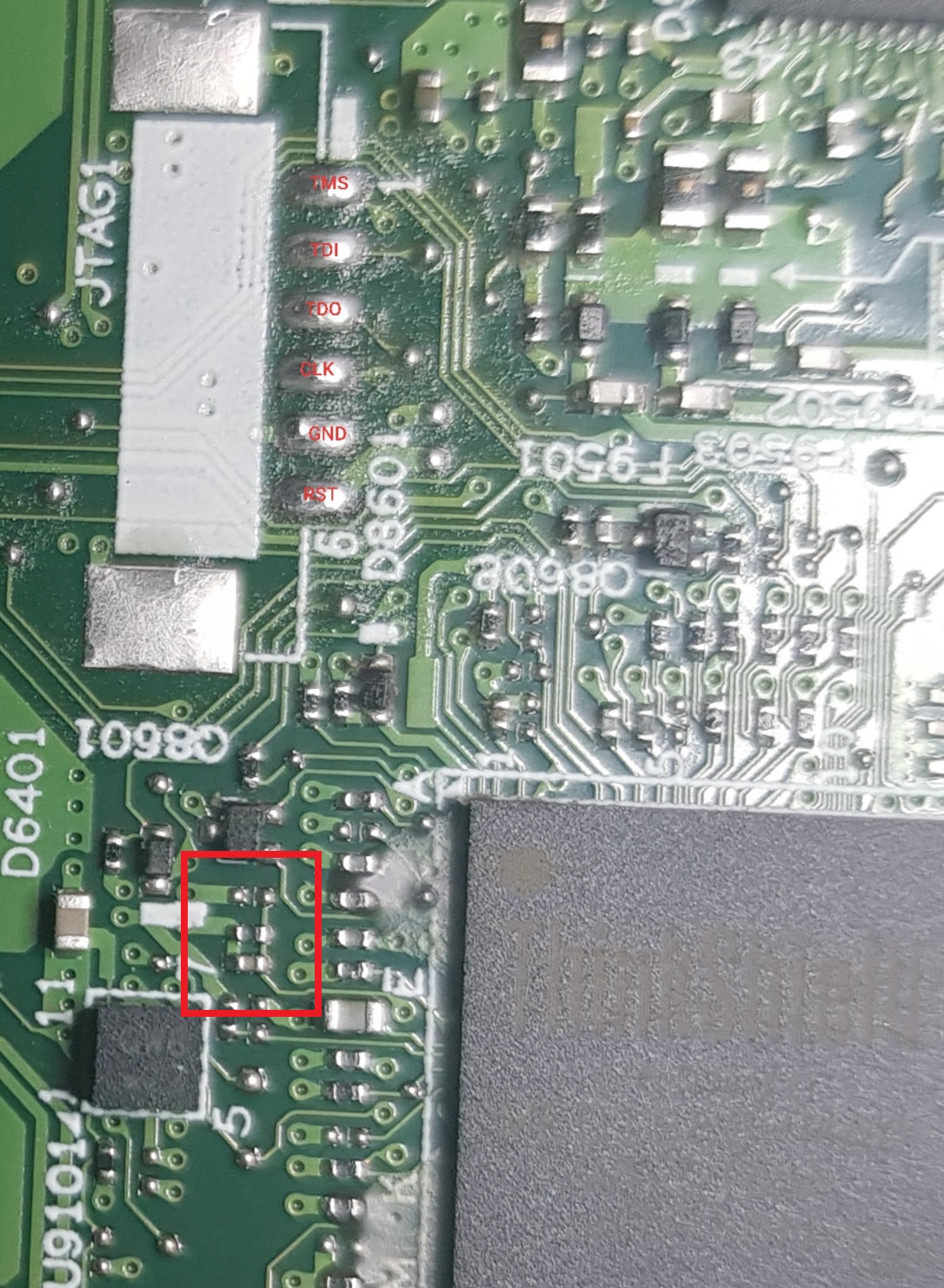

                          There is a photo t490 jtag1 and pins ,can someone draw the connection ?
                          • RethoricalCheese
                            • Mar 2013
                            • 1518
                            • Estonia
                            Looks like JTAG reset resistor is marked in red box. Move the resistor next to that capacitor on the empty pads.
                            I will test it tomorrow.
                            • RethoricalCheese
                              • Mar 2013
                              • 1518
                              • Estonia
                              The resistor in my last picture was indeed correct. I can read/write MEC now.
                              The problem is, looks like my SAS JIG (which doesnt have MEC1663 in support list) is not able to clear the write-only area for some reason. What programmer should be used?

                                • AAAC
                                  • Jan 2020
                                  • 458
                                  • Mexico
                                  @RethoricalCheese
                                  In your last post you mention you can read/write MEC now, but you describe your problem as is not able to clear the write-only area... have you tried to disconnect all sources of energy for 2-3 minutes? seems like this area is temporarily copied to volatile memory too (ram), so removing energy for a couple of minutes will do the trick.
                                  After this you will have to use Lenovo UEFI Maintenance utility to write Model Number, Serial Number, TYPE and other data for ThinkPad to be left as it was before programming MEC chip.

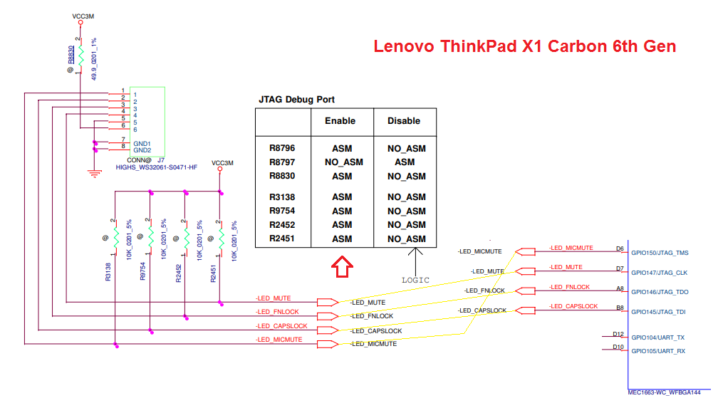

                                        @keczuk
                                        Upload a picture of your setup. Have you added PULL-UP resistors to JTAG signals.
                                        At the time we did this one we couldn't find a schematic for T490, but X1 Carbon 6th Gen (T480s and others) have same MEC1663 EC/KBC chip so we used them as reference.
