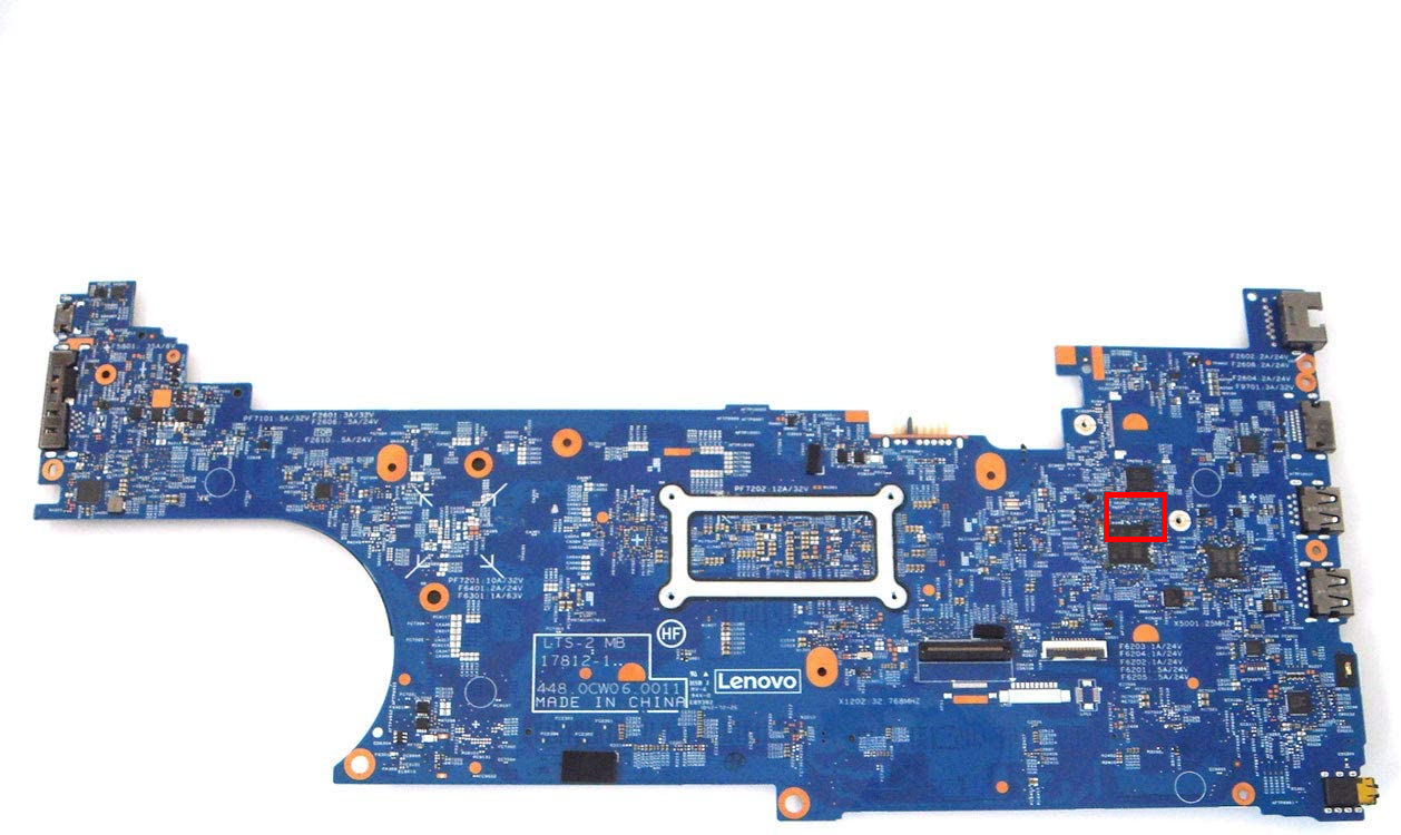

    Originally posted by exe557
    This resistor needs to be moved from red to yellow position.
    If you cannot read after that, chip is locked. Just write extracted dump from bios update and it will be ok
    do i leave my jumper in place?
    • coolshrimp
      • Nov 2016
      • 54
      #282
      Re: mec 16xx dump with info block
      No luck do I remove both resistors?
      Seems red line and resistor bellow it both bridge the same trace.

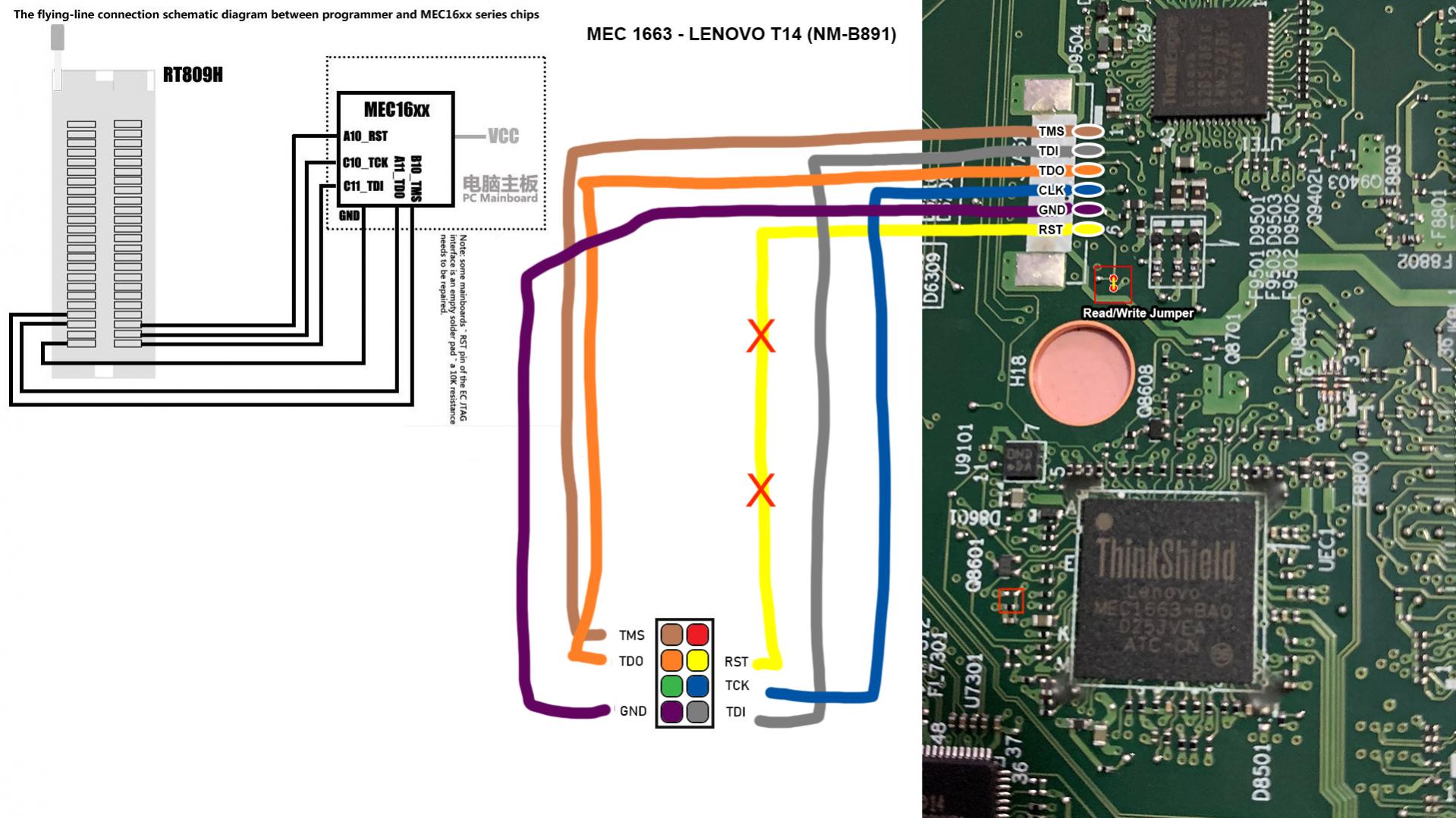

      • exe557
        • Jan 2021
        • 24
        #283
        The resistor will be on the red marked one and act as PULL UP resistor. You need to move it from red position to yellow to make it PULL DOWN.
        Not remove it!
        • volinakis
          • Jan 2021
          • 2745
          • N/A
          #284
          exe557 is right. Remove RST wire from JTAG connector, put pull up resistor in the place he indicated, choose MEC1633 in RT809H, plug in AC adapter then you can read MEC. After you read it hit erase, unplug ac adapter, leave it 1-2mins, plug in again ac adapter and write back the dump you saved. Then put back pull up resistor. You have all this infos here if you bother to read it.
          • coolshrimp
            • Nov 2016
            • 54
            #285
            Ok Iv done that and still won’t read.
            I tried erase as well it also just gives same chip error 0xFFFFFF.
            Rst wire removed.
            Pads (1-5) connected to RT809h (no resistors inline)
            Moved red resistor to yellow position
            Board is powered (leds on and I read 3.3v on pad 6)
            I also read ever post in the thread and tried all and nothing has worked so far on this stubborn chip.

                  Ok now that that is solved ill share my diagram and instructions.
                  T14s - MEC-1663 - Jtag - Pinout - Bios Password Removal
                  Now next issue setting Serial / Model / Etc.

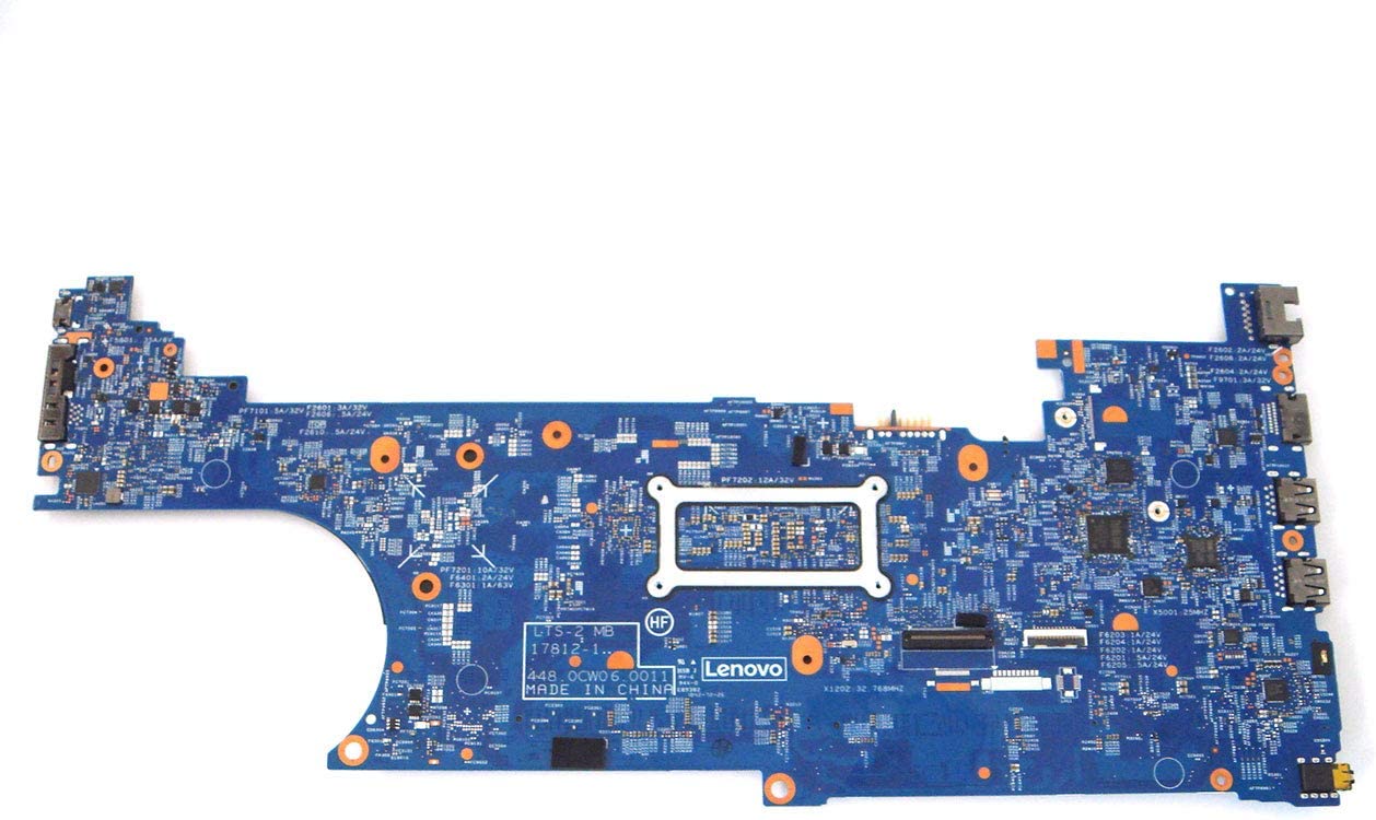

                            • mesdova
                              • Oct 2015
                              • 24
                              • algeria
                              #294

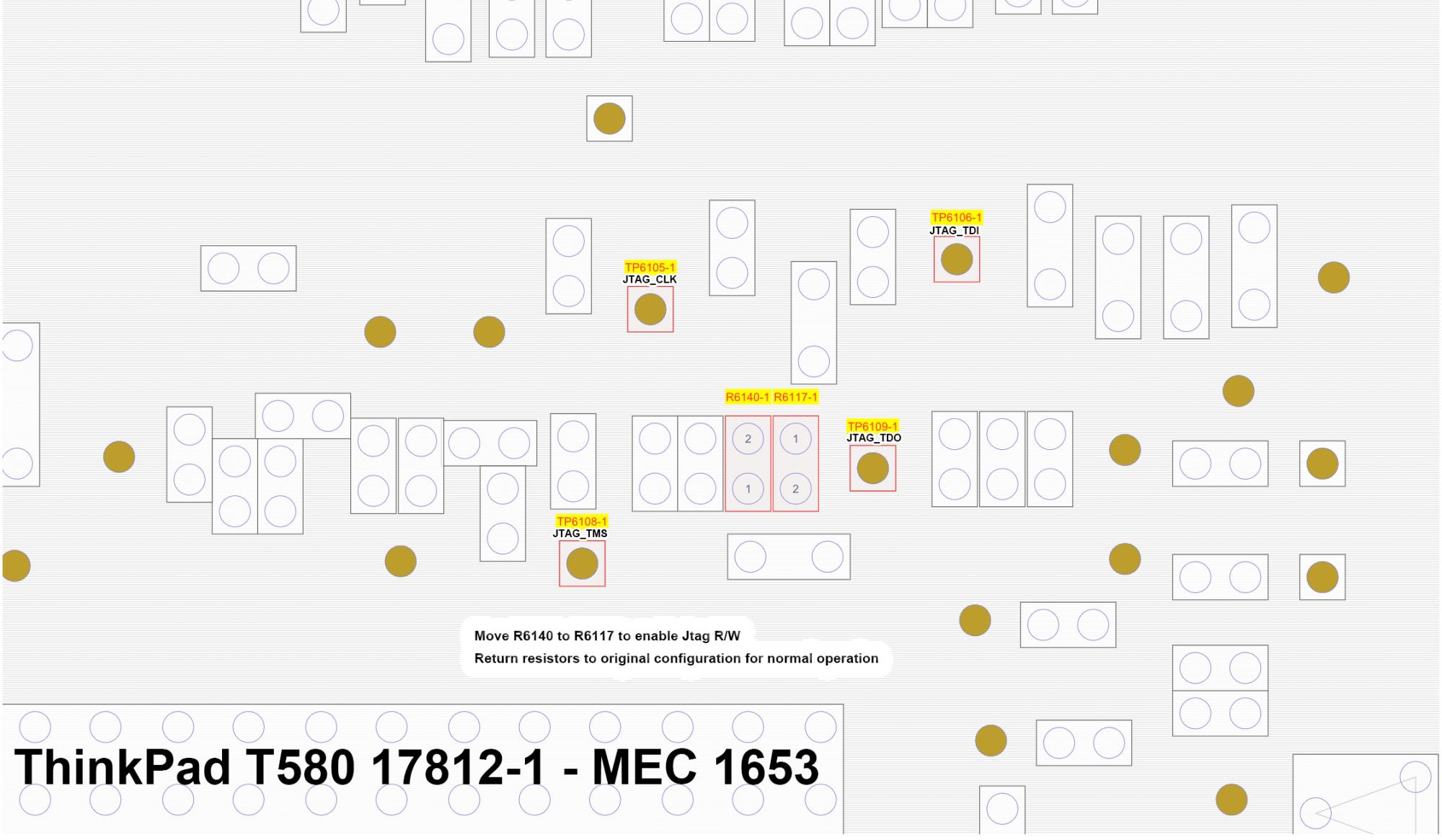

                              NEED THE PIN conect JTAG MEC-1653 T580
                              ThinkPad T580 17812-1
                              448.0CW18.0011

                                  #296
                                  Because I placed a new EC MEC1653 And I wante to reprogram it

                                    #297
                                    448.0CW18.0011

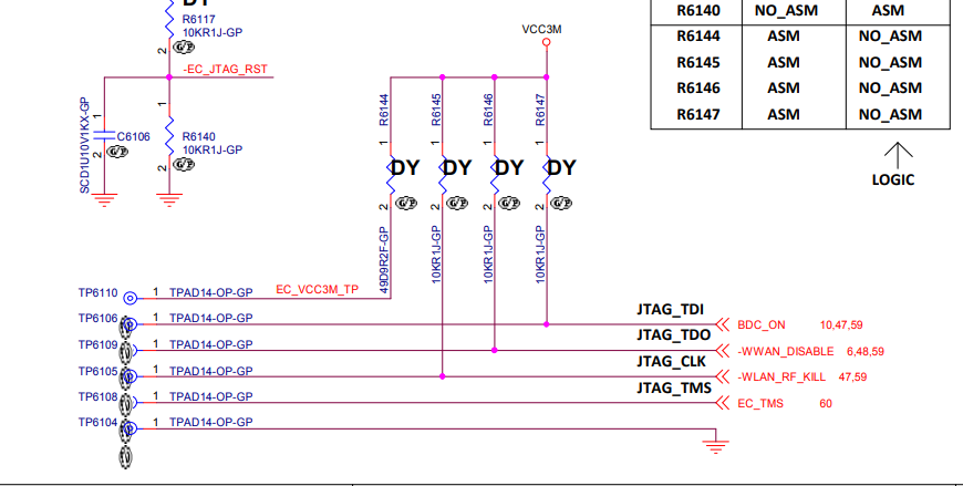

                                    Here is the boardview and schematics.
                                    https://www.badcaps.net/forum/showthread.php?t=104317
                                    If you're not sure how to figure out with the files above let me know I could take a few min and figure it out for you.
                                          448.0CW18.0011
                                          Move Resistor R6140 to R6117 to enable Jtag R/W.
                                          Return resistors to original configuration for normal operation.
