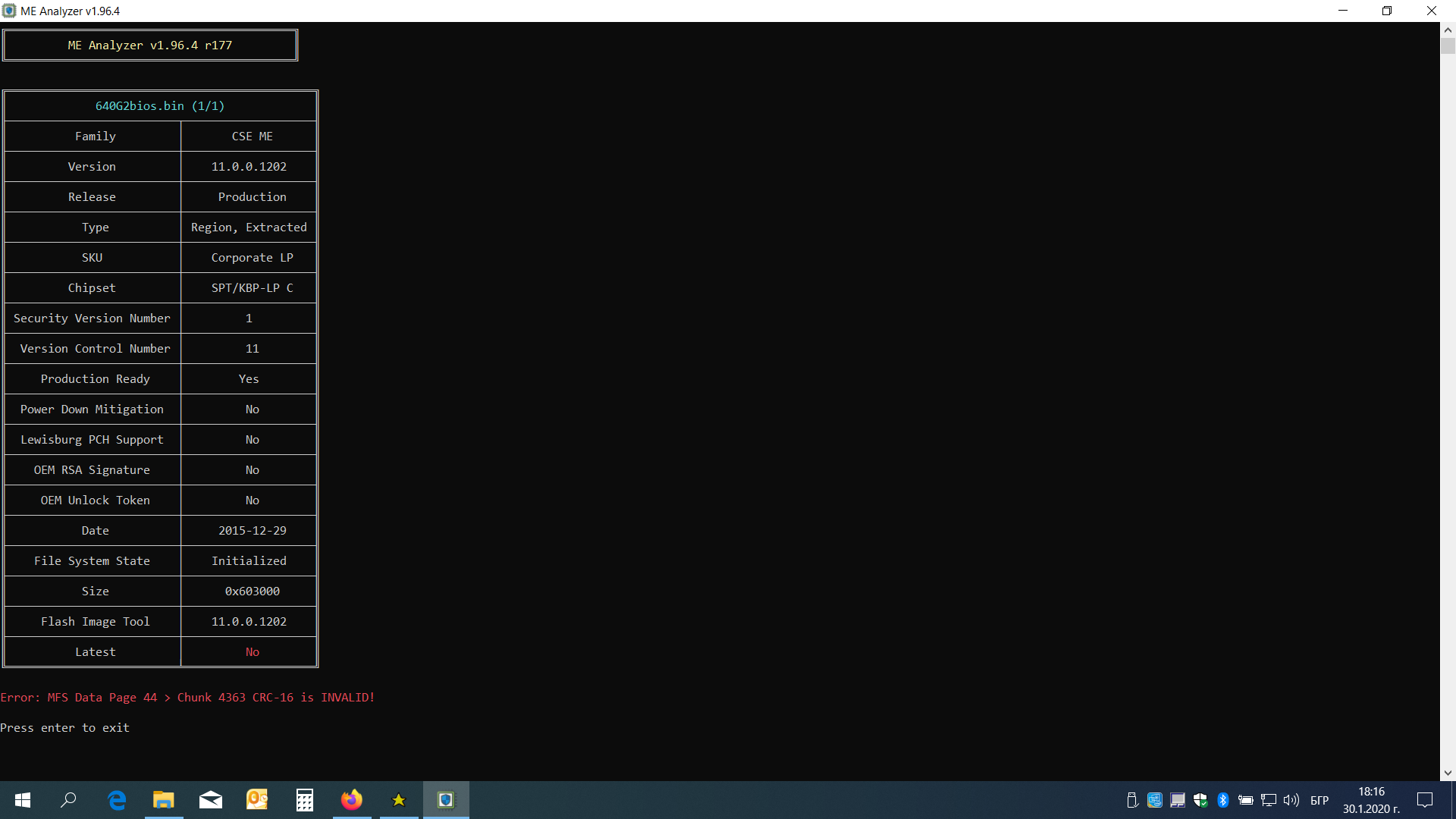

    Re: hp Probook 640 g2 bios password
    Originally posted by SMDFlea
    The ME firmware in your bios was corrupt.Try this bios with your pass removed and new ME firmware .
    Probably the chip was not read correctly, and the dump posted by theGenova is corrupted.
    Yes indeed, just checked the file too:

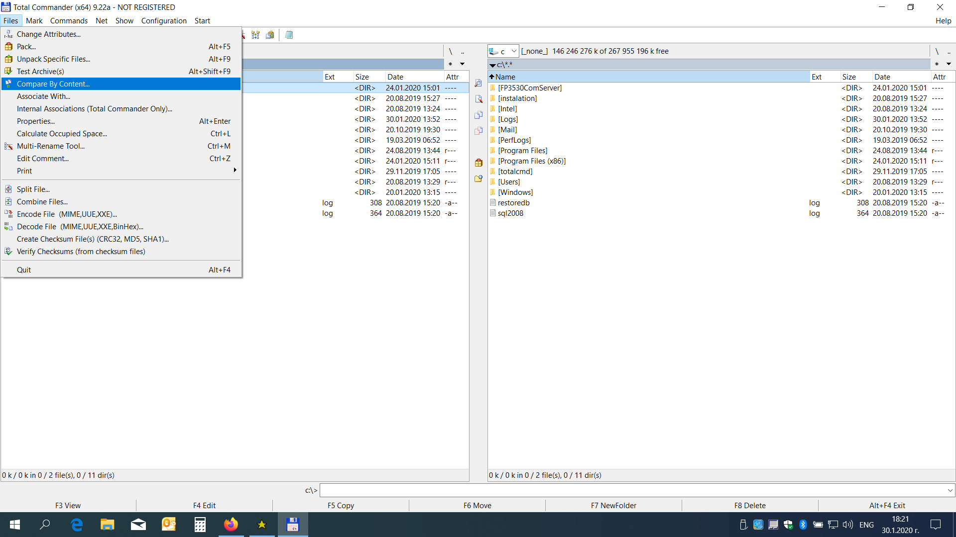

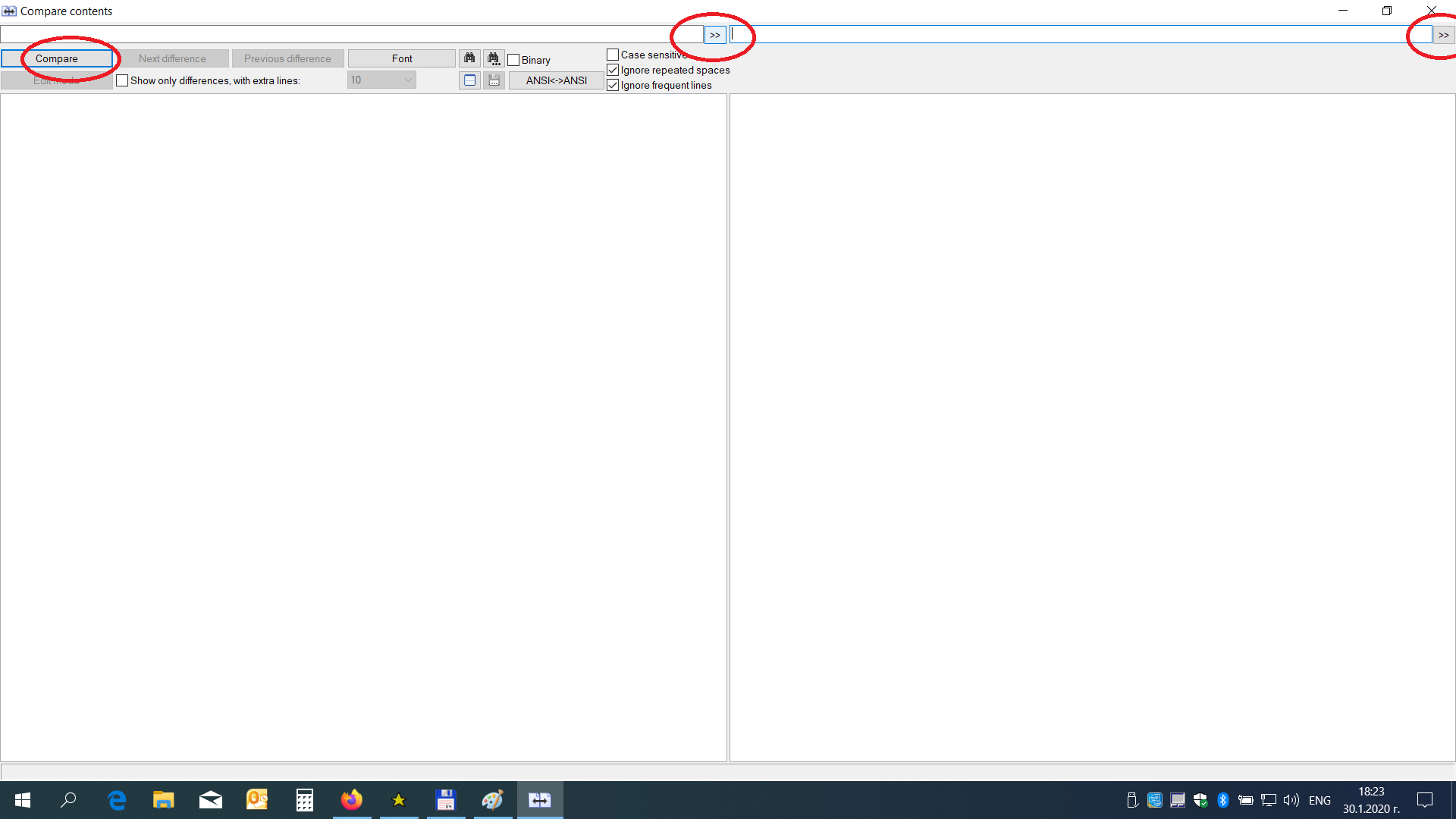

        Originally posted by Genova
        How can i read in total commander the content of the chip ??
        Check the pictures:

          #64
          Originally posted by Vesko356
          Check the pictures:
          So after programming the file 640G2_ME CLEAN into the bios i need to save the the bios to a new file to compare ?
          • Vesko356
            VIP Moderator
            • Aug 2018
            • 4386
            • Bulgaria šŸ‡§šŸ‡¬
            #65
            After programming just close the AsProgrammer, open the program again, read the content of the chip, save the file as let's say TEST.bin, then compare the TEST.bin with the 640G2_ME CLEAN.bin with the Total Commander.

            • Genova
              • Jan 2020
              • 116
              • FRANCE
              #66
              The two files are identical

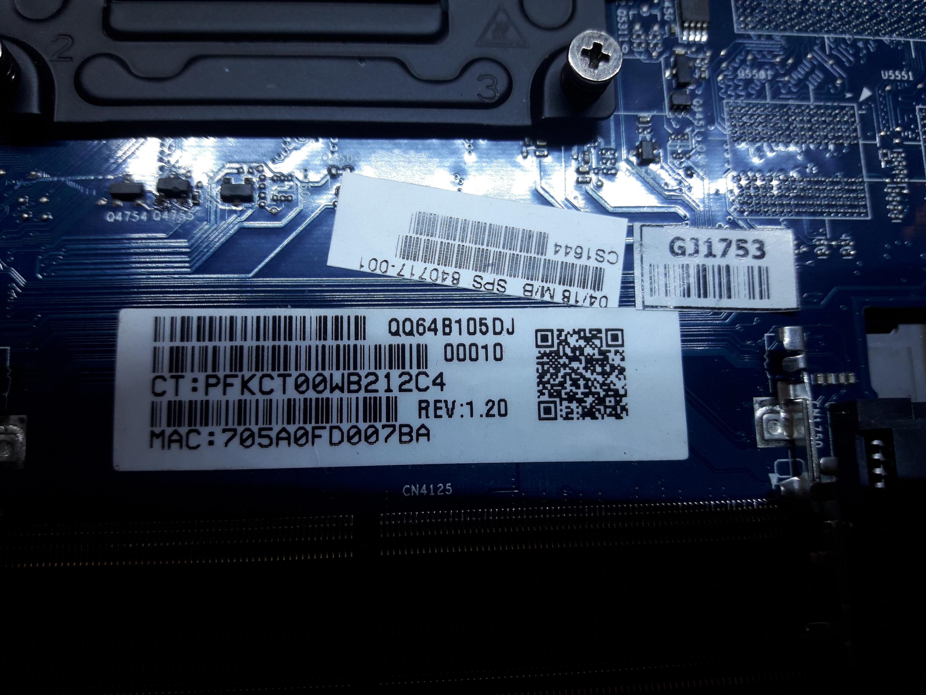

                        • damian13030
                          • Mar 2020
                          • 10
                          • Polska
                          #72
                          Re: hp 640 g2 need bios dump
                          Hello I have HP probook 640g2, (i5 6300) I have fault 3/2 and 2/2 (bios) .Will the other bios from the posts above work?

                              #74
                              Someone has already soldered, I don't know if it is original.

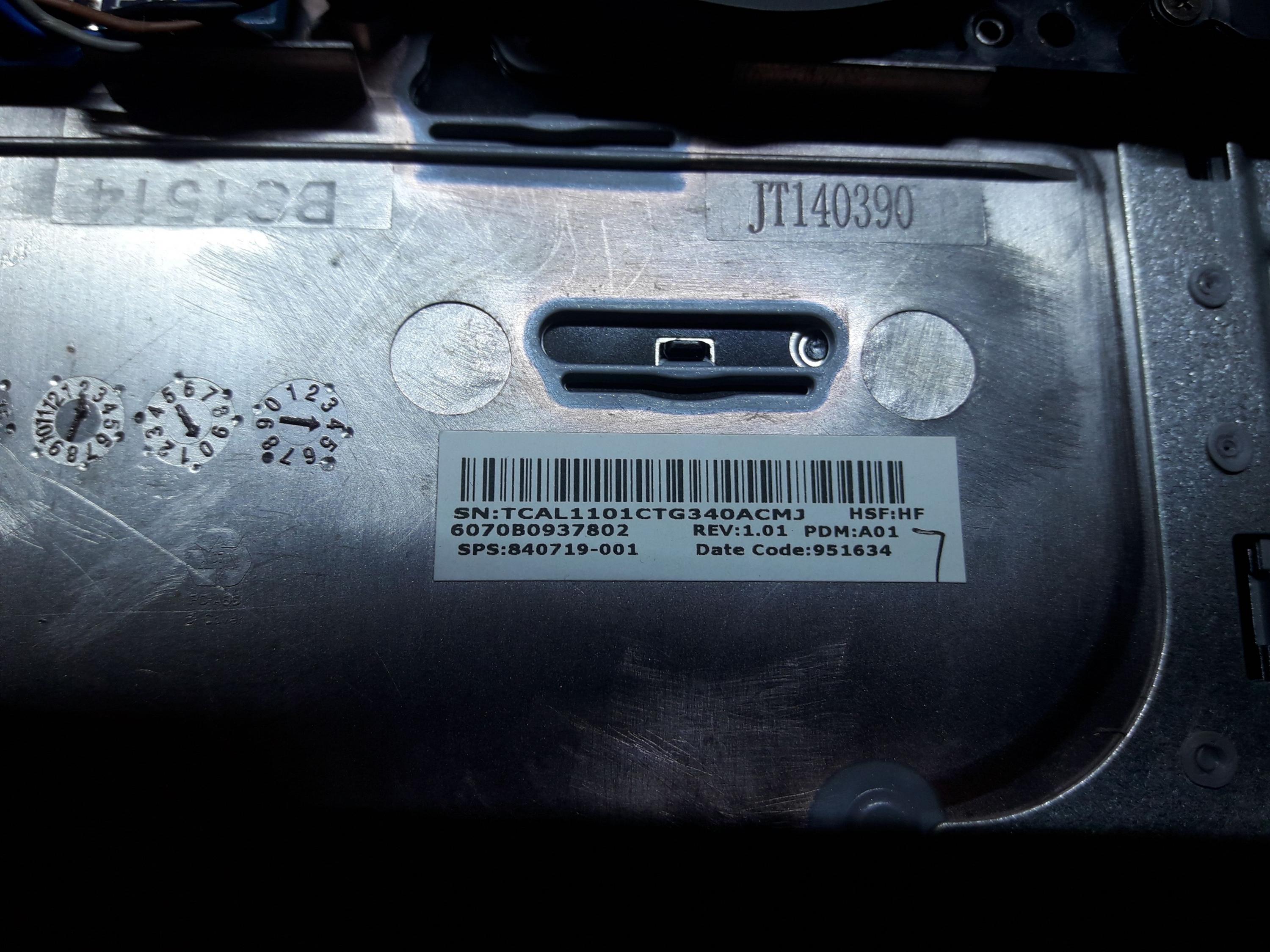

                                        • 20792
                                        #79
                                        Originally posted by damian13030
                                        not work.
                                        Can you post a picture of the serial number on the base cover sticker, or write it here.
                                        • damian13030
                                          • Mar 2020
                                          • 10
                                          • Polska
                                          #80
                                          Stickers in motherboard
