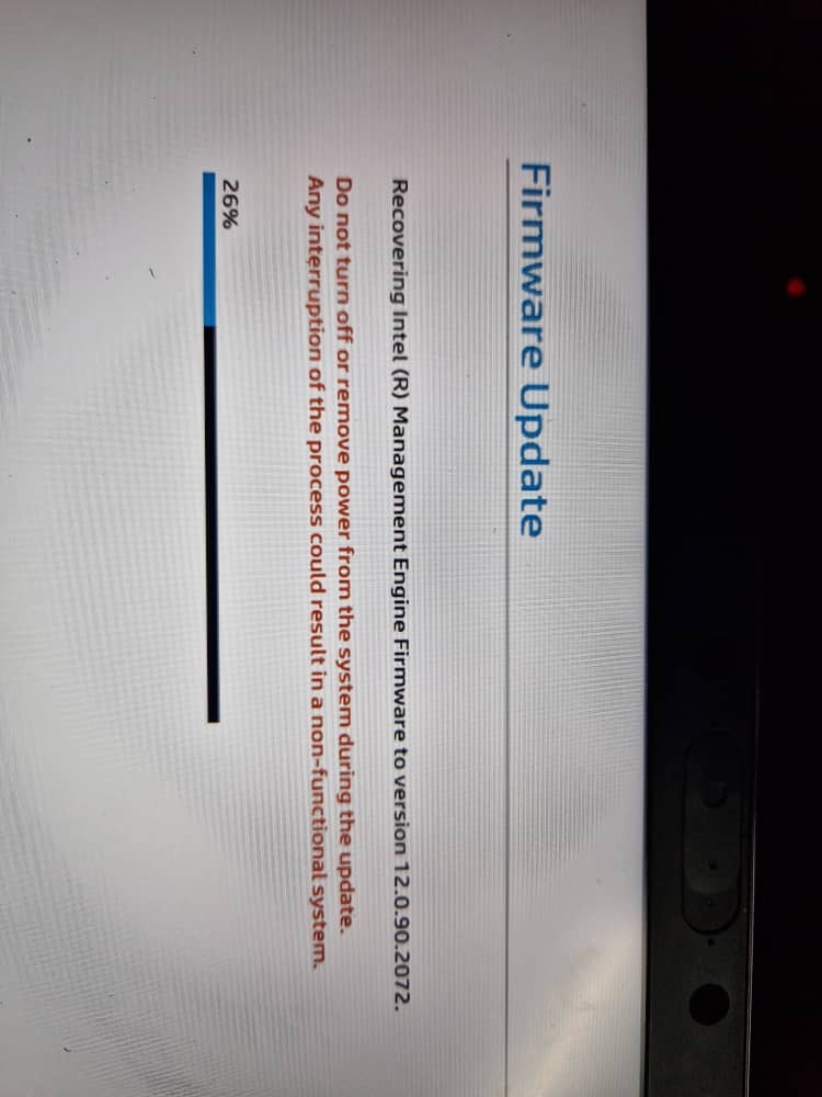

      Hello to all I have hp 840 g6 6050A3022501-MB-A01, bios was password locked I already tried to reprogram bios chip with some bios that I found for this model, I'm a beginner trying to learn, but I messed up it must be something that I did wrong cose now every time when boot the nosy speaker loudly beep and a message appears Endpoint security controller problem and don't know how to remove that, this is beyond my comprehension please kind people any help would be appreciated thank you
      here are my original bios files
      SN# 5CG0310XMB
      if i miss something please tell me
      • Vesko356
        VIP Moderator
        • Aug 2018
        • 4386
        • Bulgaria 🇧🇬
        #365
        SN# 5CG0310XMB
        Flash 16MB chip with the attached below dump, program back 32MB with the original unmodified dump.
        Memory chip must be erased before programing, use verification.
        And next time ask first and then act, not the other way around​.

        #366
        Hello everyone, please repair my original bios
        i have hp elitebook 840-G6
        serial number :5CG9437H8
        mainboard code :CRESCENT-6050A3022501-MB-A01
        condition cant start .
        i flash bios from this tread and another site, can start but have warning HP ENDPOINT SECURITY CONTROLLER PROBLEM and slow display.
        please help to solve my problem.
        thanks for support
        i uploaded my original bios not start 👇

            Flash this main. i check with me analyzer your ME region is Corrupt. i clearme your bin.
                hello rex98 thanks for help
                i flash bios and your ec bios ,no luck same warning HP ENDPOINT SECURITY

                  #372
                  flash this main U365 BB NOT START Clearme.rar (10.71 MB and also this EC fix.​

                    #373
                    Hello rex98
                    thank you very much for your help
                    bios clear 365 and bios fix 366 work perfect, no warning and fast display
                    thankss
                    my question : how do you fix my bios ?

                        #375
                        Hello rex98
                        thankss
                        i just clearme your main bios and fill with ff in hex editor the offset 00037000 to 00037588 in EC.
