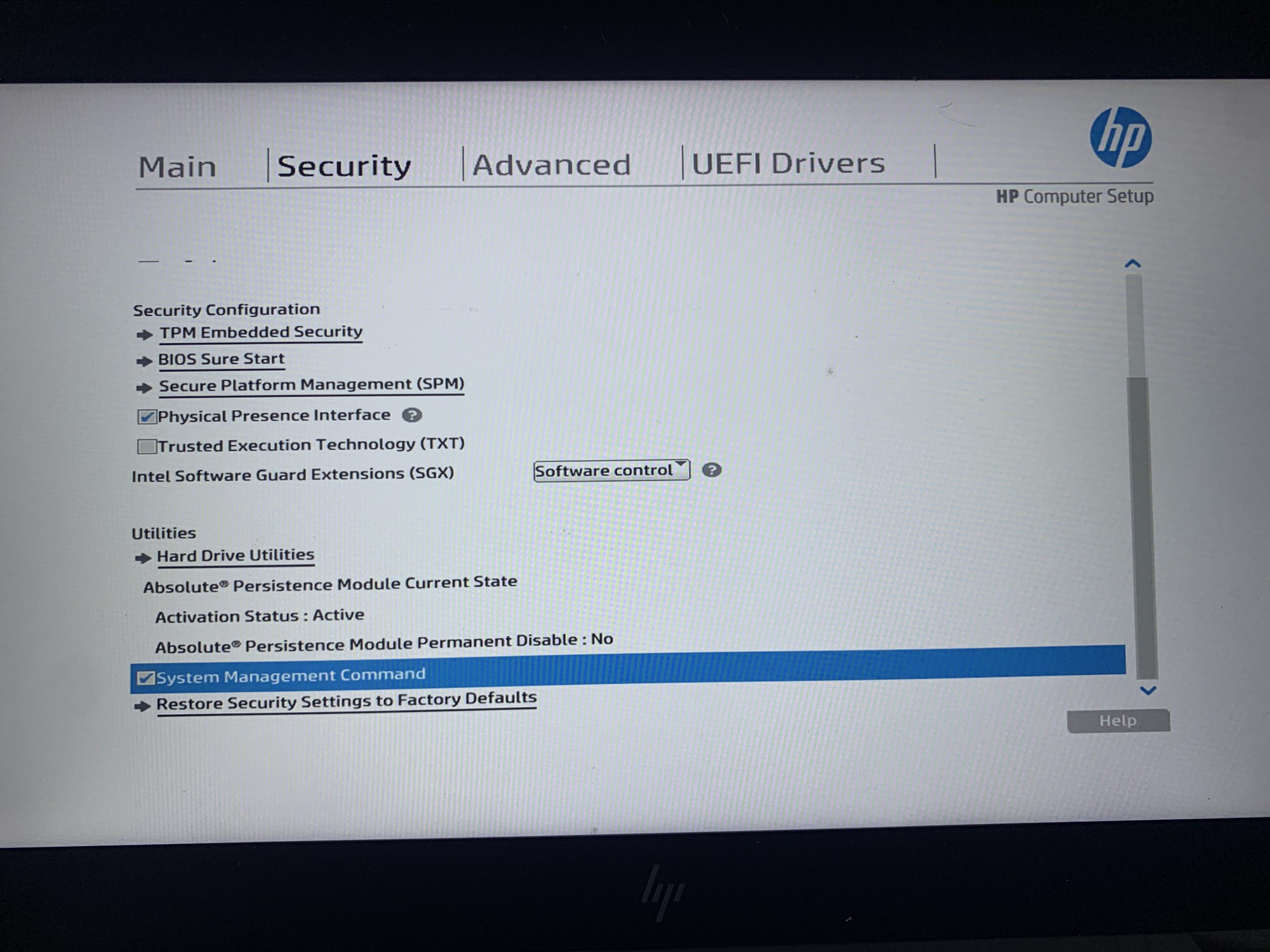

                          • Stunt
                            • Oct 2019
                            • 203
                            • South Africa
                            #333
                            Re: hp 840 g6 6050A3022501-MB-A01
                            Originally posted by Vesko356
                            Password removal by laptop brand:
                            https://www.badcaps.net/forum/showpo...42&postcount=4
                            3.6. HP
                            Hi guys i've managed to remove password on my bios.
                            But now i'm stuck with computrace i will appreciate if anybody is willing to help me remove it. Thanks in advance

                              #334
                              Upload a screenshot from the bios, also from the popup Computrace freeze screen.

                                #335
                                there is screenshot

                                  #336
                                  there is screenshot
                                  Did you restore security settings to factory default? If not, do it to see if anything changes.

                                    #337
                                    I did restore security settings to factory default but still the same

                                      #338
                                      Ready Bro falsh, and give me the result.

                                        #339
                                        Thanks now everything it's fine. I really appreciate your time
