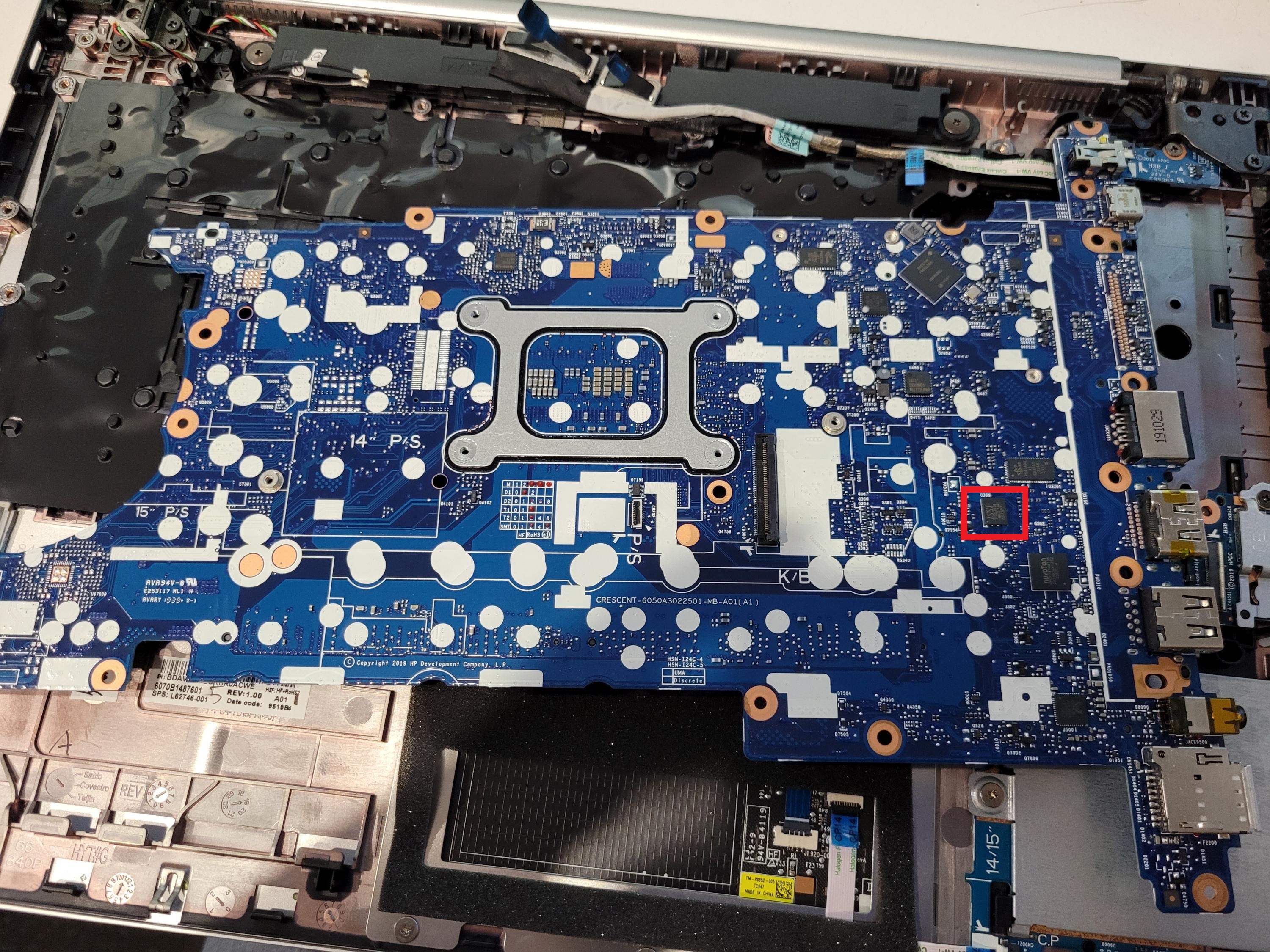

                I searched for another bios chip ,but it has only this one 32mb

                  #148
                  Re: hp 840 g6 6050A3022501-MB-A01
                  Look more carefully
                  U366...

                  • elbtonet
                    • Nov 2019
                    • 105
                    • albania
                    #149
                    You were right my friend
                    thisis the right one i think thnks

                    • Vesko356
                      VIP Moderator
                      • Aug 2018
                      • 4386
                      • Bulgaria 🇧🇬
                      #150
                      I know.
                      Try & leave feedback (flash only 16MB chip):

                          #152
                          Originally posted by Vesko356
                          I know.
                          Hi VESKO ..writed down the bin on my 16mb chip but it doesnt turn on the lapt at all... any idea

                            #153
                            Originally posted by ace.code
                            someone pls unlock my bios
                            thnnnnx
                            Try & leave feedbaack (flash 16MB chip only):

                            • Vesko356
                              VIP Moderator
                              • Aug 2018
                              • 4386
                              • Bulgaria 🇧🇬
                              #154
                              Hmm should work, check (verify) the content of the chip, make sure both chips are soldered correctly to the booard. Check their locations have not been swapped by mistake (16MB must be on U366, 32MB must be placed on U365). Also make sure they are not soldered upside down - pin4 must be ground, pin8 must be +3.3V. Check that you have'nt (re)moved or damaged any smd component in the surrounding area!
                              If all is OK after these checks, but the laptop still does not turn ON, program both chips (or only 16MB one, if the 32MB is checked/verified and the content is the same as iinitial) again:

                              • elbtonet
                                • Nov 2019
                                • 105
                                • albania
                                #155
                                This dump u gave to me right now..worked like charm Thanks man made my day
