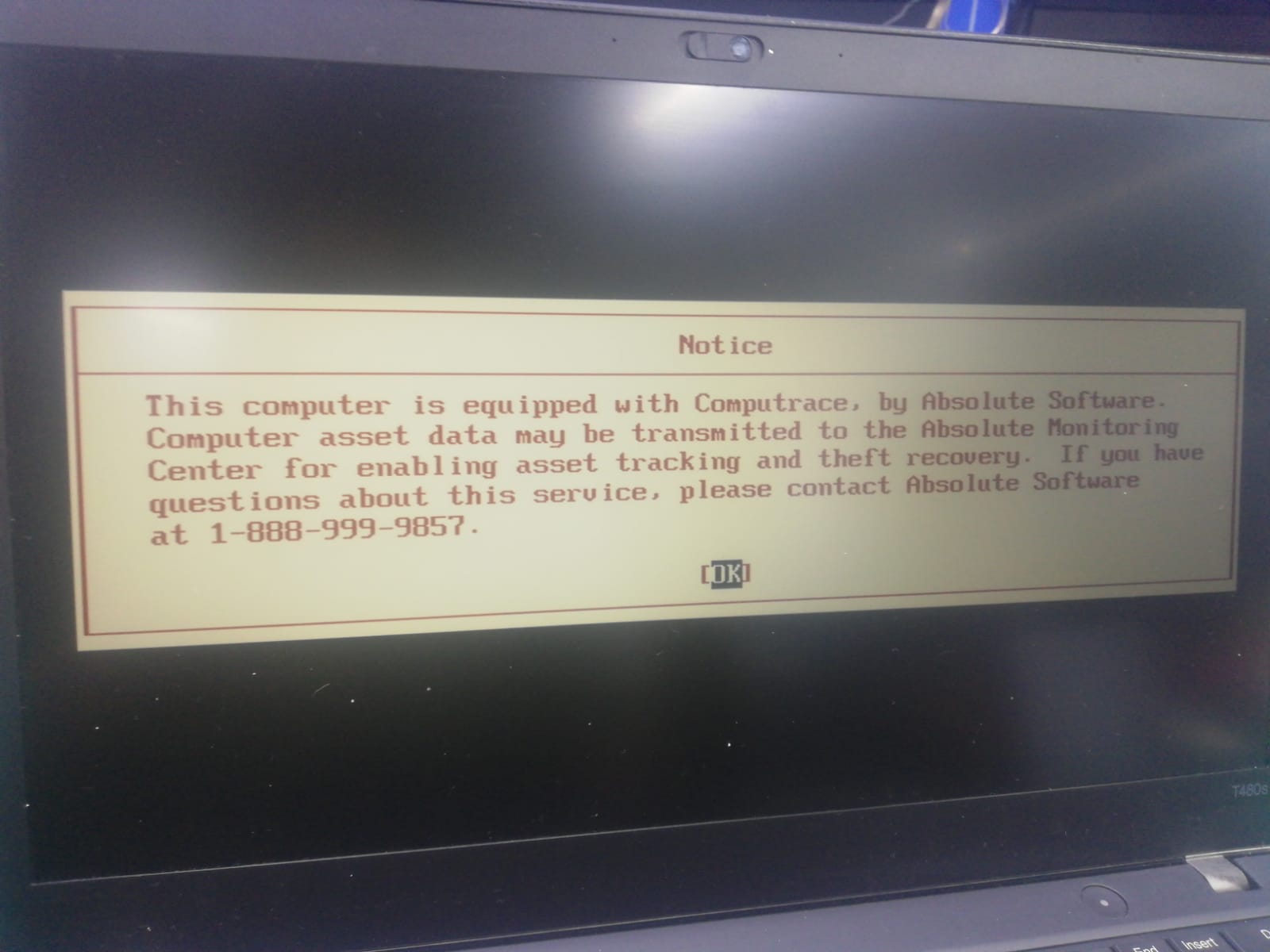

                                  Lenovo t480s bios error
                                  How to remove this error massage in bios ? Without change Service Tag.
                                  • Möppie
                                    • Aug 2022
                                    Re: Help please Lenovo T480S Bios Password
                                    You should contact Computrae, ask for delete Your computer from their list. They will contact the last (known) user. I did that once upon the time: friendly, correct and without costs.
