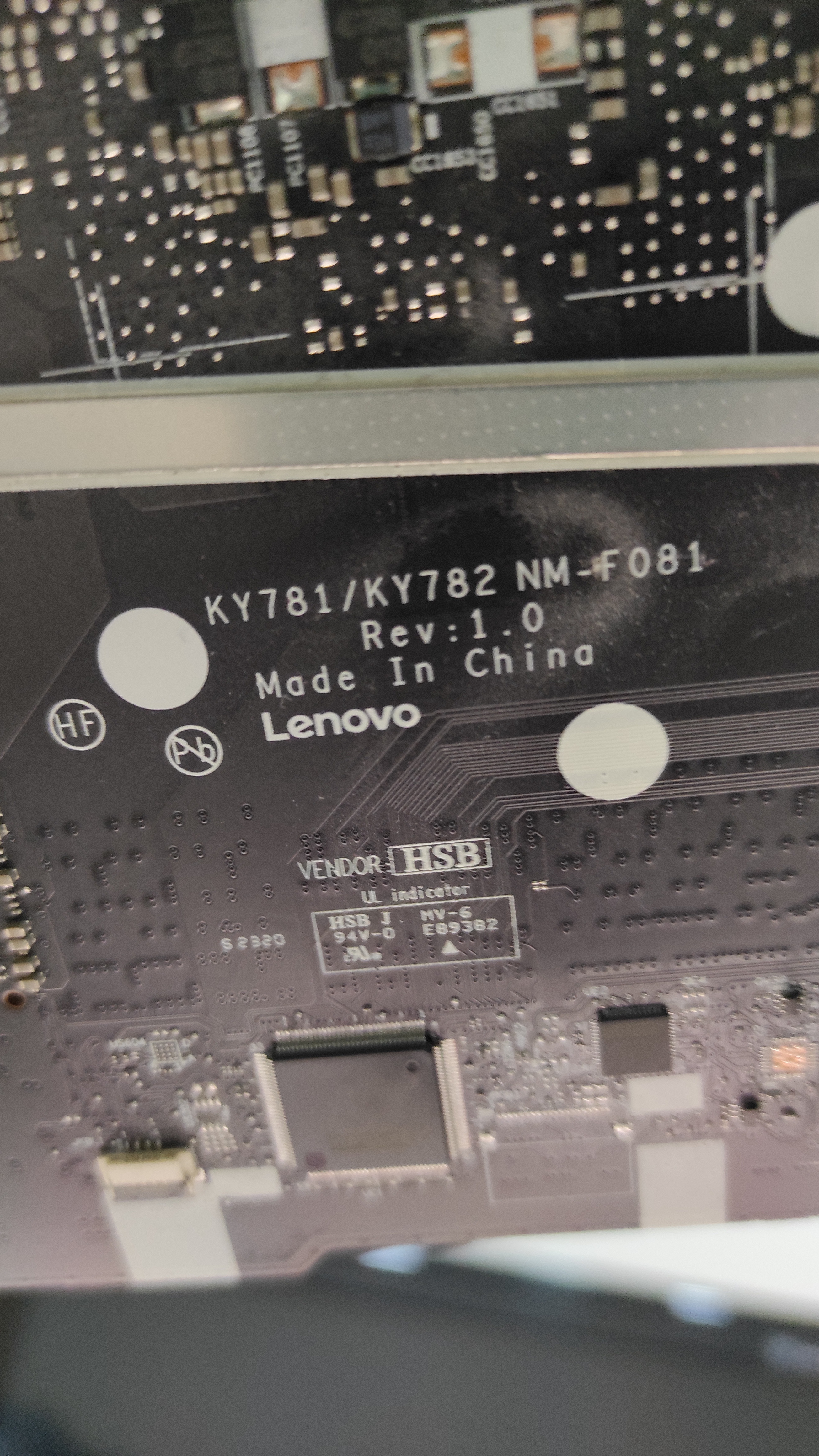

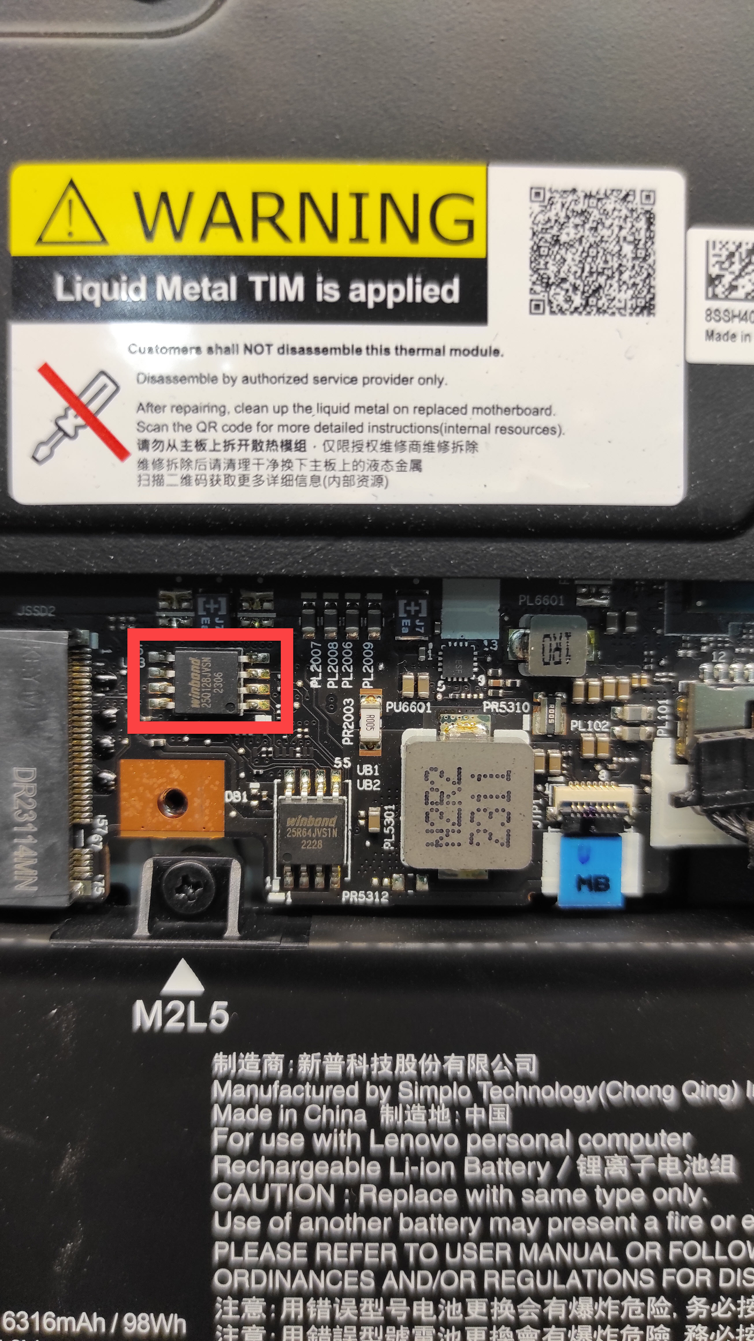

                        Hello friends! KY781/KY782 NM-F081 on this motherboard main bios chip is 25Q128JVSN ? Images attached
                        yes this 2 ic need backup
                        • 964758
                          • Jul 2017
                          • 40
                          • Georgia
                          old bios backup

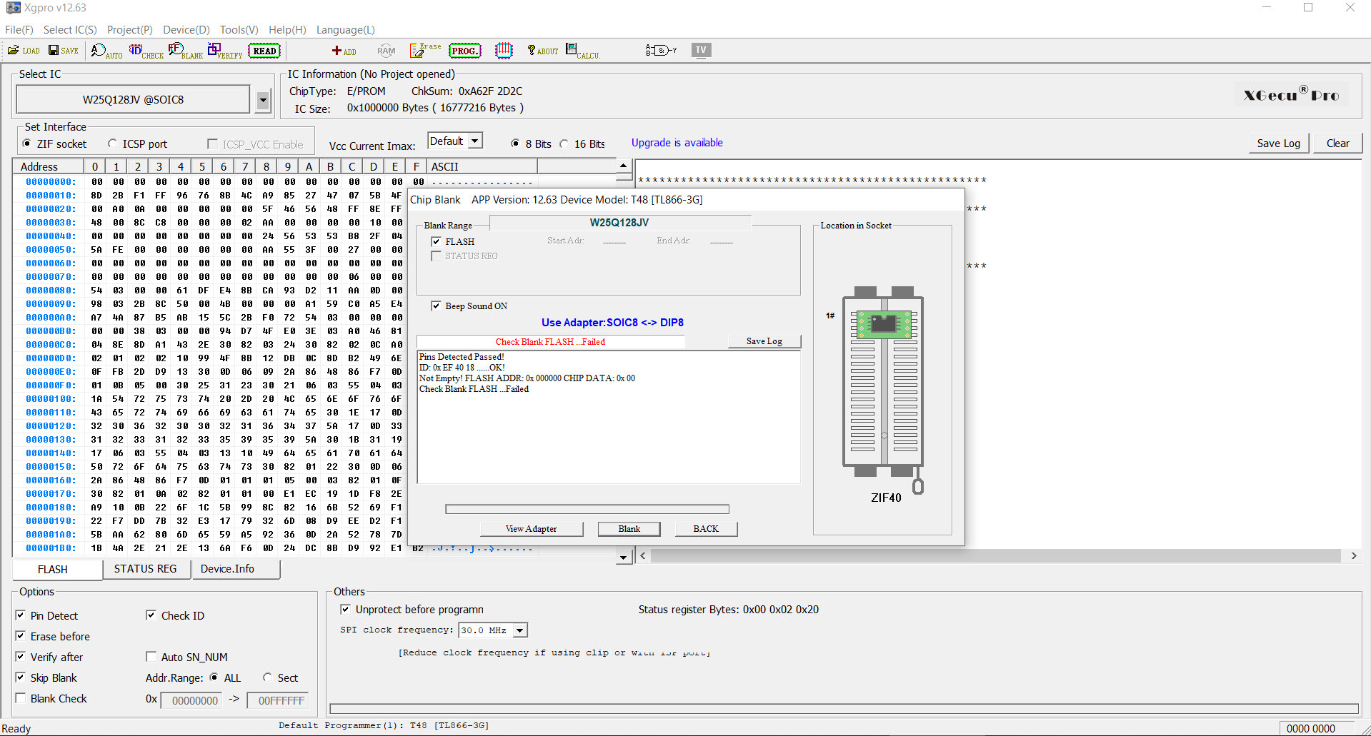

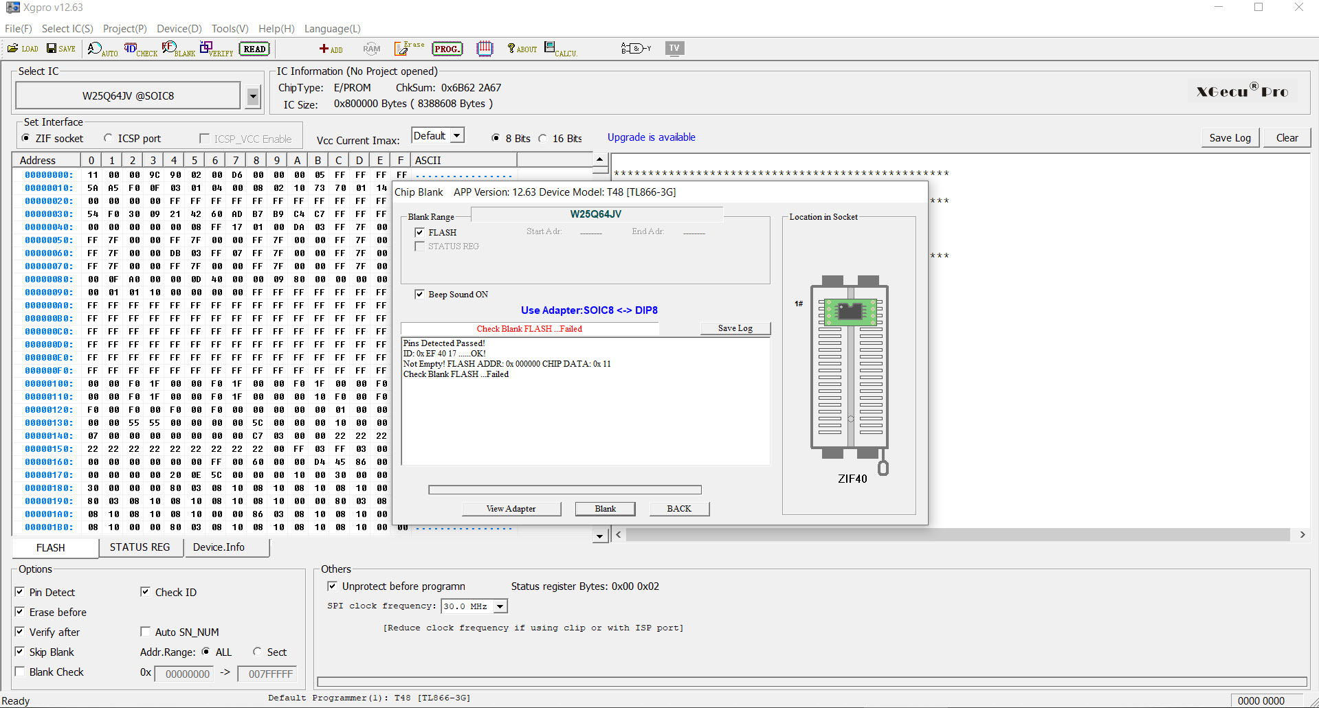

                                  The BIOS chips turned out to be non-rewritable. I need to order new ones. Thanks for your help
                                    hi try both file and feedback not dmi add
                                    • 964758
                                      • Jul 2017
                                      • 40
                                      • Georgia
                                      Hello. I can't to blank it
