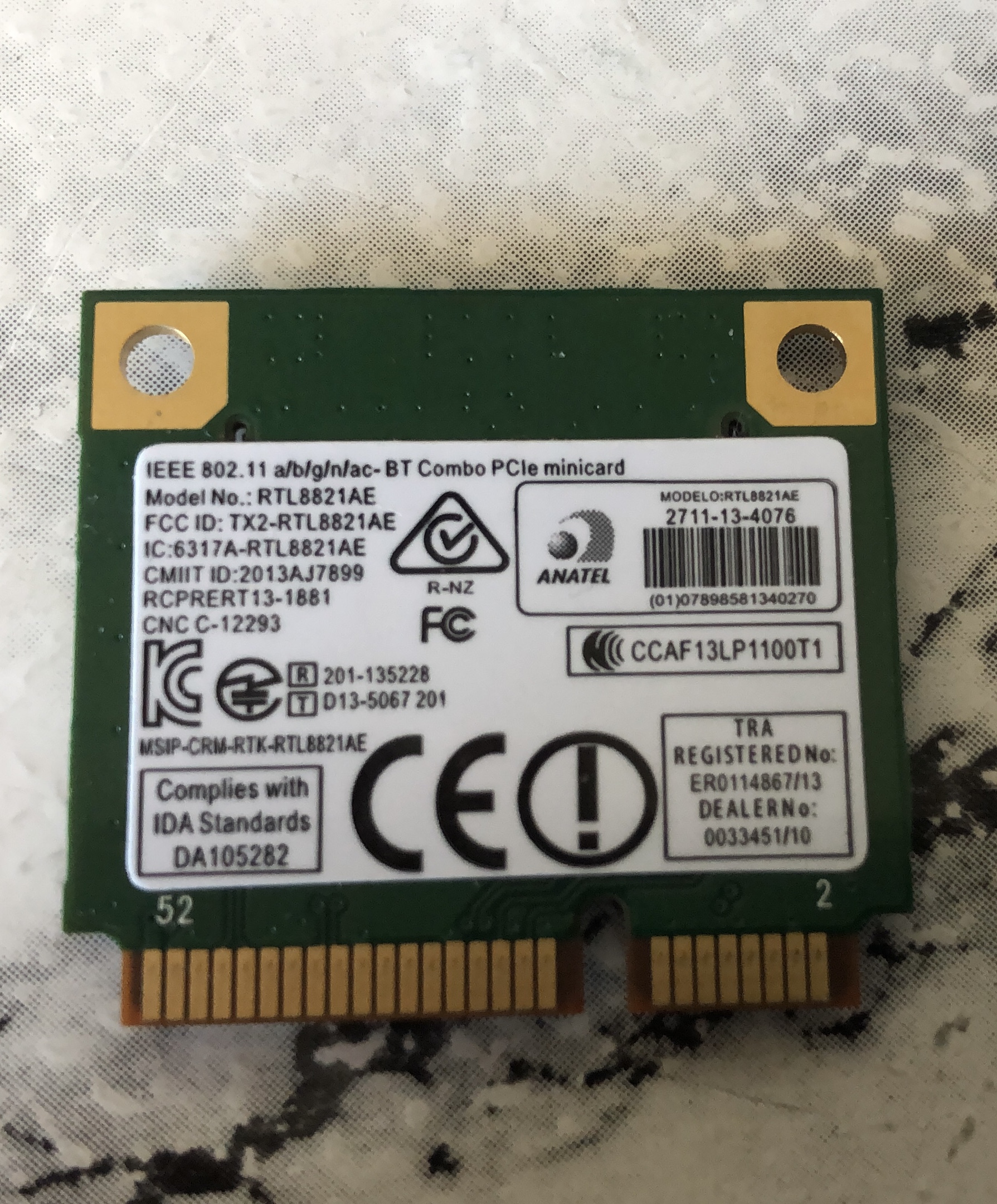

                                It's running but found out another problem:
                                I replaced HUB on ASUS main MB1504 (201) X550VX with i7.
                                And put RTL8821AE wifi module (I attached it. It is ANATEL Combo module) from the same MB1302 (202) X550VX with i5.
                                But it works only in BT mode. MAIN cannot recognise it at all.
                                So, mainboard with i7 processor wears different wifi module (only brand) but with the same RTL8821AE cheap. (I attached it. It is as a AzureWave AW-CB161H module)
                                I guess it's BIOS issue, don't it?
                                Or Is it HUB replaced problem?
                                Or must I use only the same AzureWave AW-CB161H module?
                                Is it possible to change module in BIOS?
                                Thank you for your opinion.

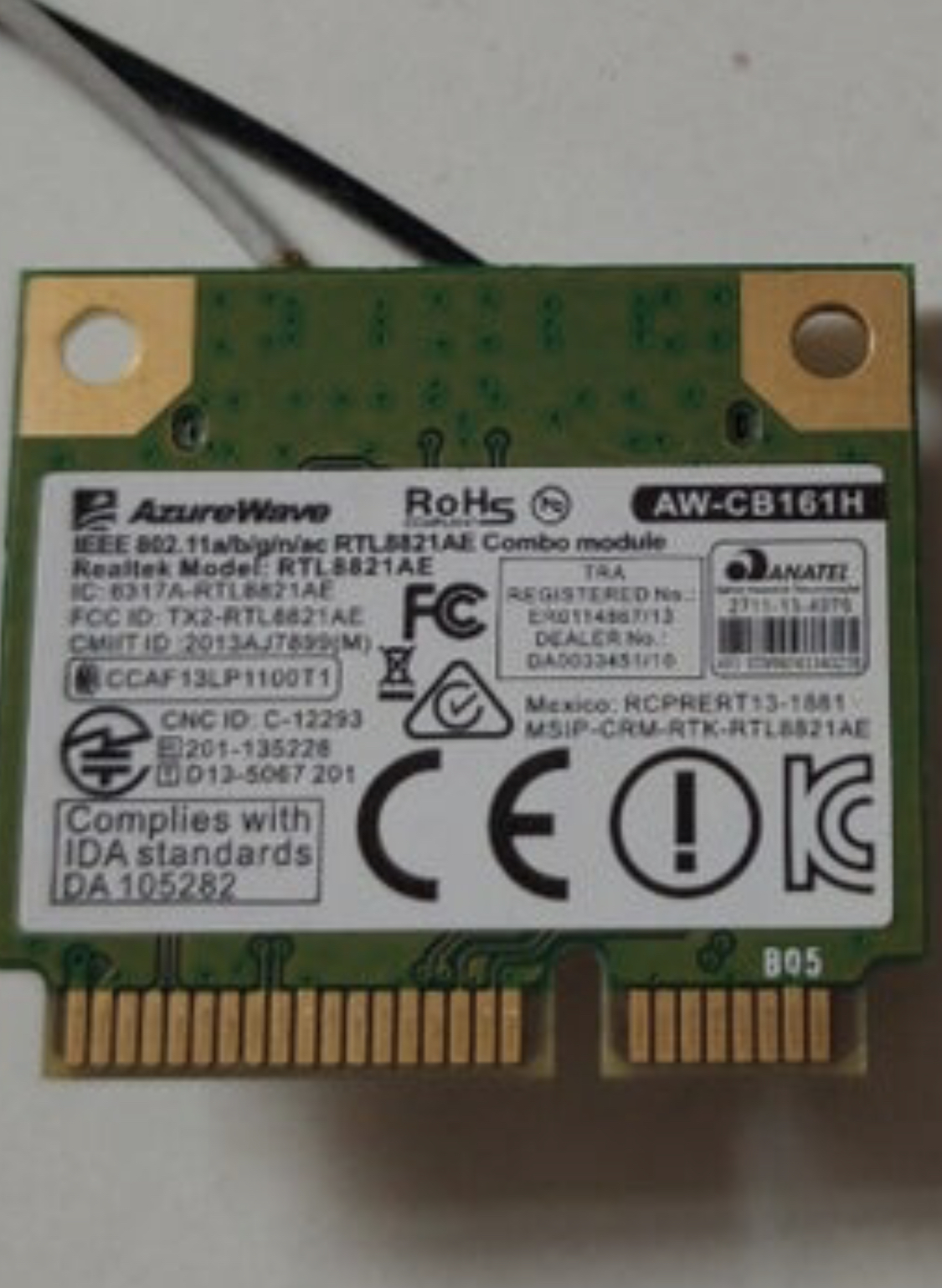

                                • AlexVG
                                  • Apr 2022
                                  • 135
                                  • SPAIN
                                  #36
                                  Re: Asus X550V (X550VX-XX057D) bios Request
                                  Hi, I bought AzureWave AW-CB161H module but it gave me nothing. It is another kind of problem(((
                                  • AlexVG
                                    • Apr 2022
                                    • 135
                                    • SPAIN
                                    #37
                                    It was HUB problem. Short circuit in HUB on lines going to AW-CB161H.
                                    I changed HUB twice and its running.
                                    Thank you.

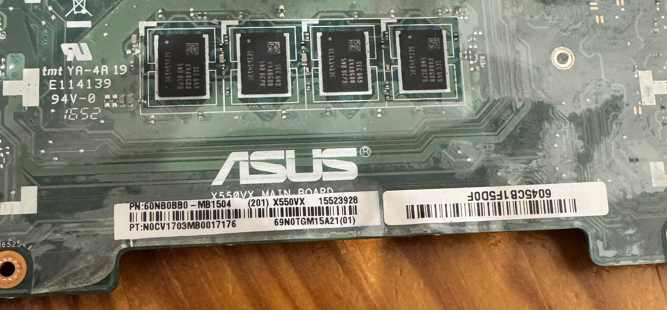

                                    • Renato Ourives
                                      • Jan 2025
                                      • 3
                                      • portugal
                                      #38
                                      Someone has the bios bin file for the ASUS (R510VX-DM236T)?
                                      MB references:
                                      PN:60NB0BB0-MB1504 (201) X550VX
                                      Thank You.

                                        • Renato Ourives
                                          • Jan 2025
                                          • 3
                                          • portugal
                                          #40
                                          Hello.
                                          I send all references of MB in the image bellow. I dont have the original bios image because the backup i did came out corrupted.
                                          SN:H1N0CV15W197038
                                          Thanks.
