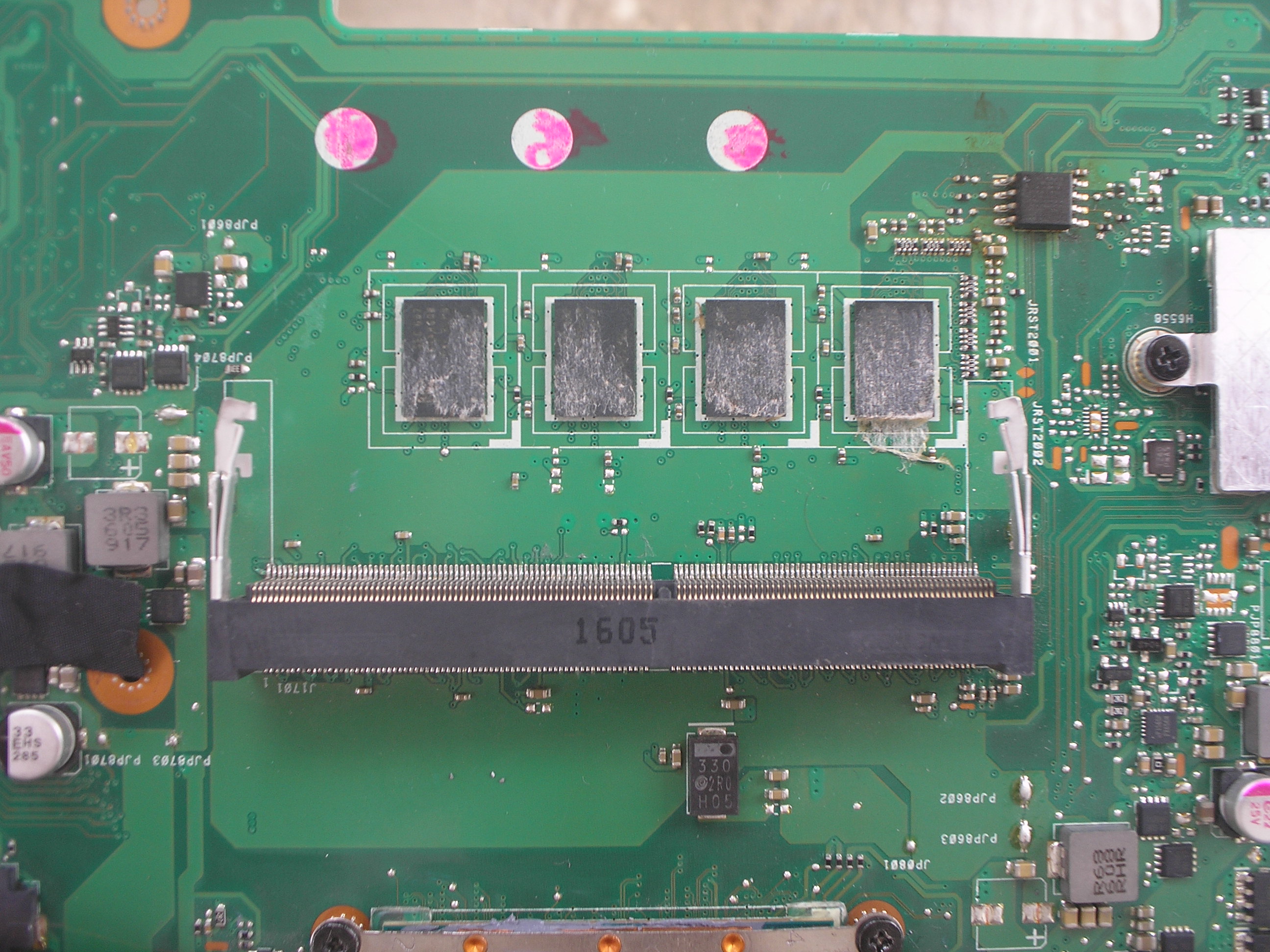

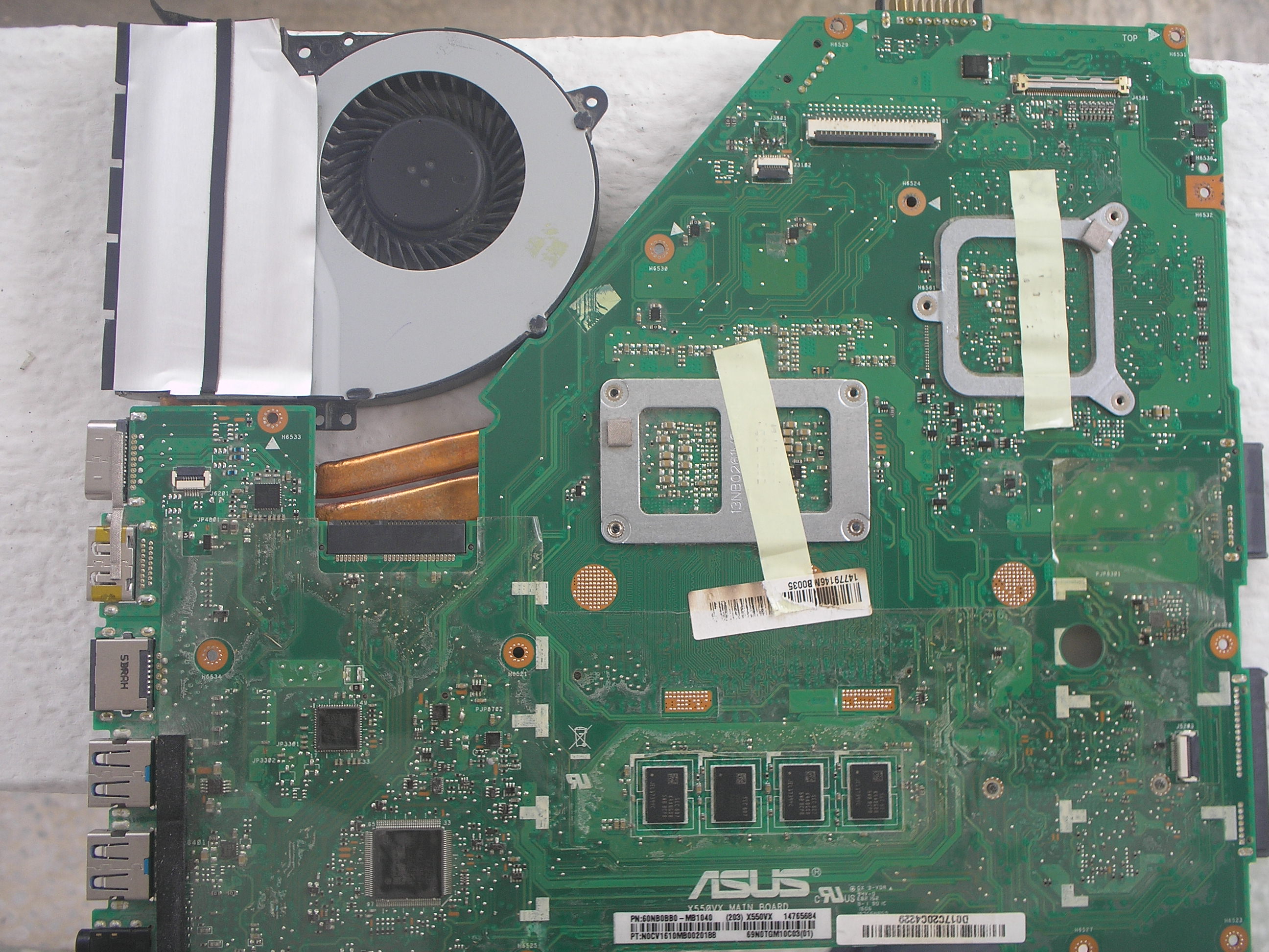

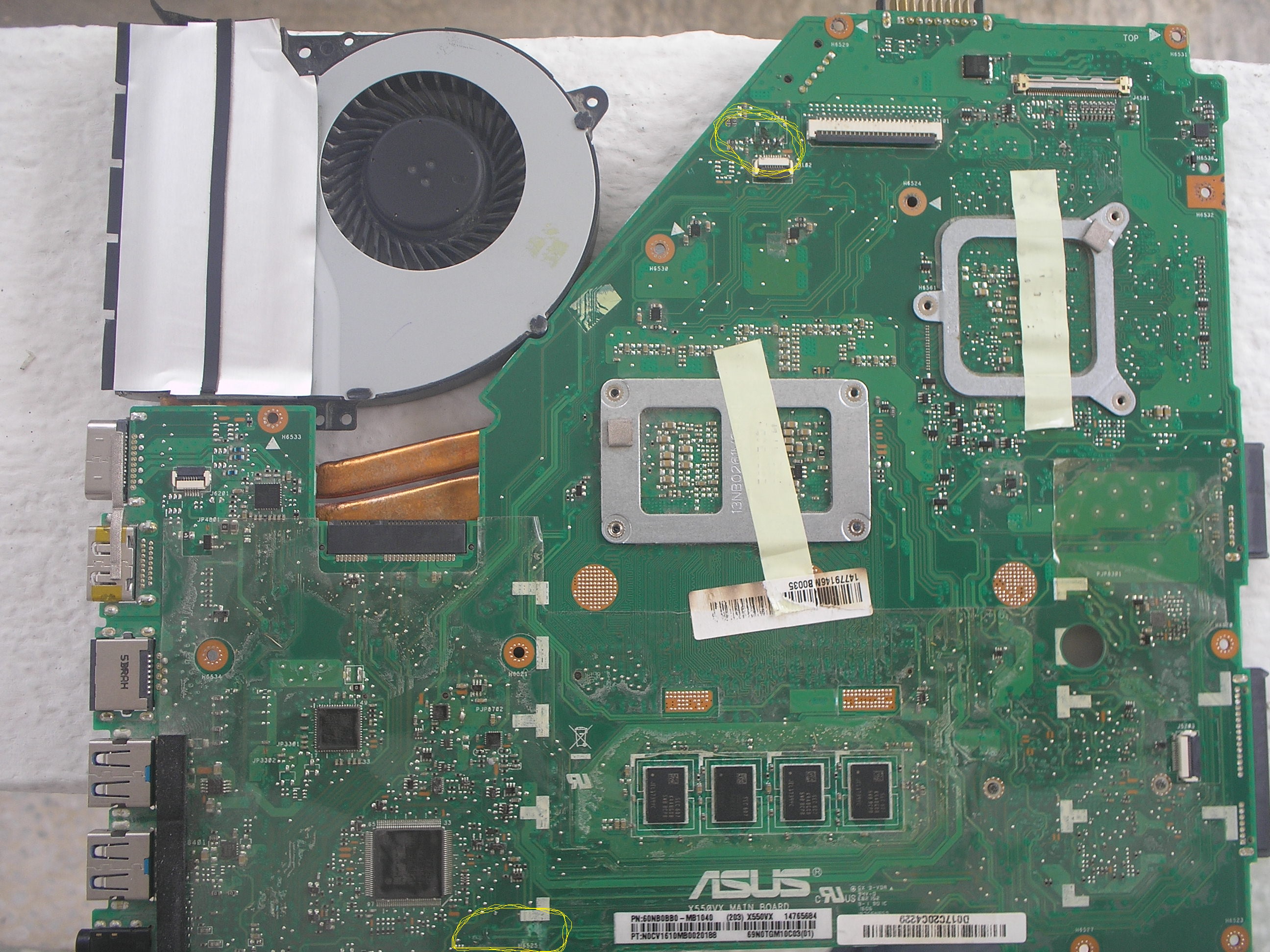

                    I attached some photos of the motherboard. Maybe this can help in finding a solution.
                      • 20933
                      Re: Asus X550V (X550VX-XX057D) bios Request
                      The bios and EC might be ok,it looks like the board has had a liquid spill .Check area above J3102, Area around H6525 for corroded tracks .Good luck with it.
                      • ramzi2019
                        • Apr 2019
                        • 56
                        • tunisia
                        This is not a liquid but a plastic cover for the motherboard.
                        I removed it the i returned back.
                        The last thing that i have done is the bios flashing using the link provided to me.
                        Can a wrong bios damage the motherboard?

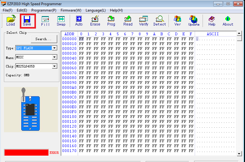

                          Post your original bios backup .
                          • ramzi2019
                            • Apr 2019
                            • 56
                            • tunisia
                            my bios backup
                            • ramzi2019
                              • Apr 2019
                              • 56
                              • tunisia
                              I think there is something wrong with my backup!
                                • 20933
                                Originally posted by ramzi2019
                                my bios backup
                                Corrupt bios backup ,try another
                                • ramzi2019
                                  • Apr 2019
                                  • 56
                                  • tunisia
                                  I've used the "Save Button" to make a backup and i saw a progression bar from 0 to 100%.
                                  • ramzi2019
                                    • Apr 2019
                                    • 56
                                    • tunisia
                                    Plz provide me a trusted bios file for my motherboard version.
                                    • ramzi2019
                                      • Apr 2019
                                      • 56
                                      • tunisia
                                      The mistake in backup was to push button "Read" to fill the buffer then to push the "Save Button". So i saved nothing.
