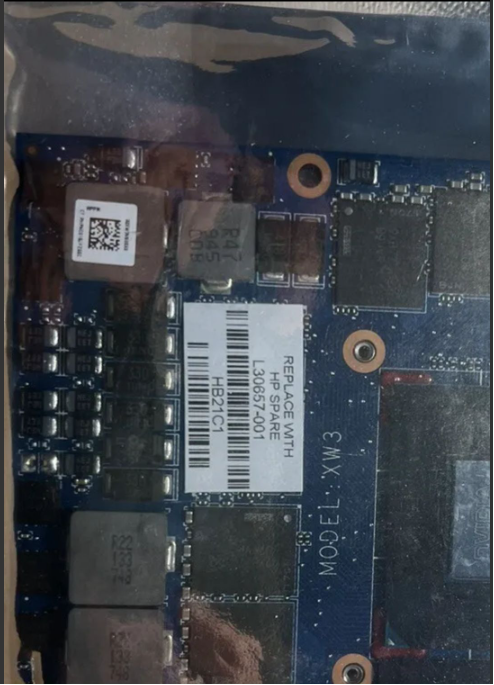

                                    Hello, can you help me i need vBios dump of Quadro P3200. Thank you!
                                      post S/N, full name and model, motherboard model, product number,,etc.

                                        #59
                                        There are few things on the GPU that indicates serial numbers.
                                        Replace with HP Spare 30657-001
                                        HB21C1
                                        Model XW3 DAXW3UB5CD0 rev.D

                                        #60
                                        HB21C1
                                        I dont have HP laptop i want to install the gpu in MSI laptop, i soldered vbios chip tried dell and msi vbios but no luck. I just need a vBios dump from one of you guys. Thank you.
