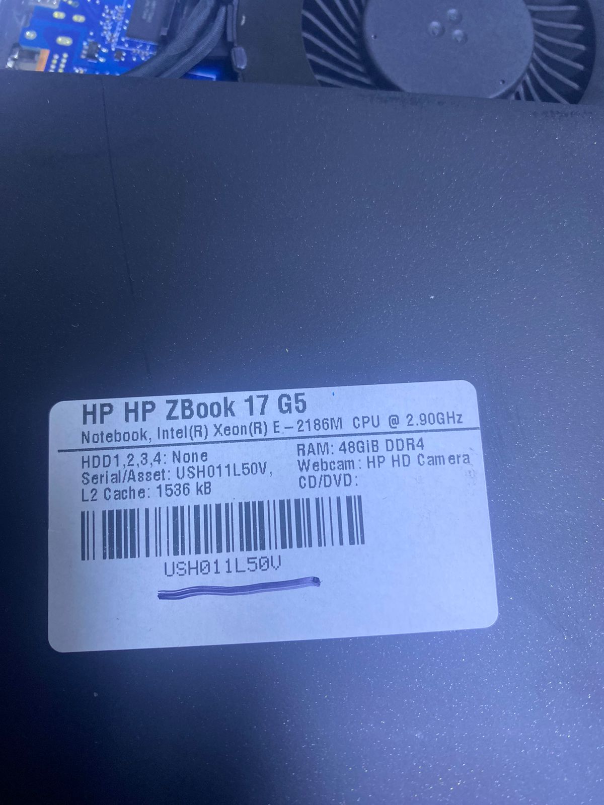

I need the HP zbook 17 g5 DUMP BIOS, thank you.
  • jontao
    • Jun 2019
    • 16
    • China
    I have an HP laptop, zbook 17 g5, I need an original programmer BIOS firmware, I have a friend to share, thank you very much.

                Hi, masters.
                I am repairing, HP Zbook17 G5,
                shorted PCH was replaced, now unit start but FAN at full speed and black screen. If I remove RAM sticks, getting beeps.
                Can anyone help me to clen ME region? I tried, but no luck, still black screen. I used ME analyzer to check ME version, than ME tool to put new region in, what did I wrong? Anyway can be another problem on board, but would like to try properly cleaned ME (FAN at full speed could be ME region)
                S/N: 5CD92240D6
                Thanks for any help.

                  Here's your New BIOS, try it and let me know.

                    Hi, I just test it, get picture and FANs spin normally. I gonna to install Windows and let you know if everything works. Many many thanks for now.

                        After install, everything is working well, once again, thanks for your help
