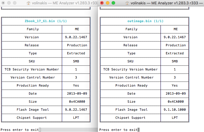

      Well, now at least I get a different error after replacing ME Region.bin in folder Decomp, opening the untitled.xml and trying to build the image

        I used FIT 9.1 and 9.0.22.1467_5MB_PRD_RGN.bin ME firmware and got no errors. Rename firmware as "ME Region.bin" and DELETE old ME Region.bin Maybe you deleted GbE Region.bin

          Thanks man, I just used Intel ME System Tools v9.1 and 9.0.22.1467_5MB_PRD_RGN.bin prior to seeing your post, and it worked for me as well.
          But we got different checksums on our outimages. Is that a cause for worry?
