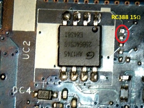

            hi every body , i have HP Notebook - 15-bs115dx
            p/n= 3MP69UAR#ABA
            S/N= CND8077FWR
            15-BS115DX
            black screen after bios update:
            if please, can anybody help me

              #166
              there is something wrong happened during desolder, because i restored my old bios, but all i get is 5 long and 3 short badcaps, here is the picture if someone can determine what i have done incorrectly

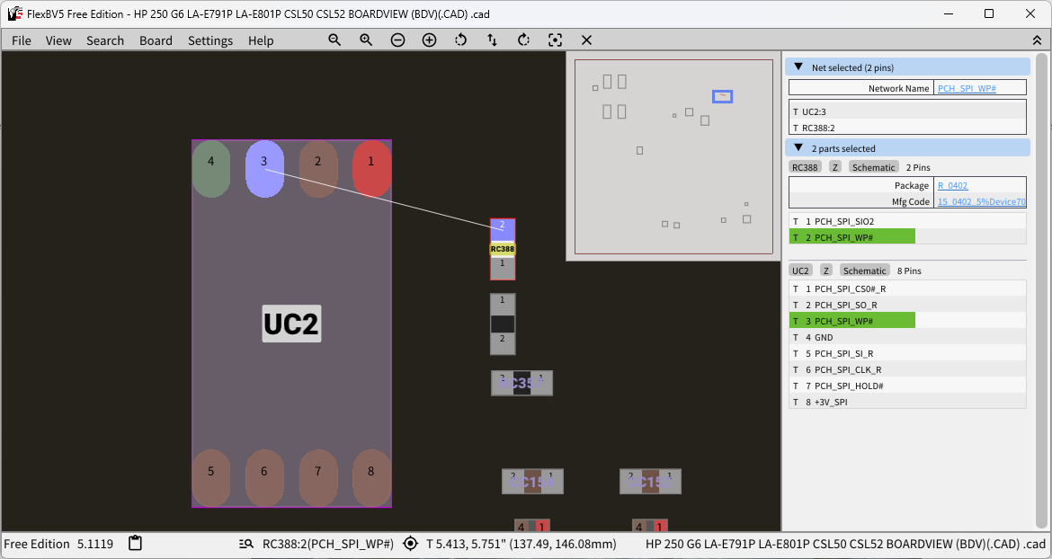

                    #169
                    You accidentally removed a resistor near the BIOS, 15 ohm, i marked it here
Name:	hp 15bs bios.jpg

                    • mazloum
                      • Sep 2012
                      • 504
                      • Lebanon
                      #170
Name:	Captura de pantalla 2025-09-07 122228.png
                      you are life saver, thank you very very much,

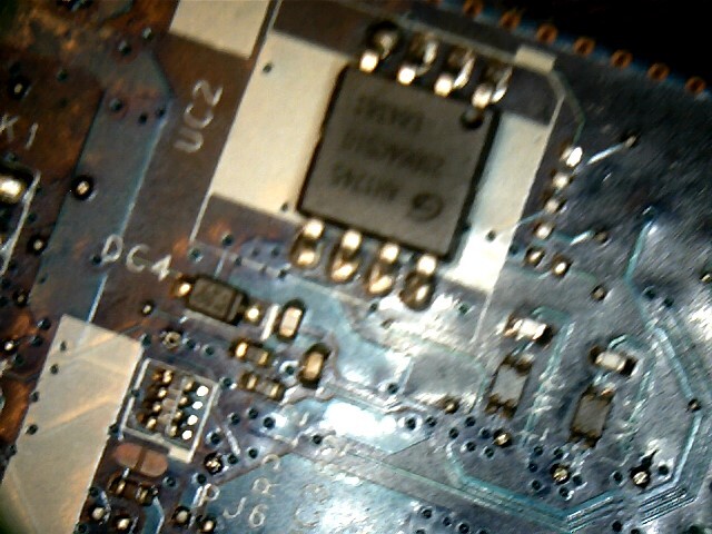

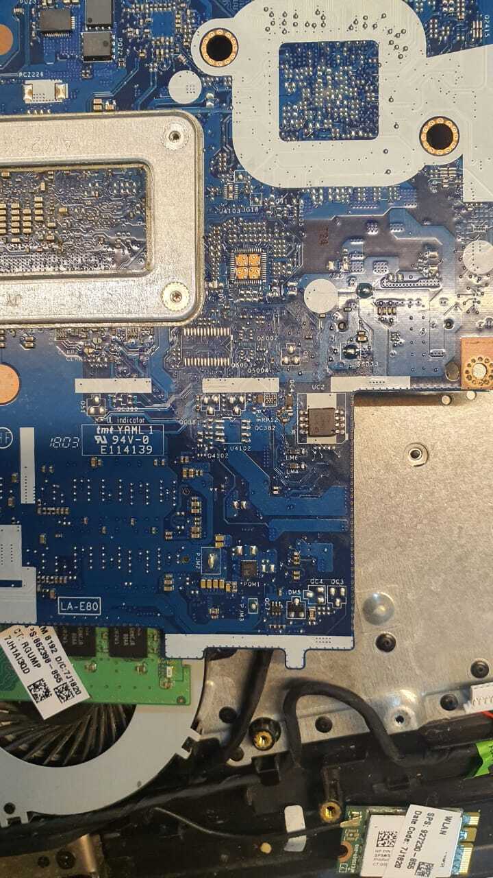

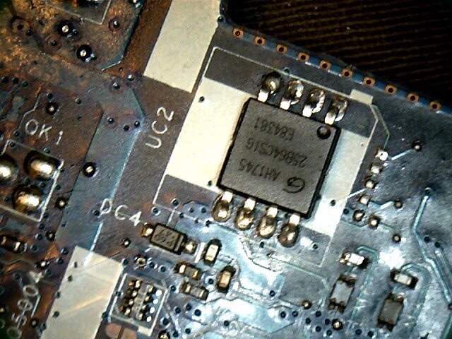

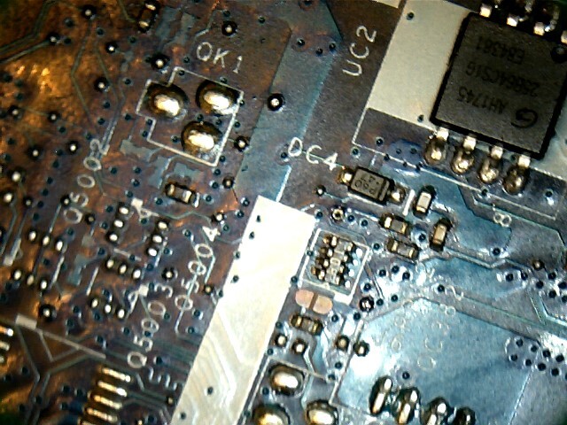

                        #171
                        Hi everyone,
                        I have a notebook that is bricked after BIOS update. Windows UI part went fine, after reboot updating windows appeared (write and verify didn't show any error), but after automatic reboot the screen has always been off. External monitor too.
                        Win+B and Win+V with recovery bios on usb pen failed, nothing ever appears on monitor.
                        BIOS version that bricked: F.75 Rev.A 17 mag 2024
                        https://ftp.hp.com/pub/softpaq/sp153001-153500/sp153030.exe​
                        Model: HP 15-bs199nl
                        ProdID: 3QS09EA#ABZ
                        SN: CND8105C1D
                        MB: DKL50 LA-E802P Rev: 1.0 2017-06-23
                        BIOS chip seems to be this:
                        AH1747
                        25864CSIG
                        E82456
                        I post also a picture, I'm not sure about CSIG or CS1G:
                        https://drive.google.com/file/d/1LAb...ew?usp=sharing
                        Is it a SOIC8 or other? Should I measure its size?
                        What tool do I need to read/write on it?
                        It seems that a clamp can be applied. I'm not able to desolder and resolder chips, I'd like to try with clamp and then if it doesn't work I will pay someone who is able to do it.

                        • m1ch43lzm
                          • Mar 2019
                          • 1186
                          • Peru
                          #172
                          AH1747
                          25864CSIG
                          E82456
                          BIOS chip model is GD25B64C (bee not eight), cheapest programmer available is CH341A, yes, SOIC8 clip which comes with most CH341 kits will work, but it may take some tries to attach it properly, sometimes those clips don't make a good connection
