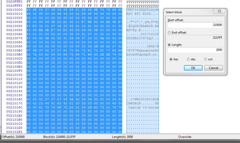

                              Re: HP 15 bs DKL50 LA-E802P
                              Hello everyone, please rebuild bios for me. Something went wrong when the bios was update without power supply.
                              HP 15-bs119ur
                              serial:CND7443DQS
                                • 22415
                                HP 15-bs119ur
                                serial:CND7443DQS
                                https://www.badcaps.net/forum/showthread.php?t=122195
                                [Guide] How to extract ready for programming dump from HP update executable file
                                https://www.badcaps.net/forum/showthread.php?t=121948
                                When you have found the right bios version and extracted it the next job,before flashing it,is to copy the DMI (serial number,feature byte etc) from your backup to the new bios.
                                Use a hex editor with these offsets,just copy from the backup,and use the same offsets in the new bios and paste in.If you can`t do that let us know.
                                210000 - 211FFF

                                • GeorgikRostov
                                  • Jun 2022
                                  • 4
                                  • Россия
                                  #36
                                  Originally posted by SMDFlea
                                  [B][Guide]
                                  210000 - 211FFF
                                  Thanks, i will try

                                    #37
                                    Downloaded orig bios from HP website.
                                    I find there 5 .bin files - 084D4/0832D/0832E/08328/08445
                                    In my orig bios downloaded bin file i found by hex editor line - F.24... ..!9 08238A.bin.. .
                                    I don't understand what to do next...
                                    Found BID in my bios file - BID08328
                                    I will try to rewrite DMI from my file to downloaded from hp site.
                                      Done!!! Thanks!!!!!
