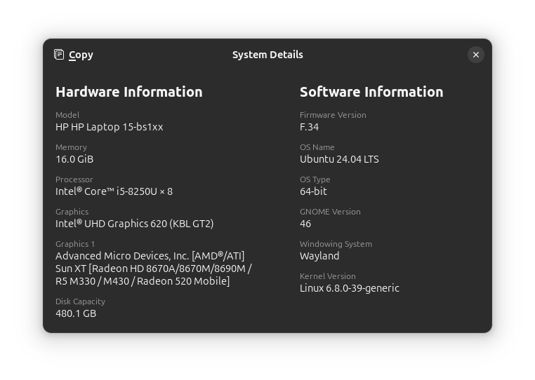

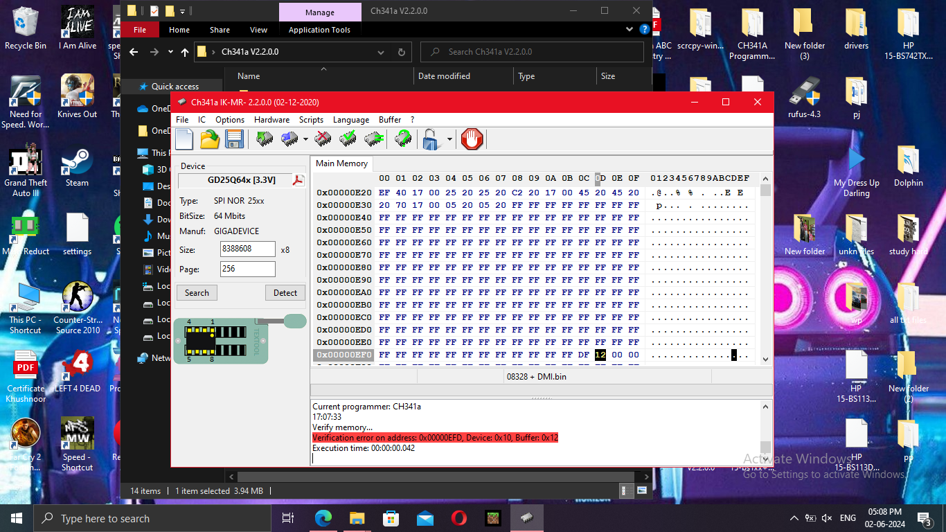

      Thanks brothers i managed to get it up and running after some trial and error, I literally lost my hope to see it running that laptop was very dear to me thanks again may god bless you brothers i cant explain how helpful i am
      • hoaca388
        Badcaps
        • Jan 2022
        • 12514
        #103
        Change a programmer or other bios chip .

          Everything went well i managed to flash my bios but after booting up to windows I saw that my windows was not activated but when I clicked on troubleshoot it is showing that I had activation key of windows 10 home and I'm running windows 10 pro , i honestly don't remember which edition i had, but before that bios incident i didn't do anything to my windows

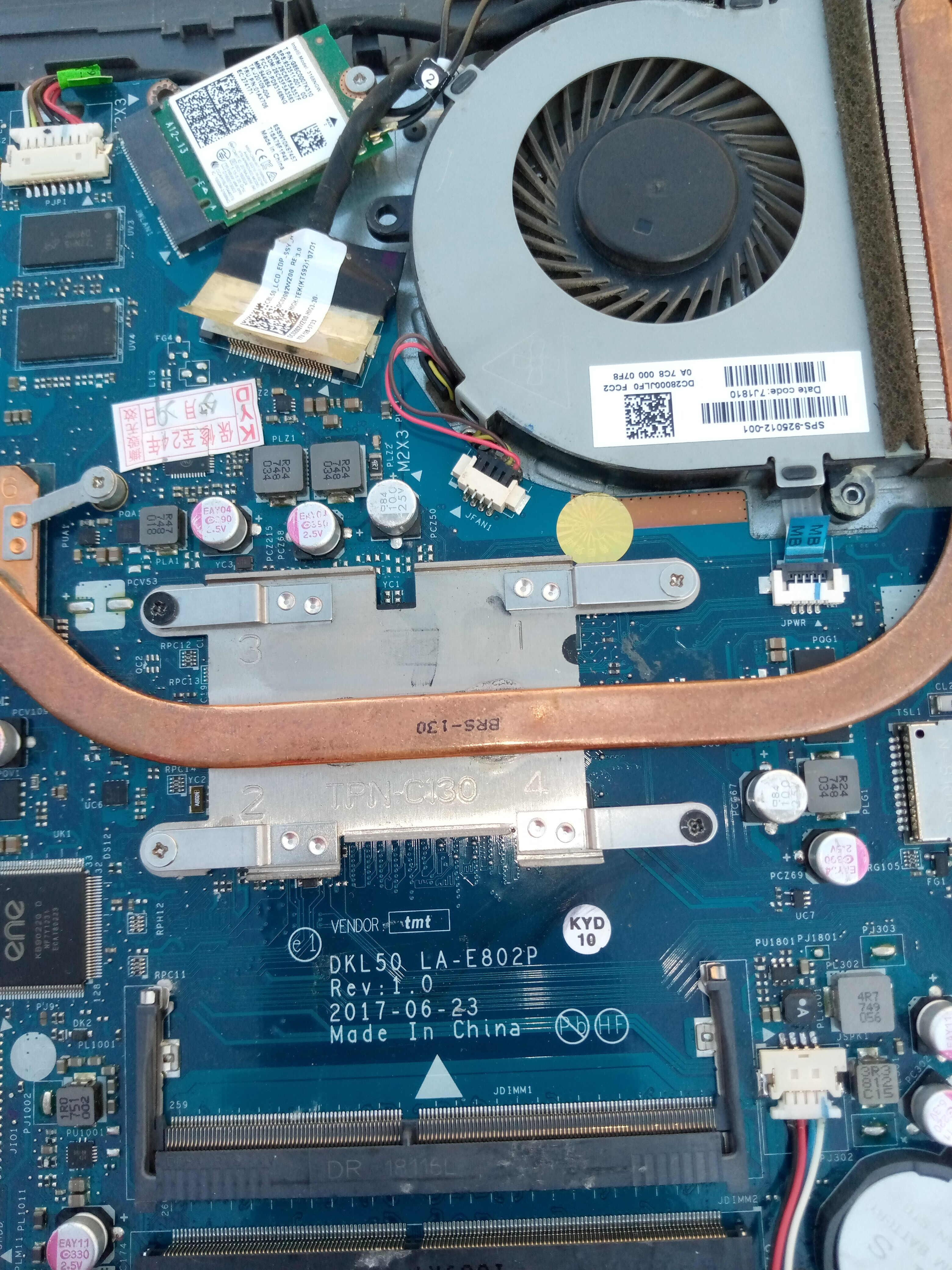

                  Good morning. Please I need help with a couple of HP laptops.
                  After updating BIOS they have been left with a black screen.
                  Model: HP 250 G6
                  SN: CND8080Z2H
                  ProdID: 2SX93EA#ABE
                  Motherboard: CSL50 / CSL52 LA-E791P Rev: 2.0
                  Model: HP 15-bs103ns
                  SN: CND8132PX0
                  ProdID: 2PT17EA#ABE
                  Motherboard: DKL50 LA-E802P Rev: 1.0
                  I hope you can help me. Thank you so much.​

                    Please I need help with this HP laptop
                    Model: HP 15-bs105ni
                    SN: CND81359J3
                    ProdID: 3DK66EA#ACQ
                    • peste
                      • Dec 2016
                      • 14035
                      • ROMANIA
                      #111
                      SN: CND81359J3
                      ProdID: 3DK66EA#ACQ
                      try post #48.... 08328....

                        • jlec267
                          • Jul 2024
                          • 9
                          • Spain
                          #113
                          Originally posted by hoaca388
                          HP Notebook - 15-bs166nz
                          Good afternoon.
                          After updating the bios I was left with a black screen. I tried with this file that you sent to a colleague, and now the caps lock key blinks 5 slowly and 3 quickly.
                          I am sending you my original bios, the one that fails and the bios that I put in was the one that I left marked in the message.
                          SN: CND8132PX0
                          ProdID: 2PT17EA#ABE
                          I hope you can help me, please. Thank you so much.​

                              #115
                              Originally posted by franklinogot
                              Try this
                              Good afternoon. I have tried the file you sent me and it is still a black screen.
                              I await new instructions from you, colleagues.
                              Hopefully we can solve it.

                                #116
                                Thank you so much.​
                                try the bios from post #48...08328...if it doesn't work, either you wrote it with errors, or the laptop has another problem..

                                  #117
                                  I already tried that file and it didn't work for me either.
                                  The computer worked perfectly before updating the BIOS.
                                  Also, it was recently formatted and was working fine until I decided to update the BIOS and it went black.
                                  Please help me. Can you fix my original BIOS?
                                  Thank you so much. I wait for answers​

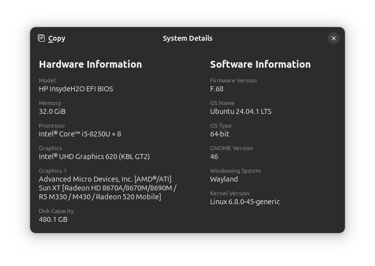

                                        My original BIOS
                                        Click image for larger version  Name:	Screenshot from 2024-08-12 21-30-15.png Views:	0 Size:	25.0 KB ID:	3482110
                                        The BIOS after laptop brick repair
                                        Click image for larger version  Name:	Screenshot from 2024-10-07 19-30-19.png Views:	0 Size:	25.2 KB ID:	3482111
