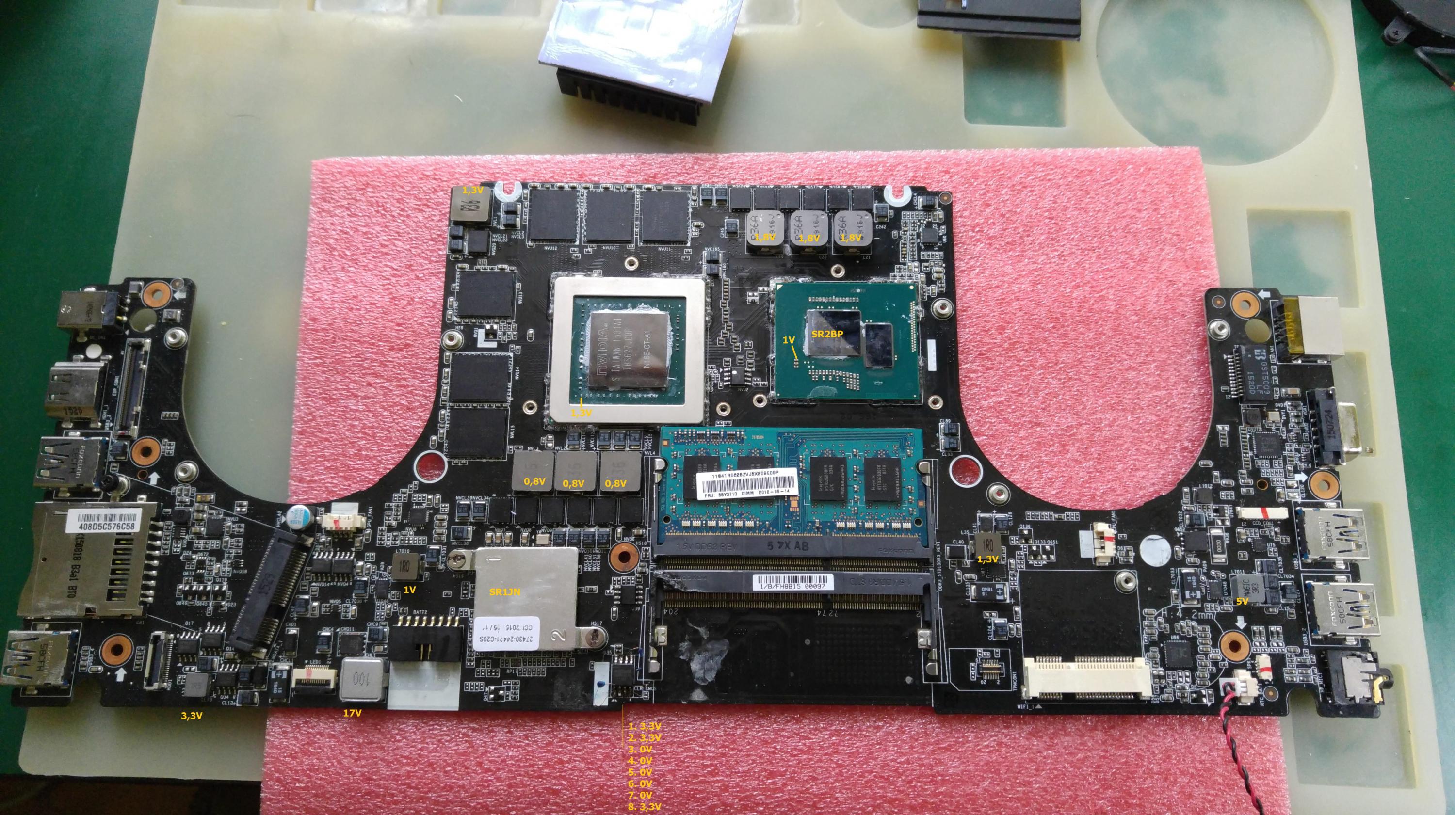

    Hello Guys
    Does any of you have a bios to this motherboard?

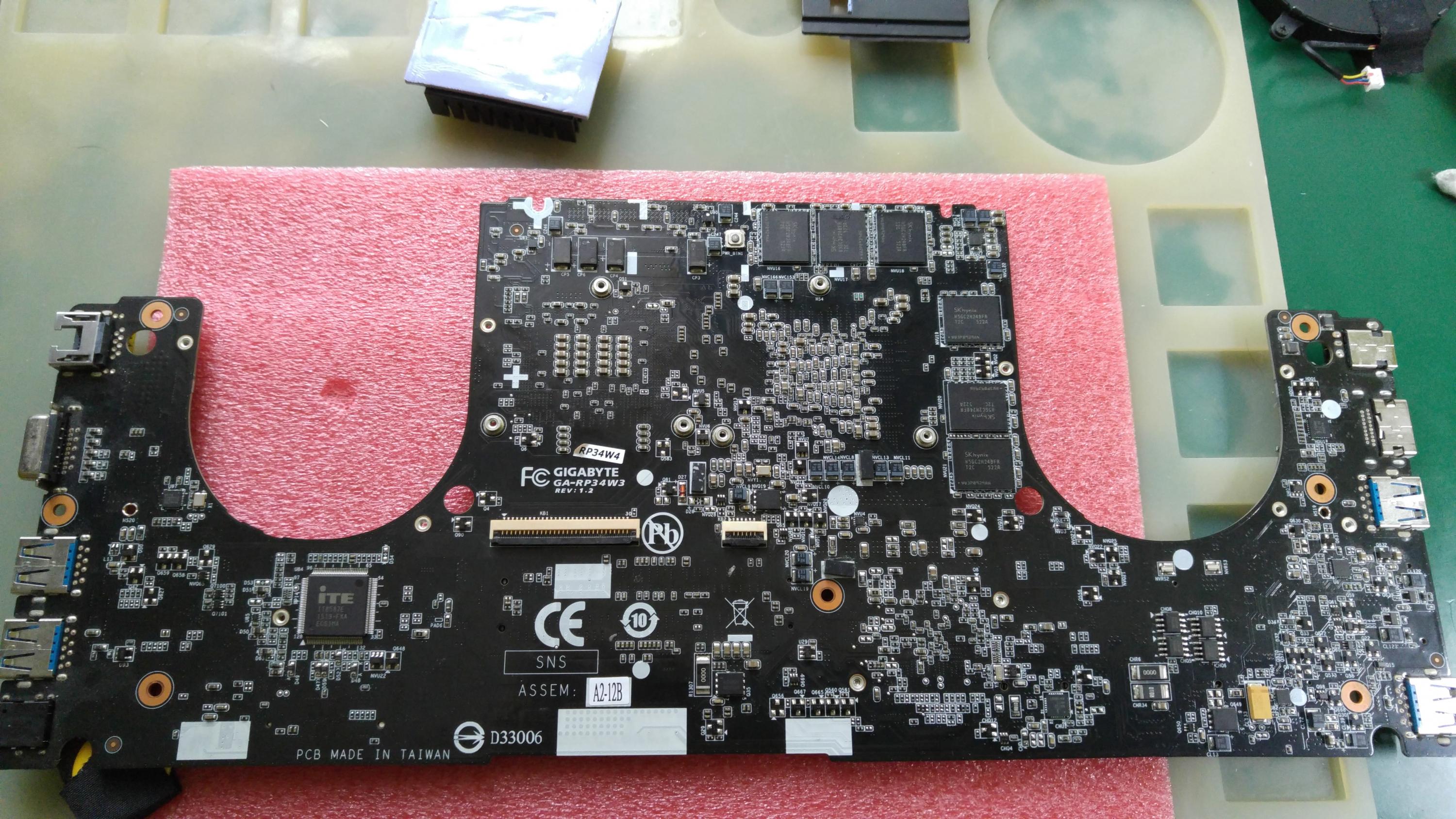

    Sorry, I don't. Another person should come in a while.
    And an interesting note, after I saw your photo: WTF, the motherboard has a PRC-style CE logo. I can't recall ROC-made stuff having that...

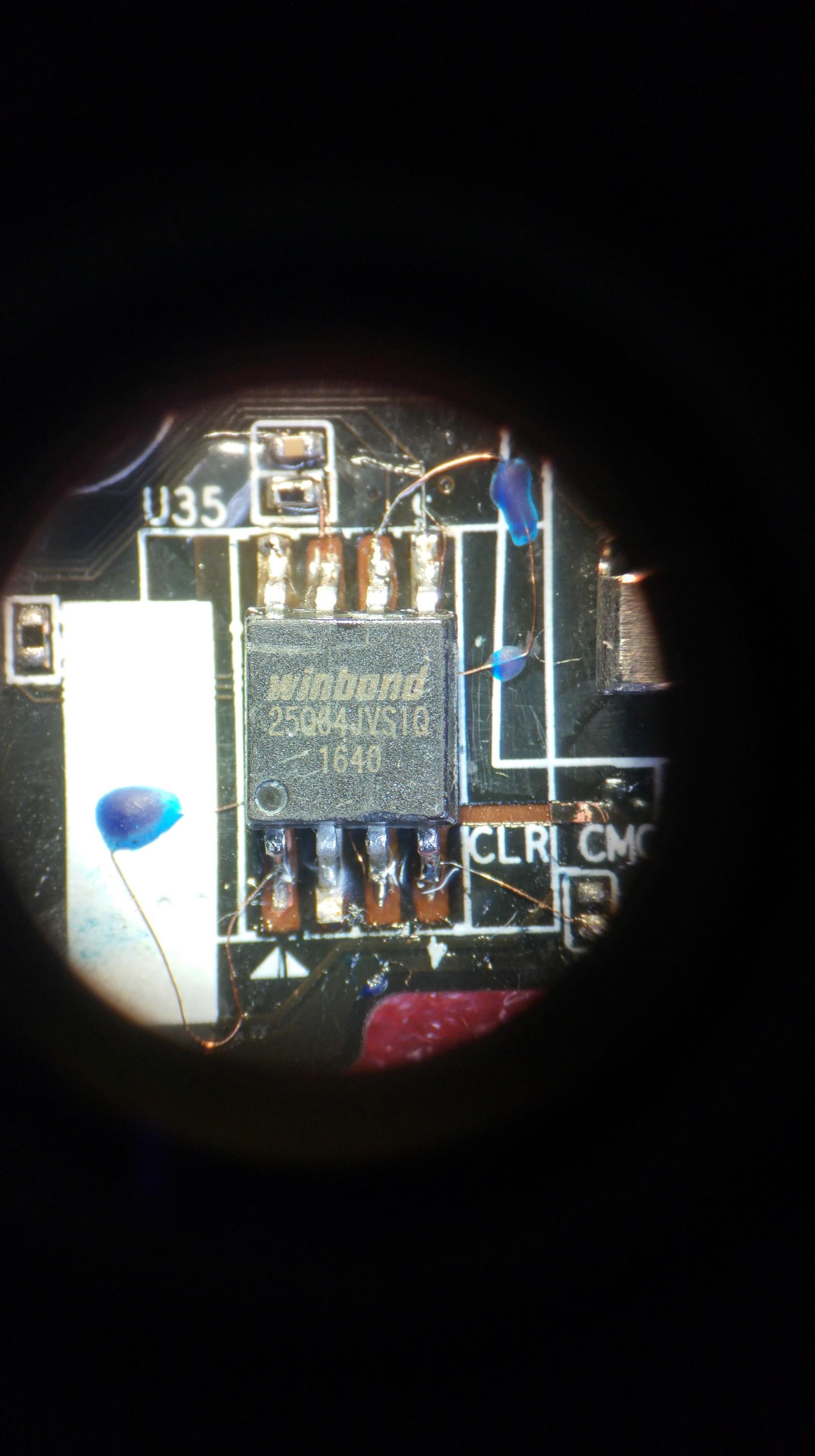

        Thanks guys for the answer. I am repairing the motherboard after another service that has corrupted the BIOS paths. There are no markings on the laptop but it seems to me that it is P34W v4 (i7-5700HQ and N16E-GT-A1) I programming U35 both P34V4BF.B07 and P34V4BF.D07 Unfortunately, the laptop start up, power consumption is 1.12A and no picture on LCD and external monitor

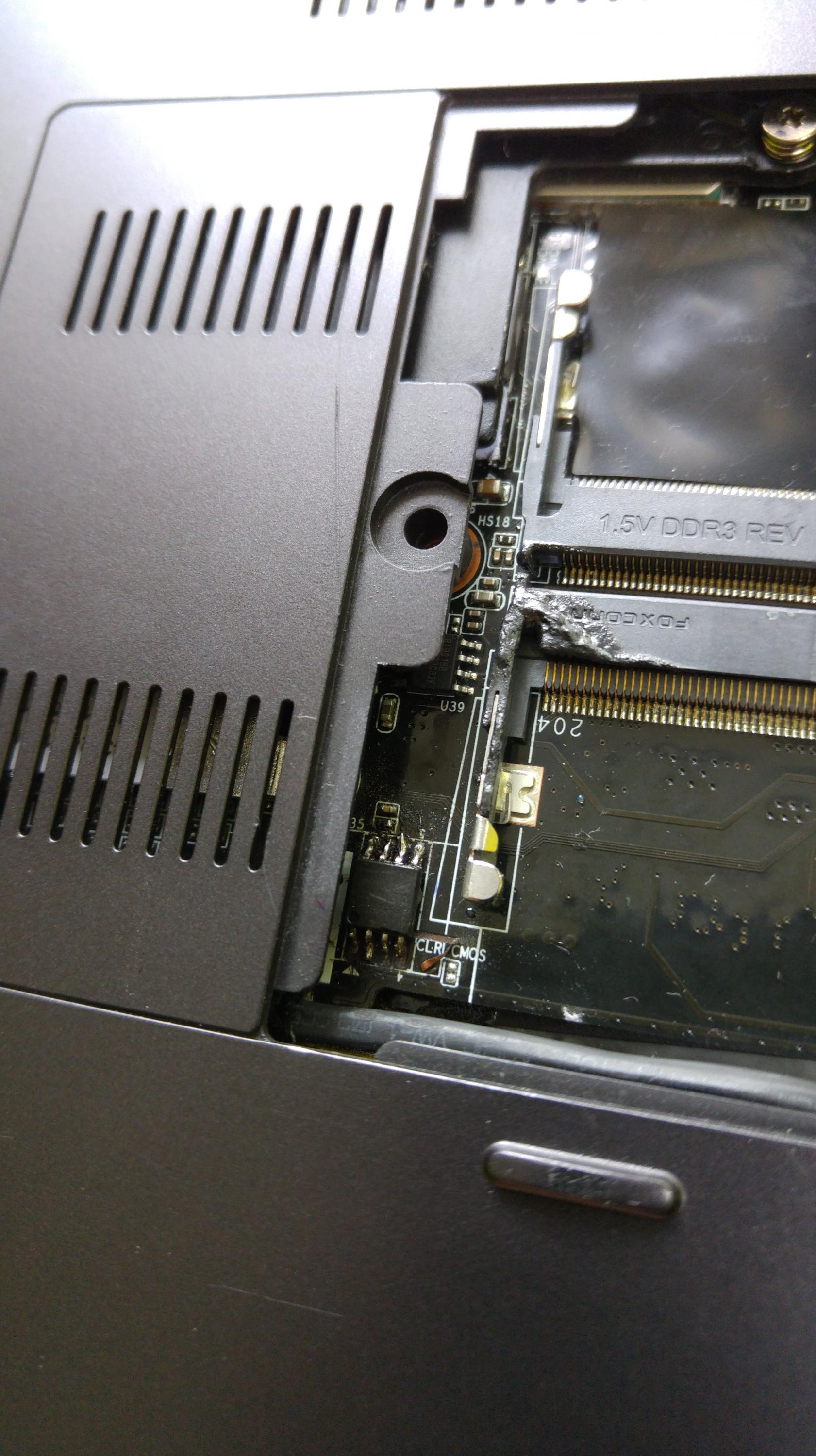

          I read your post on elvikom. So the laptop powers up without the cmos battery,and doesn`t start with it.Re-check the wires you soldered to the bios ,and the trace that looks like its for cmos reset. Can you compare the original backup dumps against the V3 and V4 bios and EC .
