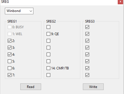

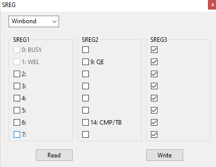

One thing I did in AsP is that, by going to EDIT SREG and then pressing READ, this loaded for me:
So I unchecked all the boxes and pressed Write, and then when I pressed Read again, it loaded, so at least it seemed I was able to edit SREG1 even though SREG3 remained the same???:
Whether this did or changed anything, or helped me in any way toward my goal of making this Laptop work, I have no idea.
But basically now I'm stuck here, not knowing where the hell to go from here, or what I'm even supposed to do or where to ask.

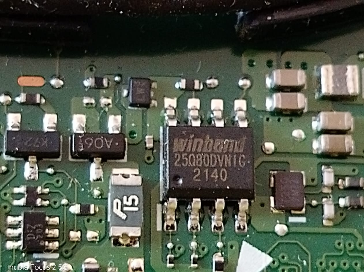

EC1.bin is a dump of the firmware exactly as it was originally from the chip that I was intervening with.
EC2.bin is a dump of the same chip, But after I supposedly edited it with AsProgramador? I'm not sure if anything changed.
BIOSASUS.bin is a dump of my BIOS, BUT I made this one using .\fptw64.exe , because I'm still not sure which chip on my motherboard contains the main BIOS, and I haven't plugged the clips in there yet.
EC1 and EC2 are both dumps of a Winbond 25Q80DVNIG 2140

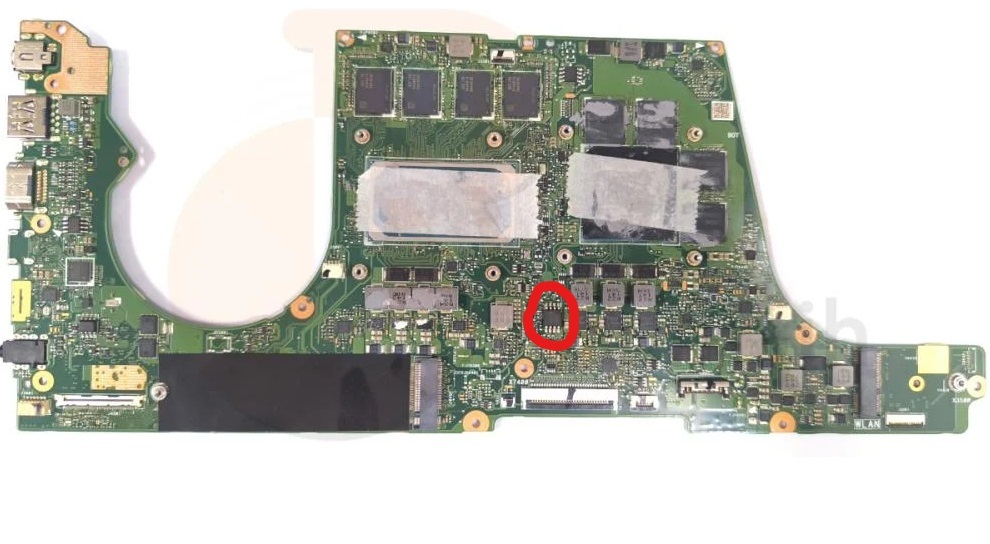

MotherBoard (Just same model, remember that this scan is of the one that got burned):
Here is the scan of the motherboard model mentioned; the chip circled in red is the one I was trying to edit with the tweezers connected to CH431a. And it is the one that I think corresponds to the EC Chip and its Firmware. From this Chip is the first two dumps I posted.
As I said, I don't know which Chip corresponds to the main normal BIOS, so I would appreciate it if you guys could point that out to me, or if the Chip I enclosed in the red circle corresponds to actually something else and I'm not doing anything right.
