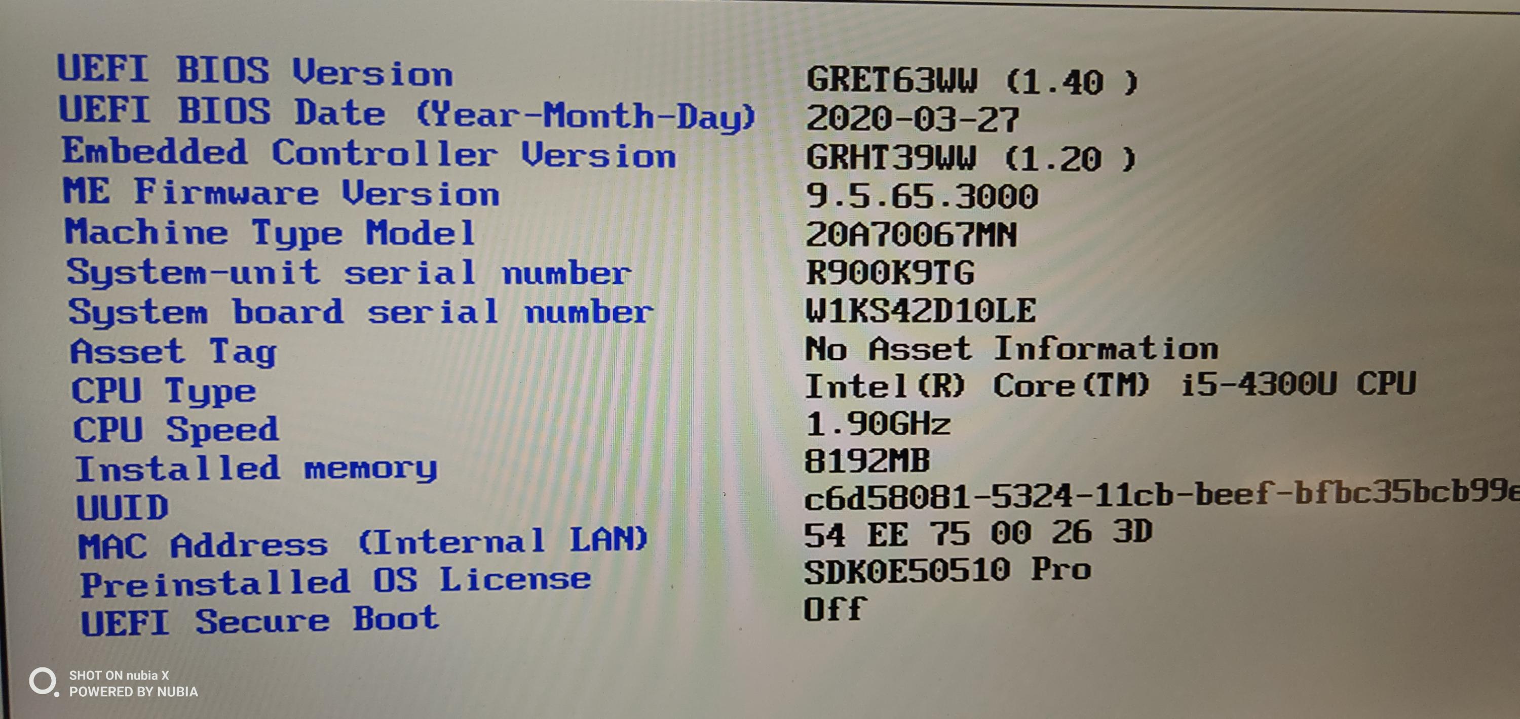

                    Re: Lenovo X1 Carbon Gen 2 (20A) Bios needed
                    Need BIOS
                    MB: LMQ-1
                    12298-2
                    48.4LY05.021
                    16MB

                        #31
                        Originally posted by peste
                        post the backup copy of the original laptop bios
                        BIOS 1.4
                        problem with this version:
                        After BIOS update can't load from any device (SSD/USB/USB-CD)
                        But can access to the BIOS
                        very strange:
                        after update in BIOS 3(!!!) "ATA HDD" when select bootable device
                        When press F12 I see SSD/USB/USB-CD, but can't boot from it.
                        PS In BIOS tested
                        - Defaults settings
                        - Enable/Disable security settings
                        - USB enable

                          #32
                          Originally posted by sfagnum
                          BIOS 1.4
                          very strange:
                          PS In BIOS tested
                          - Defaults settings
                          - USB enable
                          post (type) on and serial number (SN)
                          • sfagnum
                            • Dec 2021
                            • 4
                            • Estonia
                            #33
                            From label
                            TYPE:
                            20A7-0067MN
                            S/N:
                            R9-00K9TG 14/02
                            + Screenshot BIOS info

                              #34
                              From label
                              TYPE:
                              20A7-0067MN
                              S/N:
                              R9-00K9TG 14/02
                              try..
                              • sfagnum
                                • Dec 2021
                                • 4
                                • Estonia
                                #35
                                try..
                                not working (
