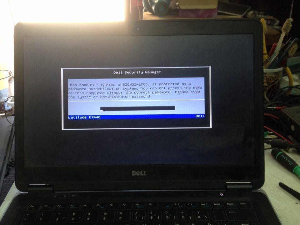

                            need bios for dell E7440
                            hi all have dell E7440 with password and in borad one ic for bios need bios for 25l640 and 25x10
                            DELL LATITUDE E7440 LA-9591P

                                  i try it .but notwork .please another one.old password need password as photo

                                    Re: need bios for dell E7440
                                    have you try
                                    https://bios-pw.org/
                                    48ZQN32-1F66
                                    AIBhLO7On87uzZNF
                                    after typing press ctrl+enter
                                      Originally posted by rioreno
                                      have you try
                                      48ZQN32-1F66
                                      AIBhLO7On87uzZNF
                                      i try but not open if have bios
