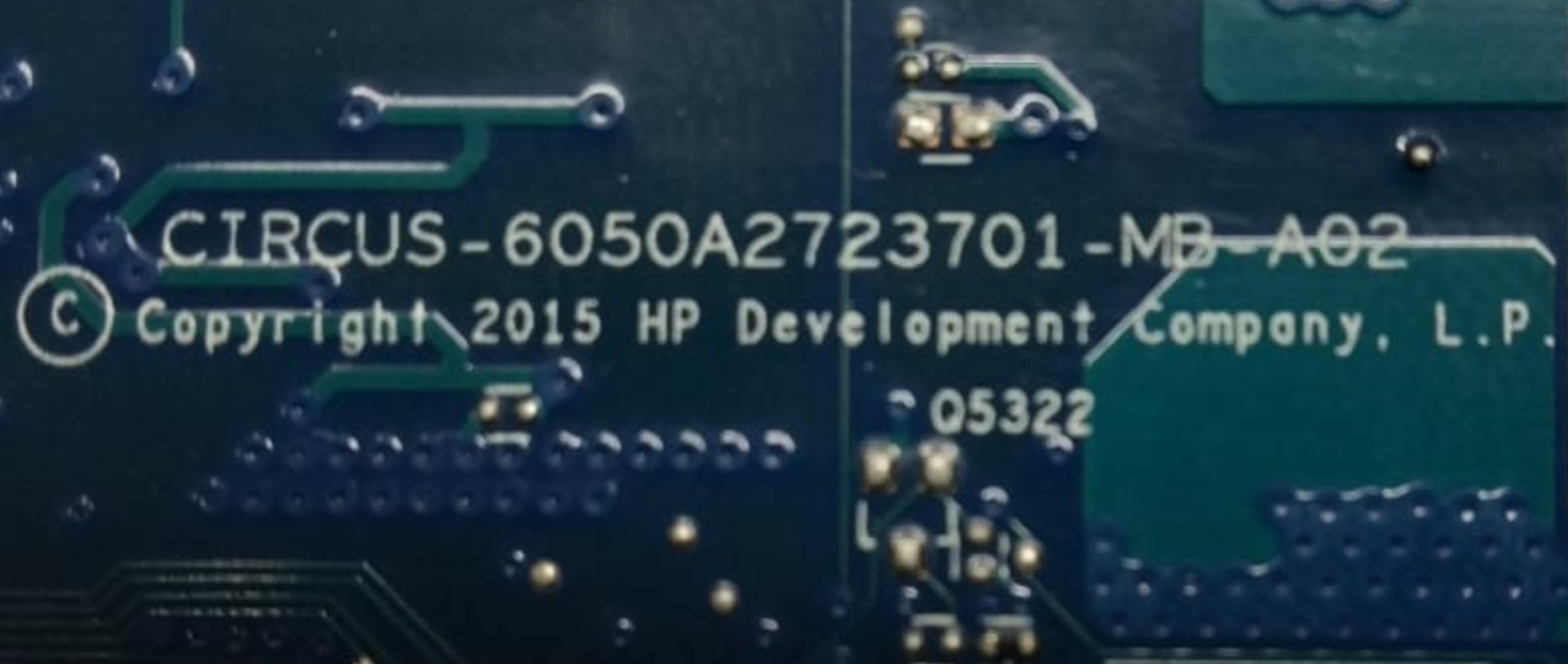

                bios hp probook 650 g2
                hello, can someone help me with a repair to a bios dump from a hp probook 650 g2?
                it powers on and nothing on display, and makes 2 long beels then 2 short ones
                here is an attachement of the dump. thank you
                • Jeroentje
                  • Dec 2017
                  • 82
                  • Nederland
                  Re: bios hp probook 650 g2
                  this is stock bios and unlocked descriptor with youre intel image, remember you have to brand it again with NbDmiFit-2.10+ with your serial(s)
                  goodluck
                  • mcm022006
                    • Jan 2015
                    • 24
                    • romania
                    thanks, IT WORKS!!
