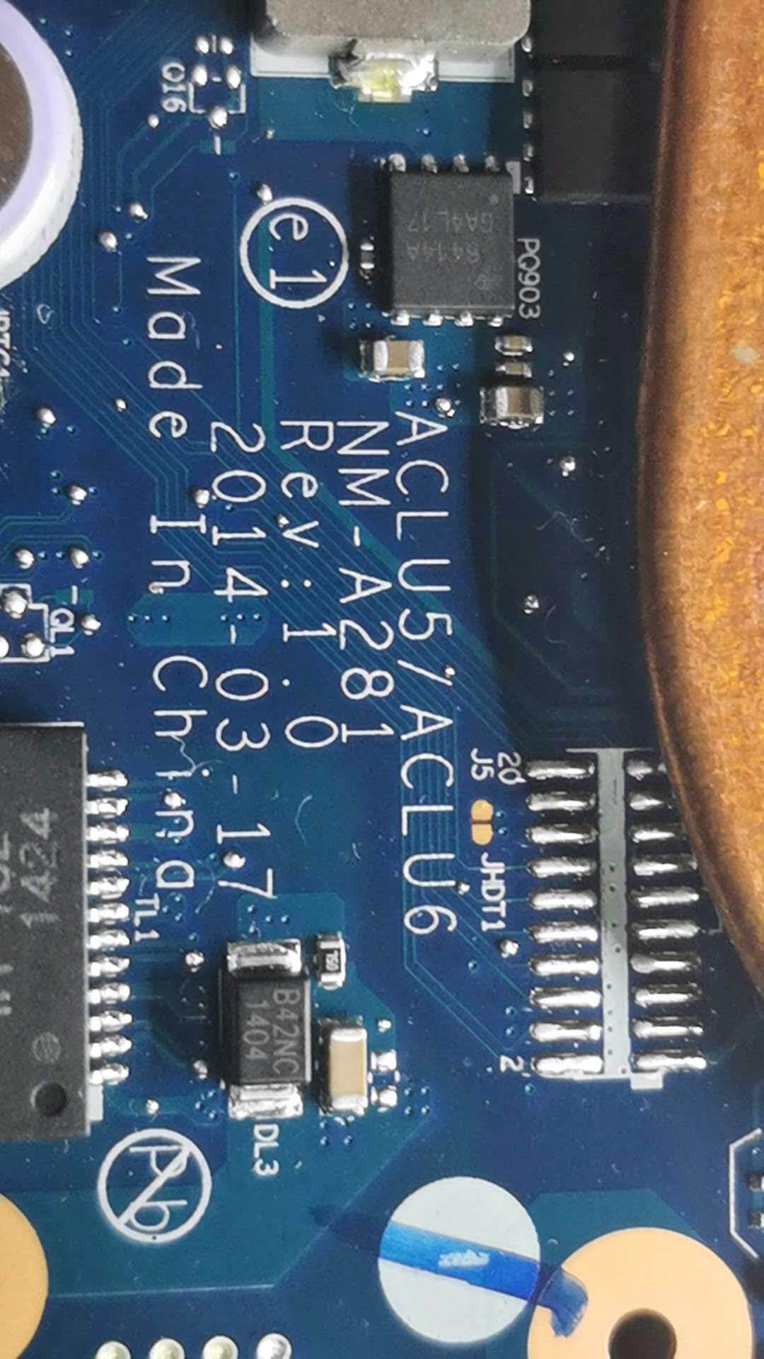

                      #50
                      Originally posted by SMDFlea
                      Re: Lenovo g50-45 bios
                      Ok,lets try a bios recovery. Format a USB flash drive as fat32 .Extract the attached file named LarneMLX64.fd from the zip folder and copy it onto the flash drive.Follow this guide from step #4 https://www.bios-mods.com/bios-recov...bios-recovery/
                      Hi!
                      I know it is an old thread, but i have the same problem and maybe i'm in luck.
                      So... I have a Lenovo G50-45 with AMD A8-6410 CPU and Radeon R5 graphics.
                      The laptop is turning on, power led goes on but the screen is black. From an angle, i can see some kind of reset on the screen when i power it on, but no backlight or any info.
                      I can turn off the laptop with a long press, but it turns of and restarts after 25 seconds. Fan does not spin, but USB ports are powered also.
                      To me it seems a corrupt BIOS, i would reprogram it, but my hot air soldering station is broken and without that is kinda difficult.
                      I tried the bios recovery procedure described, but no joy.
                      I tried by pressing the keys Windows + B as in the procedure, but also with Fn + Esc what i saw on another forum.
                      None of these worked. I used an USB key which has a led indicator, but it did not even blink.
                      Would love to hear your opinion, do i have any chance to start it this way? Maybe it's not even a corrupt bios, could be a hardware failure, but voltages seem normal.
                      This is the motherboard type.
Name:	2023-12-17 23-41-17.jpg
                        SMDFlea commented
                        Editing a comment
                        If you can see info on the screen using a torch/flashlight you have a backlight problem, try using HDMI. If bios is corrupt and USB recovery hasn`t worked you will have to use an SPI programmer to program it.
                      • janos6662000
                        janos6662000 commented
                        Editing a comment
                        Hi!
                        Your procedure saved this laptop, it works now!
                        First i want to say, that of course i checked the screen with flashlight and there was no info on it. I also checked with external monitor on both VGA and HDMI outputs.
                        When i said "some kind of reset", i meant that from an angle the black looked different when it was off or on.
                        Now, the solution. CMOS recovery worked OK, but with a catch.
                        On a Russian forum i saw that someone succeeded after pressing the Fn + R keys.
                        I tried that and bingo! Beeps, etc and in a few minutes i got my laptop working.
                        Thank you again, your post was a treasure.
