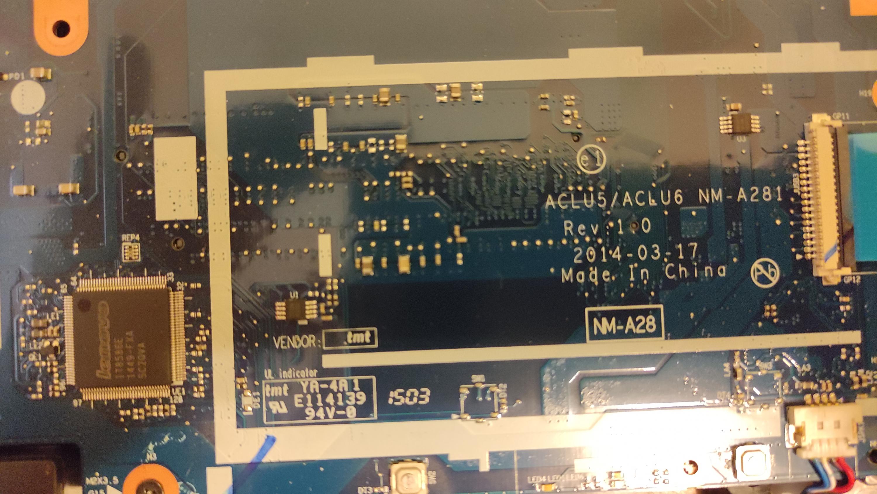

                          Re: Lenovo g50-45 bios
                          Hi there,
                          I am not sure what of these two works for me but it works!!!
                          on a Lenovo G40-45
                          ACLU5/ACLU6 NM-A281 REV: 1.0
                          Thanks a lot!!!

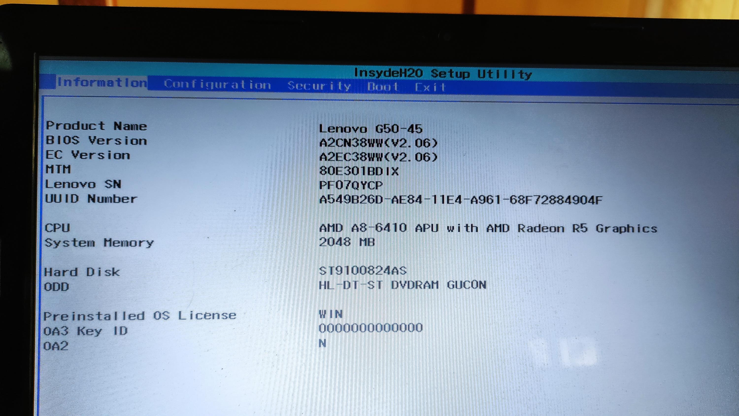

                            Hi
                            can someone send me a dump of a2cn45ww v2.13 bios.
                            My board actualy has bios a2cn38ww v2.06. Info as follow:
                            ACLU5/ACLU6 NM-A281 REV:1.0
                            CPU: AMD A8-6410 APU WITH AMD RADEON R5 GRAPHICS
                            GPU: none
                            IT8586E PRESENT ON BOARD
