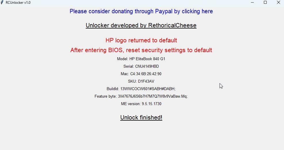

          Can someone help with a bios password unlock on the HP Elitebook 840 G1? after unlucking with hp unlocker i have a blinking power light white / orange.
          The chip is a Micron 25Q128A. Attached backup of the Chip and printscreen specs laptop.

                          Can you try this script (it's safe and very simple)?
                          https://github.com/SpookySkeletons/h...os_unlocker.sh
                          Does it lead to the same result (I mean hashes of unlocked files) as the tool you used?
                          OK. I patched your dump with the script and it gives the following sha256 hash:
                          Code:
                          $ sha256sum N25Q128A-markv81-unlocked.bin
                          a0f484d9bda83ae5578d6a0f8295edb5bd5457ae4629acbca003034f9059b319 N25Q128A-markv81-unlocked.bin
                          I will try flash my bios with it and check if it works. I hope your dump is correct, because I have the same n25q128a chip but it's broken so it seems I was unable to get the correct dump.

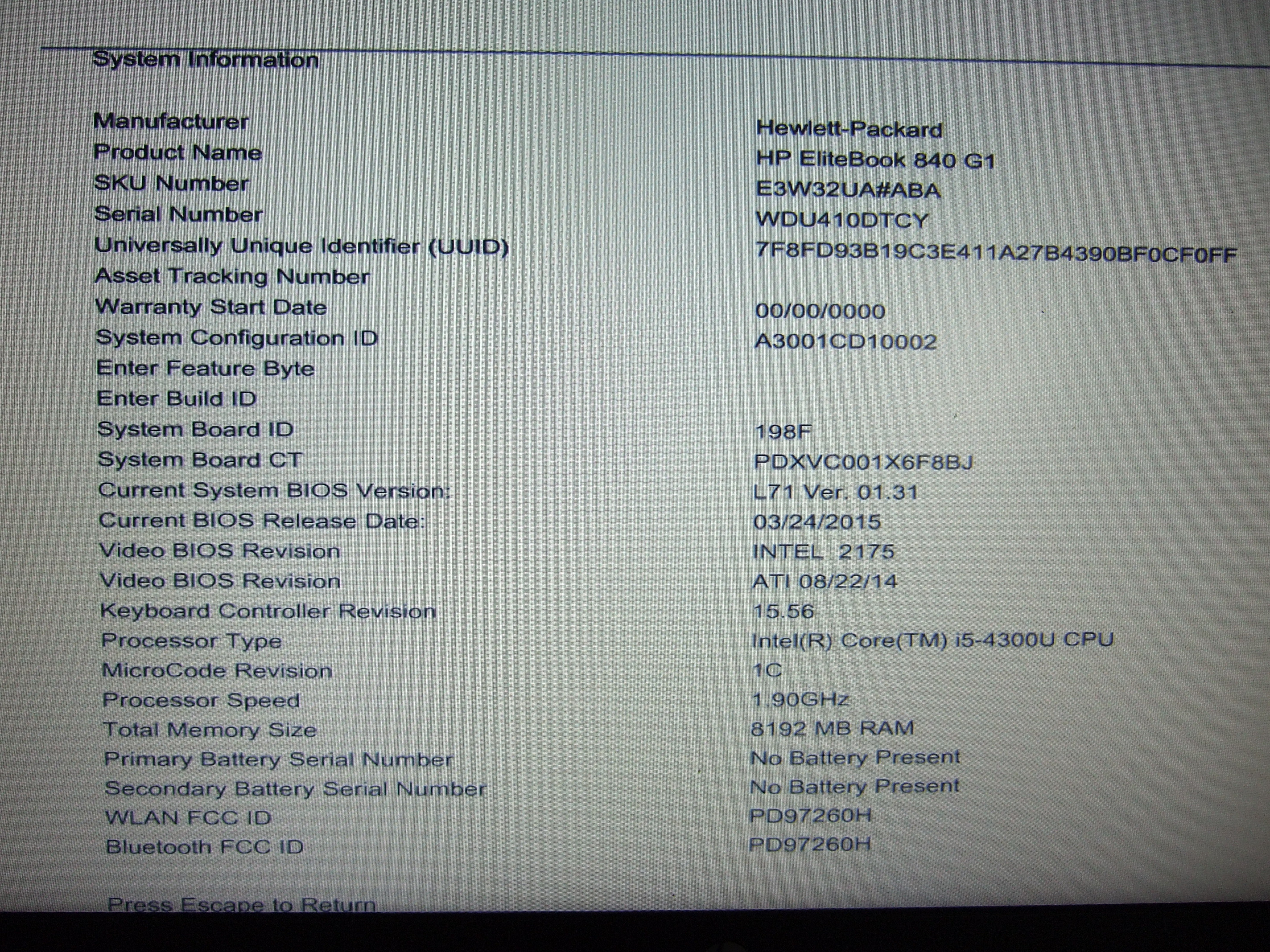

                                  With the help of this forum, I was able to restore an old HP Elitebook 840 G1 to life.
                                  What puzzles me a bit is that I did not need to enter all data into the bios-config utility to achive that.
                                  On the initial power-up after replacing the bios chips some scary warning appeared that this was attempt 1 of 10 (max?) and some data was missing or invalid.
                                  However, after a while the message disappeared and this message was displayed:
                                  EC MPM and System MPM Mismatch
                                  System needs to restore system information
                                  ... will take a few minutes...
                                  so after this the system boots up normally; I can boot an old win7 installation and proceed to
                                  the HP bios configuration utility.
                                  I did not have all the necessary information so I tried some settings (e.g. SKU, S/N, BUILID, FEATURE BYTE) I found here, but none of this was accepted.
                                  So I pretty much gave up and noticed that after several reboots and power cycles the system behaves normal.
                                  There is a S/N an SKU, but no Feature Byte or Build ID in the System information screen.
                                  I booted several linux distris (Debian, Ubuntu, Mint) and they work without hickups.
                                  So what is the story here?
                                  Is this system fixed or will I have an unpleasant surprise in the future?
                                  I can access all items in the BIOS menu and see no complaints about inconsistent settings.
                                  And the password (the original reason for the change) is gone as well.
                                  Can anybody shine some light on this?

                                    I think it's ok..you'll see along the way..on some HP and ASUS models, at the first start after rewriting the bios chip, they pass the DMI information from the I/O chip to the bios on their own..
