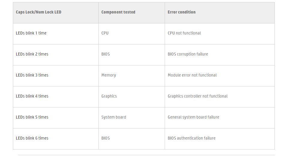

                            Bios HP 840 g1 - 6050A2560201-MB-A03
                            i found bios and schematic here
                            https://********/threads/hp-eliteboo...-mb-a03.16223/
                            i will need all files from this link thanks
                            and here another link
                            https://********/threads/hp-840-g1.14707/
                            • angel-boy
                              • Jan 2013
                              • 550
                              • Romania
                              Re: Bios and Schematic HP 840 g1 - 6050A2560201-MB-A03
                              any help ?
                              the caps and num, blinks 5 times
                              • polytek
                                • Dec 2013
                                • 496
                                • TUNISIA
                                read and post your old bios, our friend will help you to get the right bios,
                                5 blink mean general system error.
                                • angel-boy
                                  • Jan 2013
                                  • 550
                                  • Romania
                                  i dont have old bios, i try some dumps from internet. not working.
                                  if is bios error should blink other code
                                  • polytek
                                    • Dec 2013
                                    • 496
                                    • TUNISIA
                                    you have one chip on the board try to reflow it carefully.
